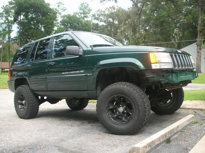

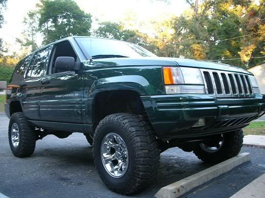

First up was a 3" pro comp lift, upgraded with 4" springs. A set of american racing pythons were put on with 31x10.50 pro-comp xterrains.
Also on the list was a K&N intake, flowmaster exhaust, high flow cat,
jet stage I chip, and some mobil 1 synthetic. Didnt notice much, if any gain, but it sure sounded awesome.
Next up was a 2.25" bb with the same 31" x-terrains. I was very happy with how much extra tire room the bb added.
I needed some more tire to fill that extra room, so then came some 32x11.50 bfg all terrains.

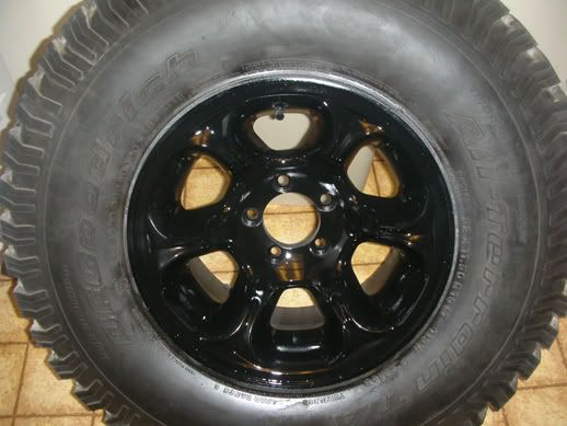

Then I got bored and painted the wheels black. Sanded them down, prepped them nicely, threw a few coats of primer, then paint, then some clear on top. Turned out great.

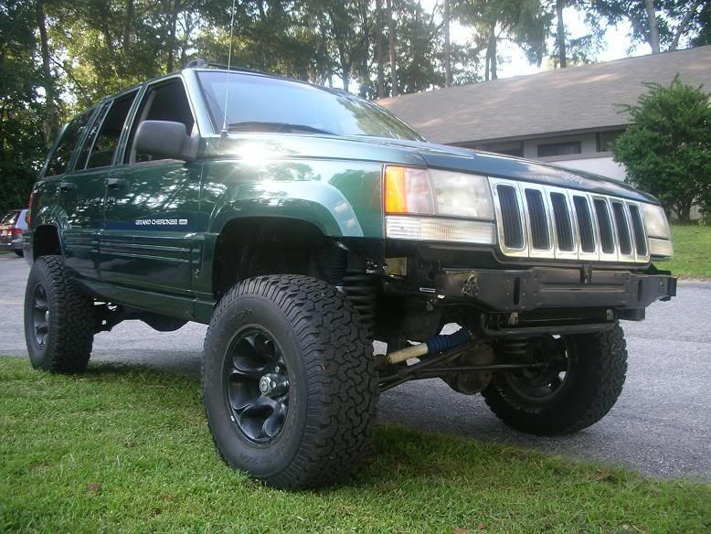

As time went by so did my need for a front bumper cover.
Bumper looked a little plain so I cleaned it up, and resprayed it black.

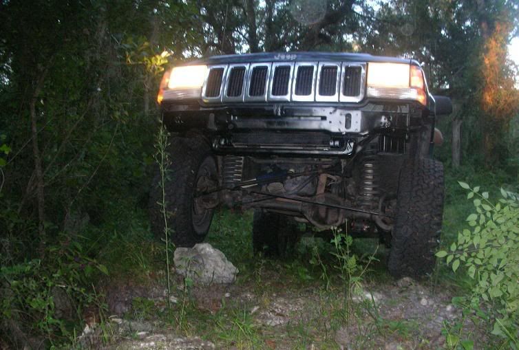

Next I took it wheeling at my buddies property to check out the 32's and ran it disco'd for the first time. I was very pleased, and loved the amount of front end clearance I had now after removing that cover. This was the last time I wheeled it, as I sold it to a buddy of mine after this....

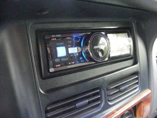

Next up was an Alpine digital media player with an 8 gig sd card, works awesome.

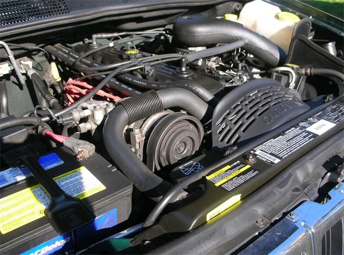

lookin good man. the rims black look way better, hell they might even look good in aluminum. just not chrome
looks like you need to fly to ohio and clean my engine bay. that thing is spotless!
The sad thing is that pic was actually before I cleaned it
Im very particular when it comes to cleaning my engine bays. When I got the jeep back from my friend a couple days ago, it had been 6 months without being cleaned, and he lived on a 3 mile long dirt road. I about died when I opened the hood.

I know there are way better products to clean your motor with compared to what I use, but my methods usually provide amazing results. I wish I could find the after picture that I took once I cleaned it after taking that one.
Products I use:
1 roll paper towels, shop towels, whatever.
spray bottle of water
any old rag, old shirt, something to wipe up the grease/dirt that wont rip or tear like a paper towel.
And the most important cleaner of all, armor all tire foam. YES. That stuff is amazing. Get the kind in the black bottle with the GOLD top on it. It breaks down whatever you spray it on, and I have found it safe to use on everything. It wont leave your plastics "white" like other cleaners do, and it leaves a great shine and the grease/dirt/nasty stuff usually just runs right off.
I usually just buy two cans of that stuff, spray one of the cans on pretty much anything that is filthy, or that you want clean. Let is sit for about 3-5, or until you see all the nasty crap start to run off. Once all the foam is gone, use the paper towels to clean up all the nasties. Once done, whatever is left will be loosened up and can be removed with the spray bottle of water and the old rag or tshirt you have. Once done with that step, spray more armor all on it and you have yourself a spotless, shiny, engine bay. Just make sure before you run your car I always let the armor all dry completely, if not your results may vary as the armor all will most likely get hot and burn off.
p.s. been doing this for about 3 years on my mustangs, jeep, my new mustang, and whatever I have owned. Never had any problems, discoloring of plastics, fires, or anything from this method.

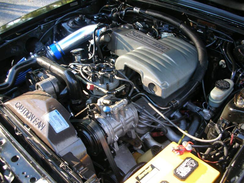

Just to show you it works, I bought this 89 mustang 5.0 lx. It was downright FILTHY under the hood. It had a really bad power steering leak so there was fluid, dirt, grease, black stuff on everything in the engine bay. There wasnt one single spot on that motor that wasnt covered in filth. I took the armor all to it with some water and rags, and this is what it ended up looking like a day later.

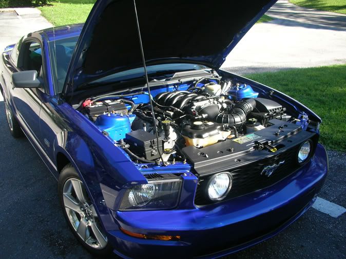

Our other mustang done the same way...

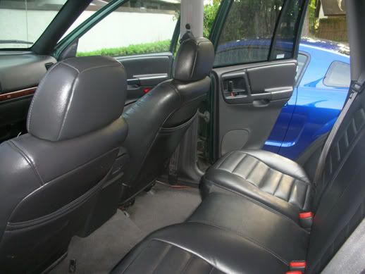

And Ihave the infinity system, nothing really left of it now, and I have the black leather interior. Not the nice limited leather, but the SE edition with the heated seats leather. Not as soft and cushion filled.
