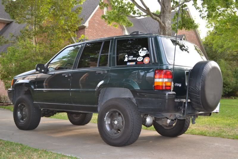

Hey guys, been around on the forum for a while but never really posted much. I feel like its time to post up my build since it's gone through some stages.
Some Before and After Stats:
Before: (bought at 66k miles, now has 157k)
1995 ZJ Laredo
2wd
4.0l
First off, let's introduce her as my brother's jeep when he was still in high school
This is the condition when I got it back.....with a BB
So i figured, let's do something. Just a couple of things here and there, right? ....wrong lol

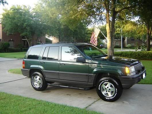

Painted Cladding
Got some 31s to replace the worn down BFGs
Painted the TJ canyons (Bad picture, I know)

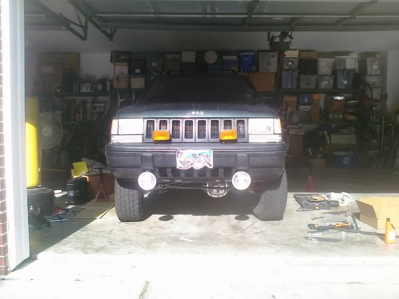

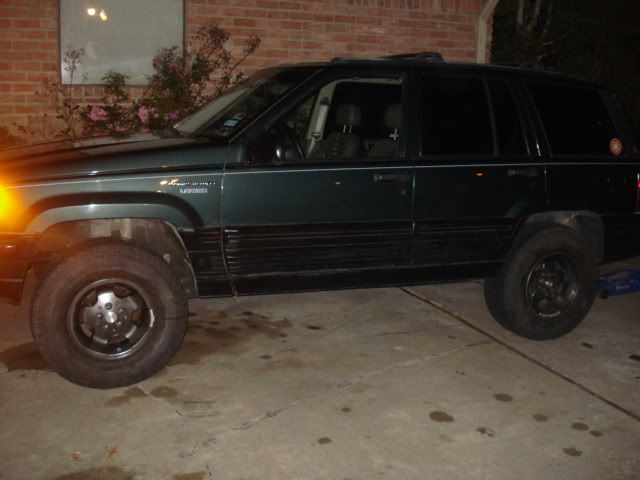

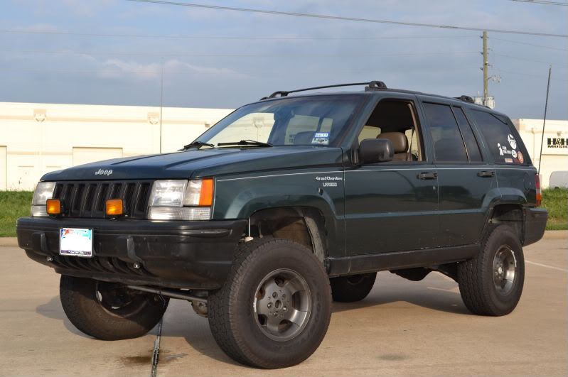

3.5" lift and pretty close to how it sits today

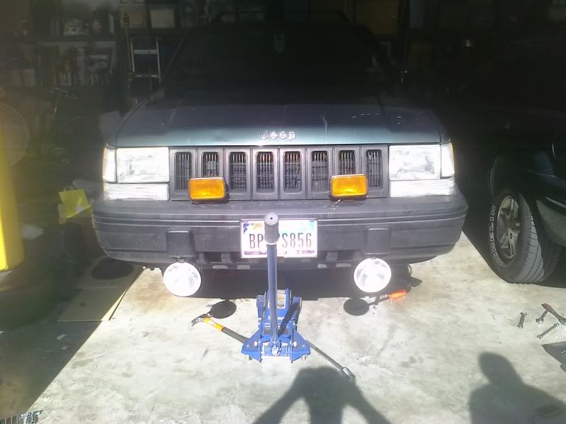

Tire Carrier and hellas, but they're now mounted on the front bumper
Some girls :beerchug:

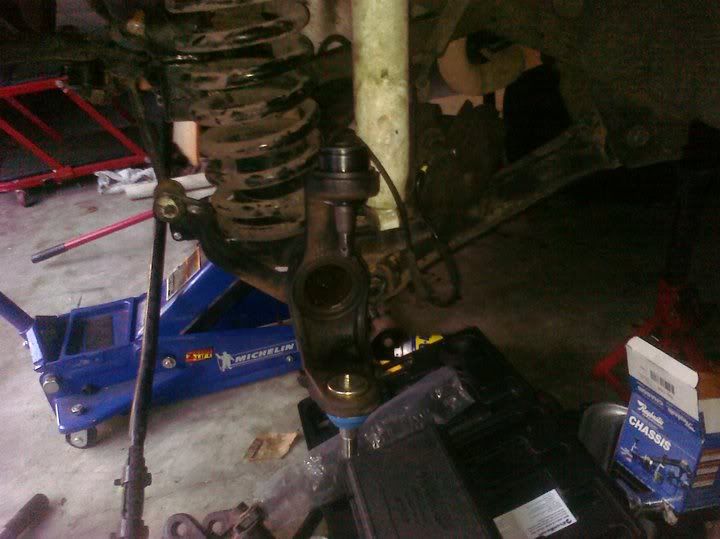

But there's one slight problem....the front wheels didn't work
Dana 30
Dana 30 cleaned up
1995 ZJ Laredo 4.0 - 5 Speed swap and 4x4 conversion, JKS KOR conversion and durometer bushings, Bilstein 5100s, fixed LCAs
DD - Stock 99 WJ 4.7 QD with flo 40

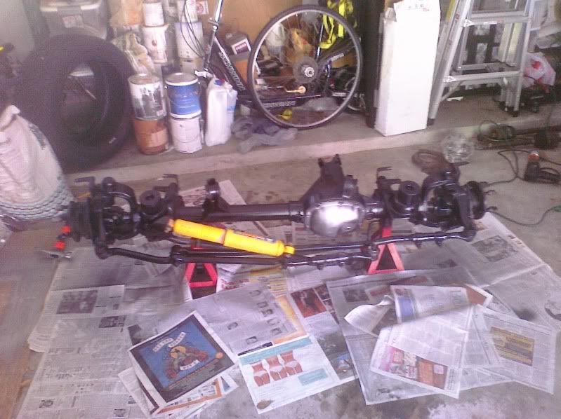

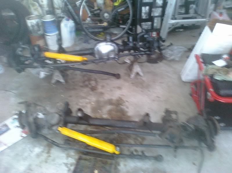

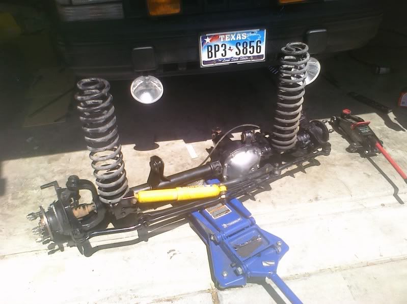

Axle out
Quick Comparison
Axle goes in
And just like Magic!

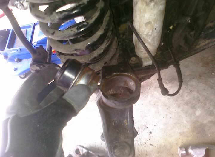

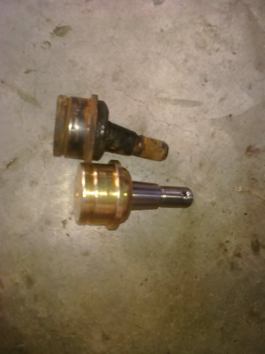

155k of miles on the joints...they're toast
Upper ball joints...yeah, those aren't suppose to separate
Lower ball joints...definitely aren't suppose to be bent
New ball joints, muuuccchh better

What ball joints did you go with?

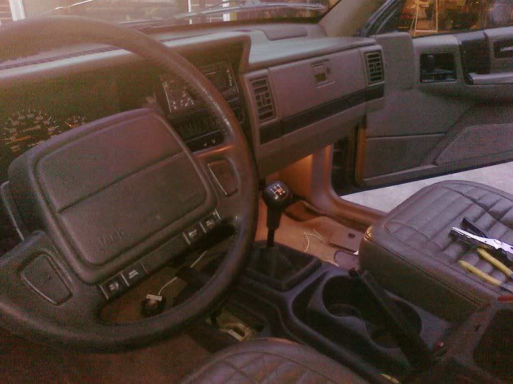

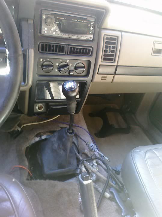

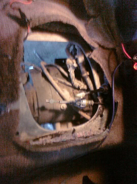

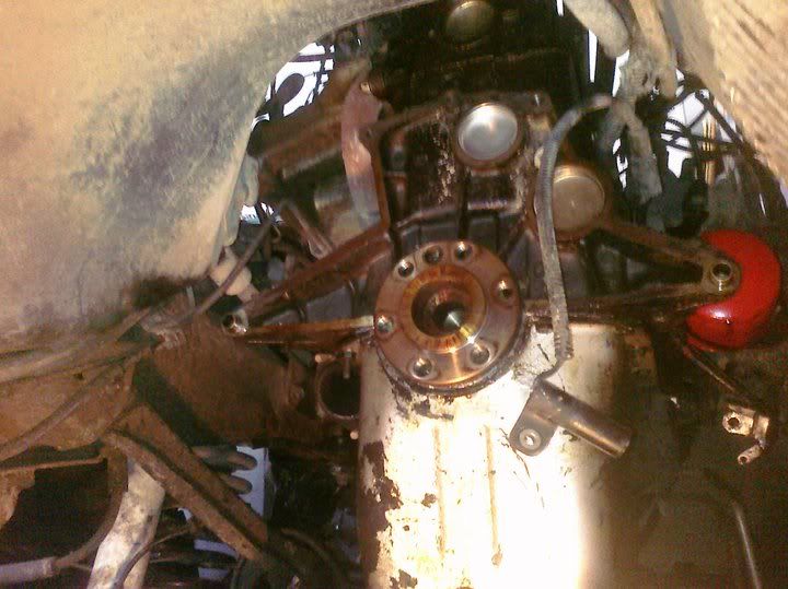

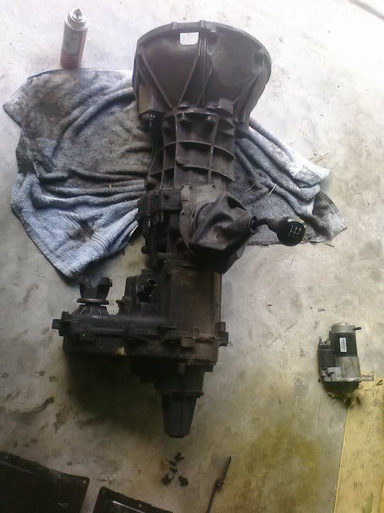

Donor 5spd ZJ with 231? I think so
I was originally planning on swapping everything onto this ZJ, but it had some rust and title issues that I didn't want to deal
Donor ax-15 and 231 t-case

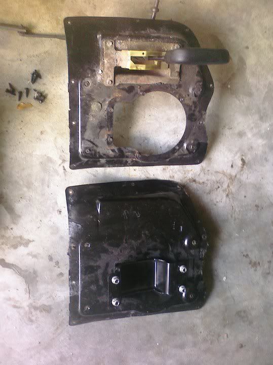

Changing of the plates from the donor to my ZJ and a top shot of transmission
Here's the plates. Top is the donor 4x4 5spd mount, the bottom is my 2wd auto
Pulled out the 42re. Back of the engine shot
Sorry for the cell phone pics. I was too excited to grab my camera. When I'm home from Baylor, I'll take some better pics
The front driveshaft isn't in because the previous owner who owned the donor short changed me on some bolts, but everything else is bolted up.

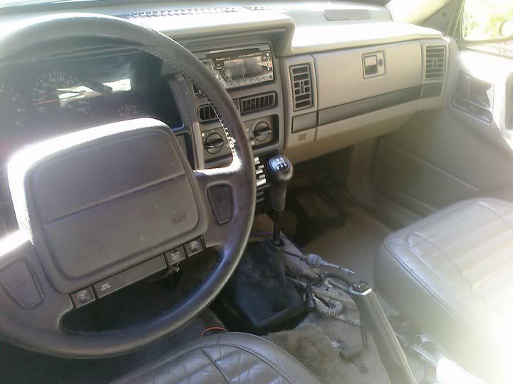

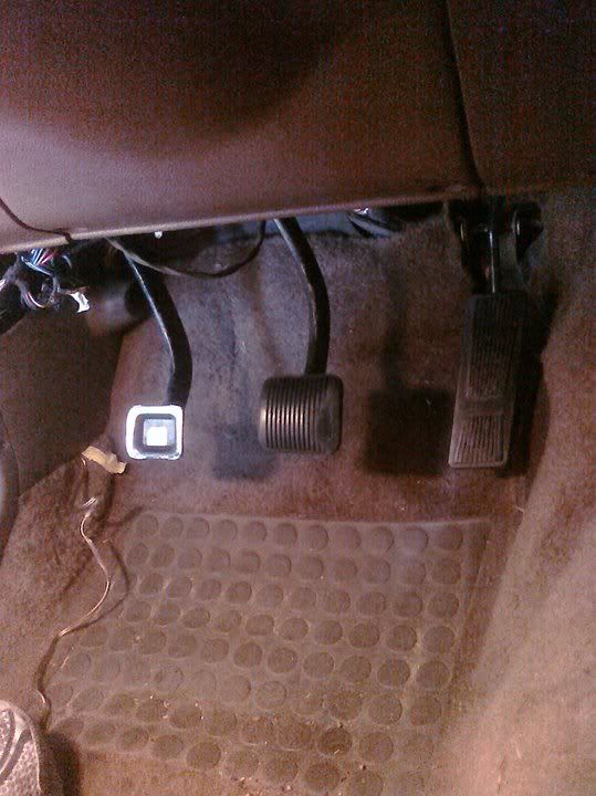

It is a lot more fun to drive with a 5th gear. 2nd and 3rd have soo much pull! Plus, my mpgs went up 5mpgs! Worth every penny

I believe they were Raybestos. I think they're great. A much better upgrade from the stock ones by far

not so keen on the hella placement. but awesome work so far. 5speeds unite!

I know, it was more of a lazy thing when I put those there. Im gonna fix that when I come home for spring break in 2 weeks. I'm gonna trim the bumper and move the lights up and take the PA out of the bumper

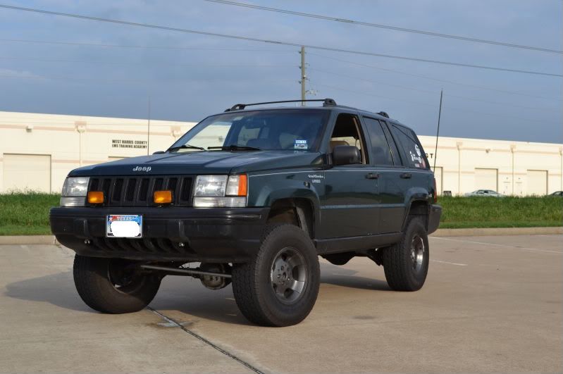

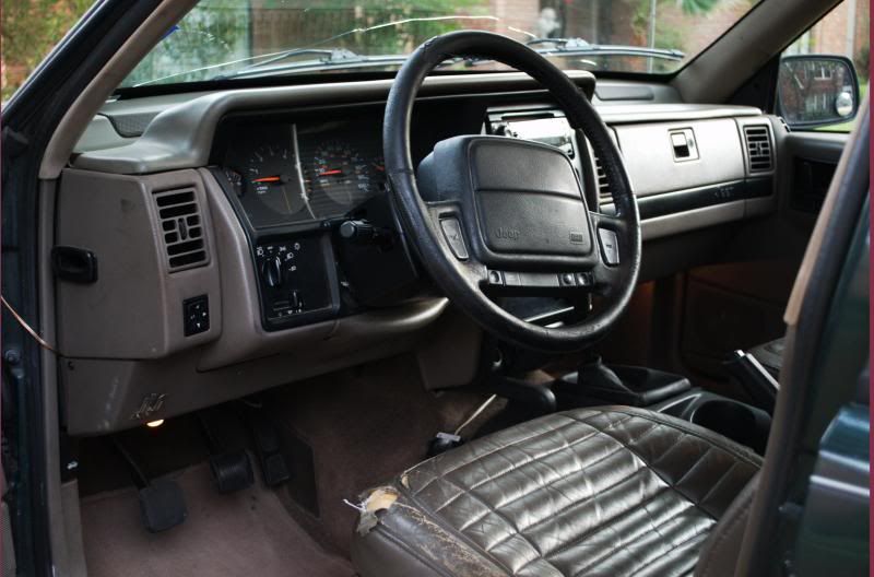

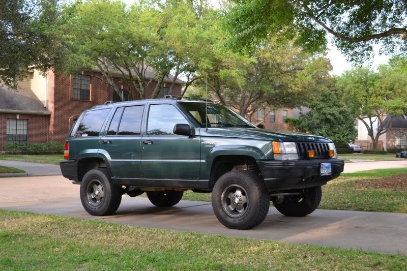

Alright, soo I was messing around with my brothers new Nikon and decided to take some better pictures of the ZJ and swap. Enjoy.
Yes...my seat has ripped..in search of the super mega comfortable seats that came on the limited models from 93-95

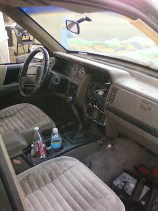

Looking very nice! I noticed you are missing your 4x4 cover on the inside too. haha I would love to do the 5spd swap like you did.

Yeah, when my friends and I were tearing apart the interior of the donor, my friend ripped it out and I yelled, "WHAT ARE YOU DOING?!!...I NEED THAT" haha
Definitely one of those 'oops' moments
It's all good, I'll go find another one from a junkyard.
