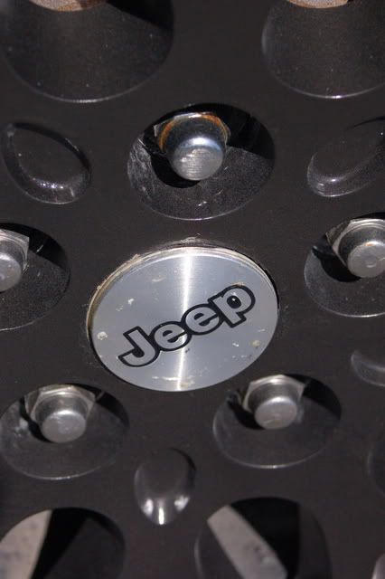

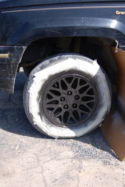

I decided to overhaul the ugly pitting bling bling limited wheels.I sprayed them with water and washed them all out with a cloth.Then, I sanded them lightly, they dont have to be perfect, they're going to be replaced eventually as well. I taped off the tire and hit them with about 3 coats of Rustoleum Light Gray Primer. After that, i shot the Hammered Black on with a nifty little plastic handle that grips on top the spray can. It was two bucks, and its fun to use if you like using a spray gun. Its very controllable as well. Thats my anyway.
After the Hammered, i gave them all a light coat of clear coat, then 3 heavy coats of it.
Im pleased with how the came out. I was going to do they straight black, but i wanted something different.
Photo time
Kept the "centercaps" original, and the lugnuts silver, and hit them all with clearcoat.
Woo! No more bling bling! Except for those old pinstripes and emblems... They may be next.

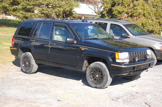

I trimmed the bumper! Im glad i did it, it makes it look more like a Jeep.

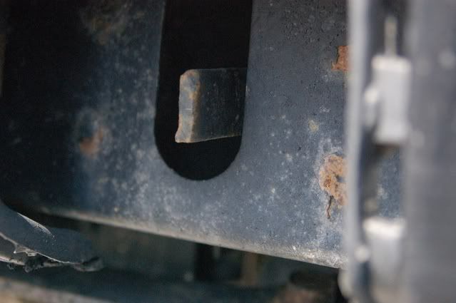

I was originally going to use my sawzall, but didnt want to risk cutting into the evap can or something else important. So my buddy chris let me borrow his dremel. I still have to touch up the rusted wear spot on the front bumper.
Afterward, i sprayed the ugly gray caps and step mat on the rear bumper.
When i Finished-
All in all, im happy with how everything came out. Man i love my ZJ

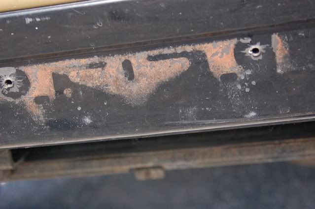

Thanks! Heres a couple pics after i touched up the bumpers and rockers, sorry for the sh**ty cell phone pics.
Shes coming along nicely! Im going to be picking up a 242 here soon, the problem is my work didnt direct deposit my check and i dont know why
It appears to em that that rusted wear spot on the front fascia could have been from a winch mount? Thats almost what these look like they were for-
