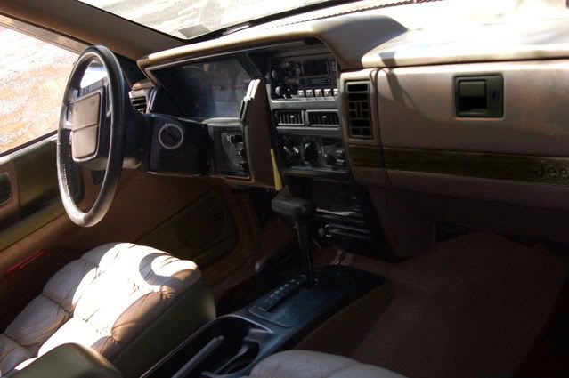

Ive been tossing around the idea for a while before i got my ZJ of doing up the interior with colors similar to the Sahara package. Im thinking of getting some paint and whatnot to do this while im waiting for my tcase swap. Let me know what you guys think.
Original Interior
Sahara Style
Not sure how i feel about it now that i see the mockup. What do you guys think?

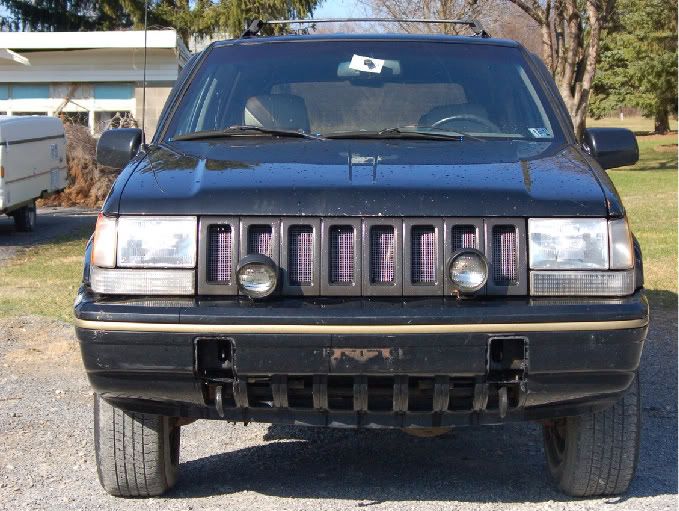

Heres what i've accomplished in the last few days. Let me know what you think!

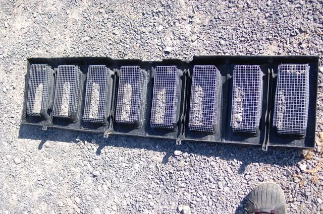

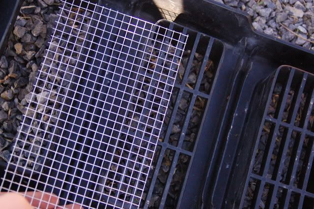

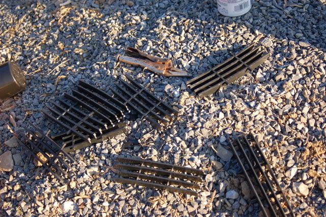

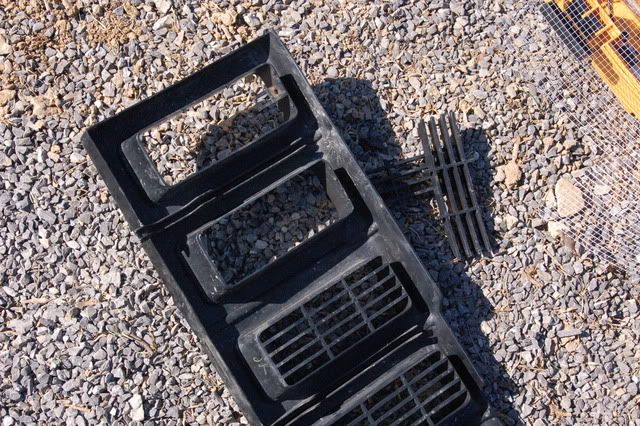

Replaced the ugly grill slats with mesh-

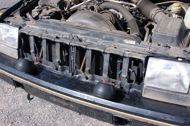

Grill Off-

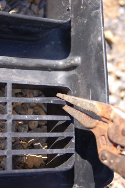

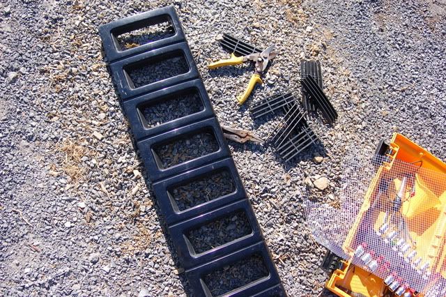

Definately the easiest way of getting the slats out, just twist and pull-
Size comparison-
Slats Out
Shapes Cut From Mesh-
Sanded Grill down and hit it with some Rustoleum Hammered Black, no pics of it painted.

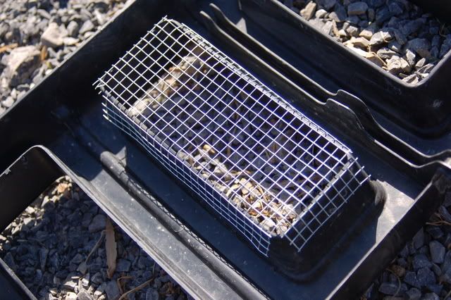

Mesh Fitted-
No pics of the fastening process. I was originally going to use the 2in1 Gel Quick set 6 min. Epoxy, but when i opened it up, the hardener was hardened in the tube. So i took it back to ace, they opened two more there, and they were all hardened. So i ended up using JB Weld. It was a little messy, but i ust took it in my room and let it cure overnight, Then installed it before school.
Voila! Mesh Grill!

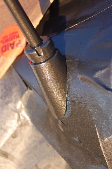

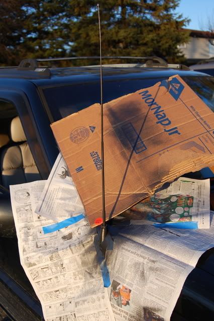

Also, since my antenna doesnt work, and im going to end up replacing it anyway with the short euro style one, I hit it with some Hammered as well.
