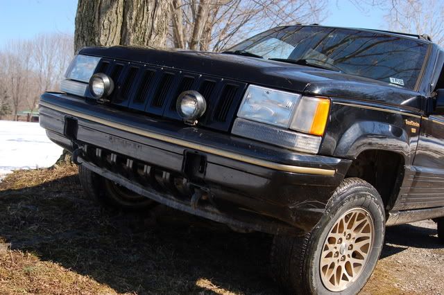

Well, after my last ZJ kicked the bucket on me, i started searching for another jeep. After searching for three months, going to look at countless jeeps that turned out to be ghetto rigged clunkers, getting scammed, i finally found a ZJ while we were out driving around searching about 4 hours away from home. I saw it sitting off at a little car lot with no plates, so we decided to stop and see.

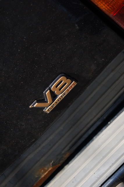

So, 1400 bucks and three hours later, we finally came home. Its a 95 Limited ZJ, Quadratrac, with a cherry bomb, a replaced 5.2, round fogs on the front.

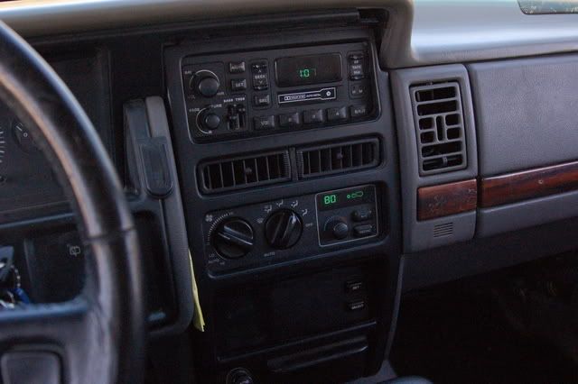

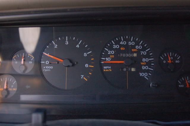

The Gas guage is temperamental The fogs dont work, the radio works pretty good though, the VIC isnt turning on, and the wipers only work on Low and High.

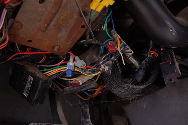

Theres a rats nest of wiring, we tucked it up out of the way for now. It looks like someone tried to put a remote starter in, but we got no remotes with it.

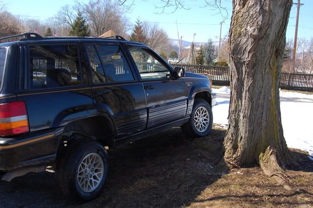

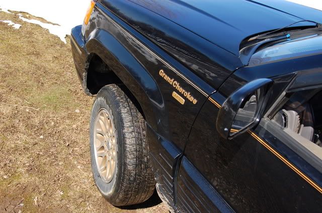

Anyway, Photo op, i got stuck in someones ruts in ice and mud with the bald A/Ts :

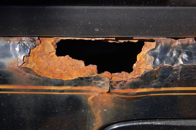

Rear Gate is rusted through, i ran aluminum tape in layers across it, and resprayed the gate black for now. Ill have to get a new gate at the junk yard. Tires are my priority though.

Any clues to what any of those unplugged wires are? haha...
