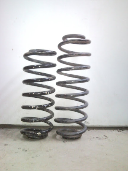

5.5" IRO Springs

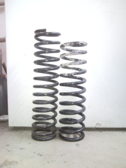

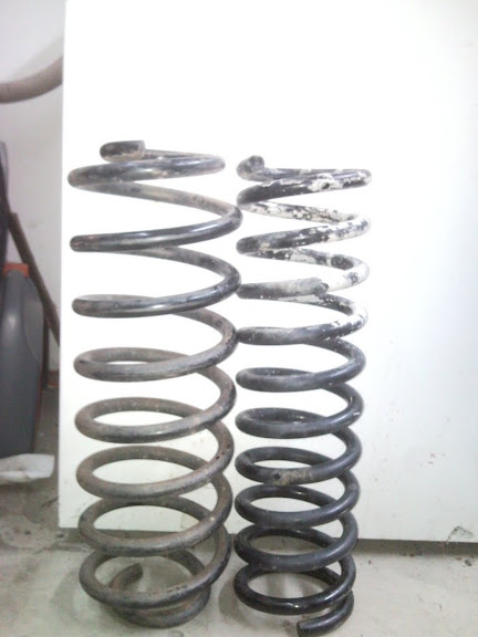

I've rocked a Zone 4" lift since Feb of '09. It was a good lift, but I've out grown it. So now I'm working on putting together a bigger, better lift. I bought 5.5" IRO springs from a friend (Volcom02WJ) and am currently working on piecing together a long arm kit
Here are the new IRO springs in comparison to the Zone springs
Front to Front:
Rear to Rear:
Just for fun... New rear IRO spring compared to the old front Zone spring:

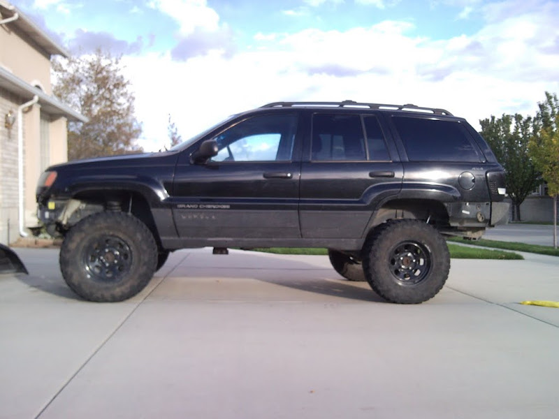

Here is a before & after... She feels like she sits a little higher, but that's probably just a placebo effect, because she doesn't look much taller. Oh well!
Before
After - looks like her butt sits a little higher

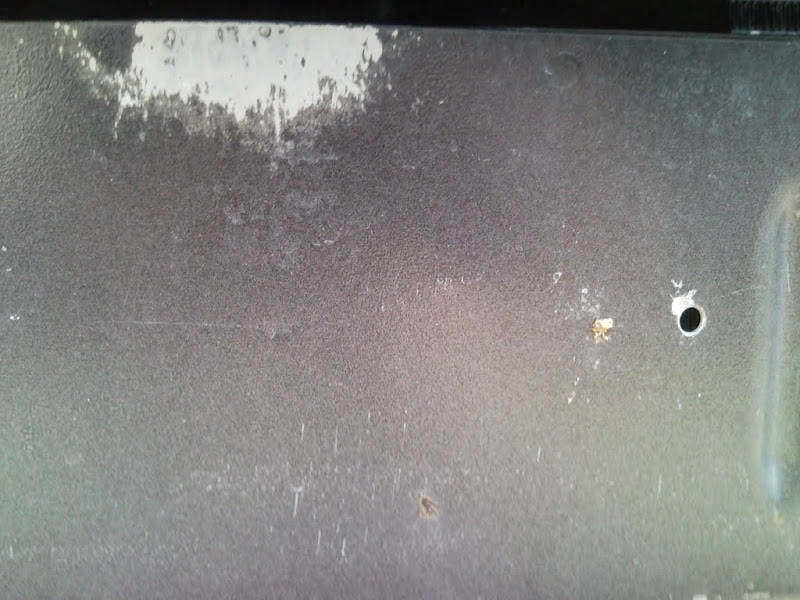

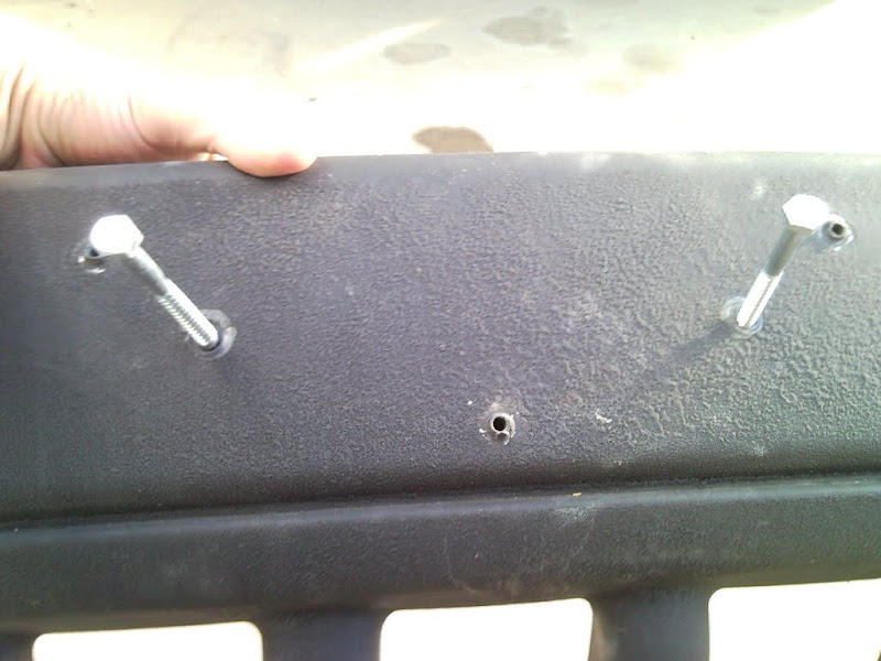

Upon setting up Katie's new front bumper, I modified it so that it would only take two bolts to remove. Granted, the license plate & bracket tripled the amount of effort it takes to remove it, it still comes off fairly quick! Haha
Here's what I did. I took off the license plate & bracket, drilled two holes through the bumper into the frame then added the lag bolts (I should use washers, but I always forget to put them on). That simple. The bumper is held in place (other than by the lag bolts) by one button underneath the bumper & the clips located underneath the headlights do the rest of the work. Put the license plate back on and
Holes in frame (okay, one hole... my screen on my phone/Only camera is broke, so I guessed when I took the pic!! Haha)
Lag bolts in bumper

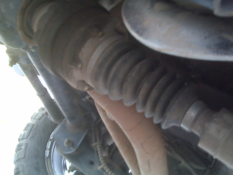

The Front DS on early model dubs uses a CV type configuration on both the diff & TC side, which is intolerant of a lift of 4".
These pics, borrowed from 00JGC00, show the CV joints at both the diff & TC
I started out by replacing the CV type on TC side to a double cardon, modified by 6 States. According to them & Teraflex, I was okay keeping the CV type left on the diff side, with a 4" lift... Until the boot broke. This is the modified stock DS. This mod was a mere $265

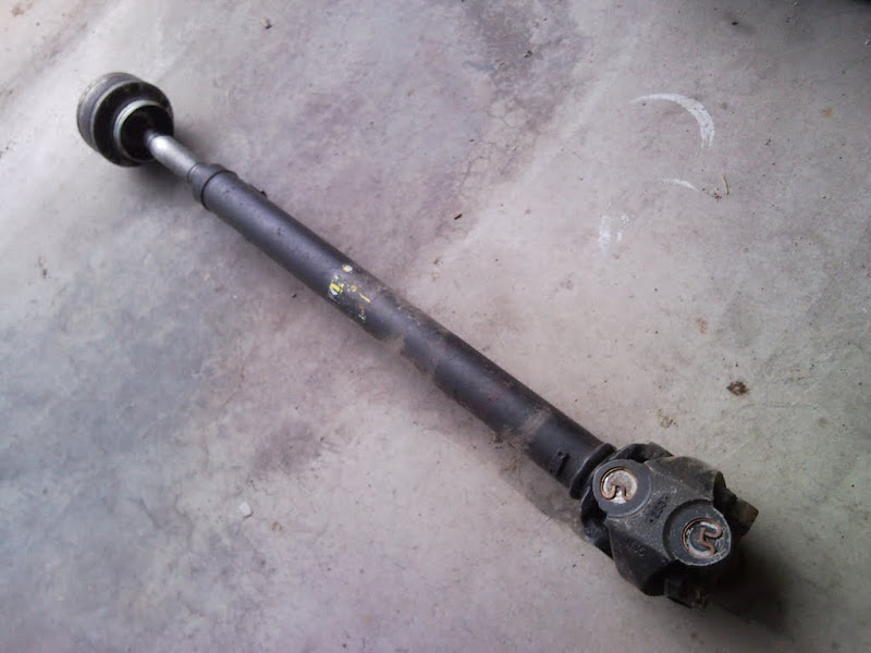

Since the boot broke & no one, not even the stealership, had a replacement boot (unless I wanted to buy a brand new fracking DS), I would have to get creative. Okay, not really... haha. Instead of buying a really expensive aftermarket DS, I researched and found that the U-joint type offered on later dubs was actually quite suitable for lifted dubs aaaannnd was a fraction of the cost. So I bought a D30 yoke w/ straps from a wrecked TJ & used the yoke from my converted DS on the TC & then bought a U-joint style DS from a wrecked 2002 Limited WJ. $107 later I have a working front end again that is completely lift friendly
Here is the working DS & joints to compare to the old ones
