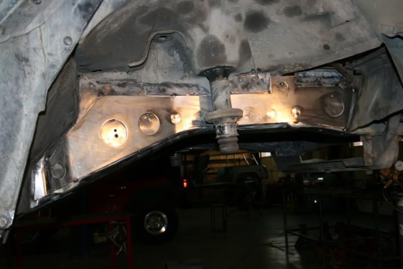

Picture time! Lots of welding over the past 2 days, finished off a spool of .025 wire, threw in my .035 and layed down some deep penetrating beads. MAN OH MAN! This little welder has got some serious umph. I was able to burn DEEP into the 3/8" brackets for the lower control arms, it was nice.
Anyways, here's the first pic. The newly narrowed lower control arm mounts, drivers side has 1 on the cast.
Here you can see a little cast welding on the back side of the truss and the lower control arm mount. I made a gusset out of 3/8" to brace from the lower control arm mount up to the truss, no pic of that though!
A weld I layed down with the .025 before I ran out, much easier to control the look of this wire even though the penetration is guaranteed with the .035
Front pic with all the welding done. All the truss welding, the tubes are welded, and I was able to weld the truss like 6"+ up each side of the cast
Rear shot, showing the inboarded and slightly angled lower control arm mounts. They fit MUCH nicer now!
So! I put the axle back in place! The axle is in ride height in relation to the truck, and only sitting 1 or 2" higher off the ground than it will, so this is damn close to what it will look like!
I did a lot of looking and tinkering with Andy's old RE track bars, I'm looking at shortening and using his old front one. The rear is in the pics. I also need to rebuild the frame side track bar bracket now that everything is repositioned, it's a little too close to the upper control arm mount for comfort.
In this pic you can see that the axle coil buckets are too far forward. They are going to get cut off, slid back and rewelded.
