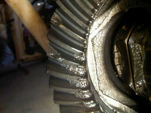

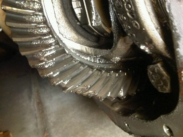

Sooo.. I had my dad go snap a few pics.. It's not as bad as I thOught. I must have exaggerated it in my mind do to being pissed lol
Also I told my dad to take a pic of those metal shards and he told me they were just pieces of the black sealant front the diff cover lol so NO metal was in my diff, yet I probably have 8-12 broken teeth.. Odd? I say yea..

After all that the jeep has been great until the lockrite started acting up. I thought it was normal sounding at first (sounded like an Aussie in a Dana 44a) but it only made the loud clang noise when under power turning left. I decided the locker was toast and ordered a Spartan to get me buy whil I decide what I'm Gunna do for axles soon (37's are a little big lol) I pulled off the diff and noticed the ring gear was shot!! And not a single piece of metal and clean oil. Leading me to believe the PO was hiding it and knew.. Prick..

Do u think the ring gear could cause a lockrite to give out?

Posts: 3,874
I wouldn't think that a bad ring gear would make the lock right go bad. I would check the clearances and springs on it before I would place the blame on the ring gear.

Posts: 7,476
Thats what I was thinking. I'm just going to replace it. Then maybe I can buy new springs for the lockrite and see if anyone wants it for cheap.. As long as the teeth are good.
