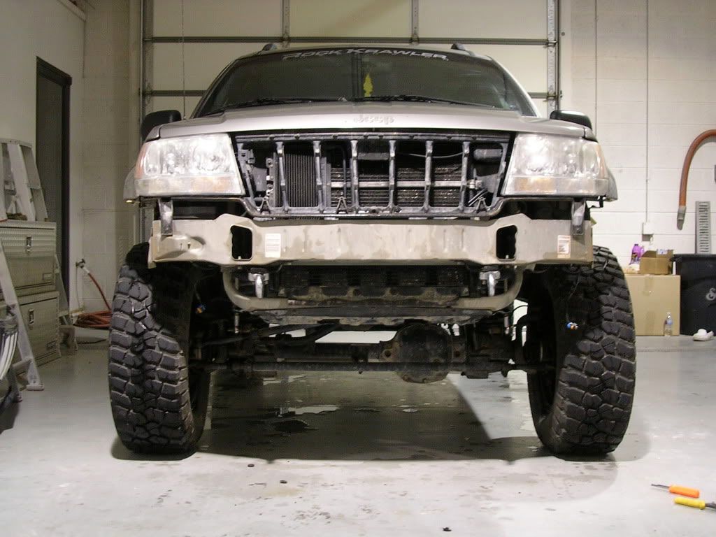

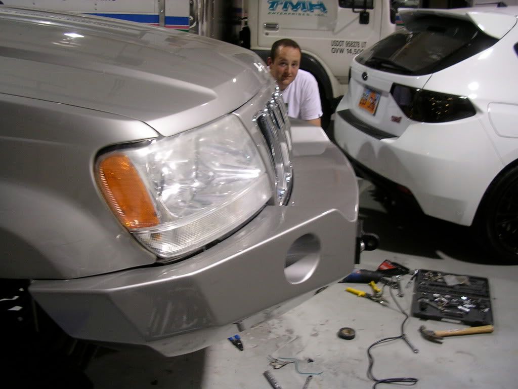

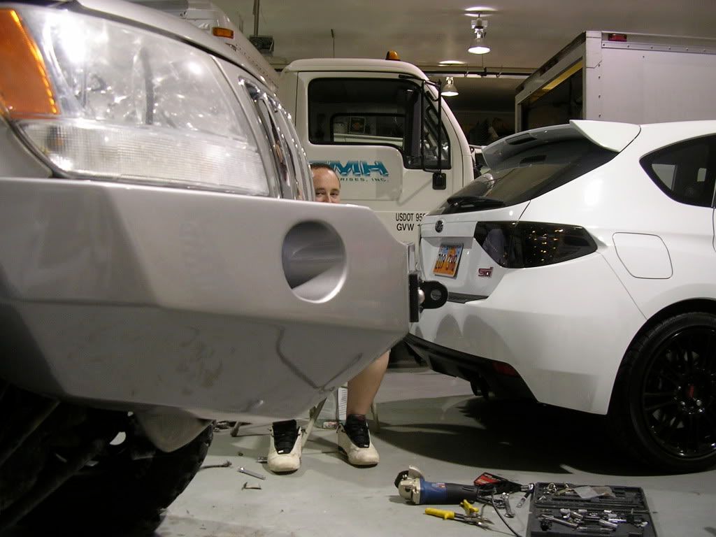

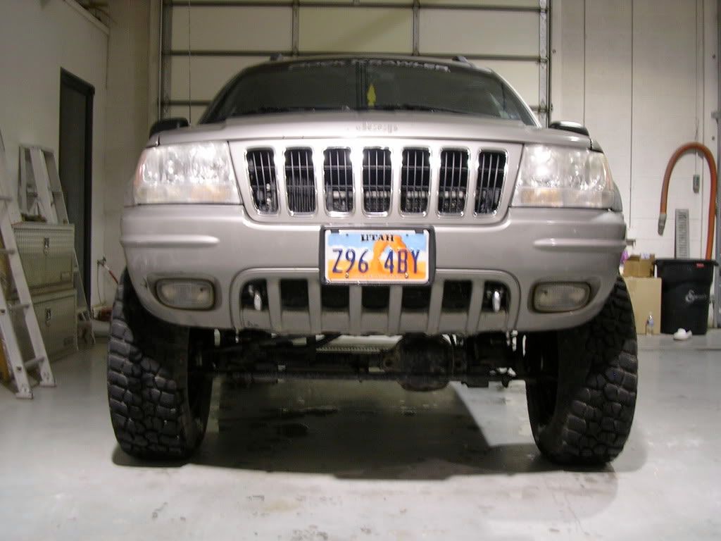

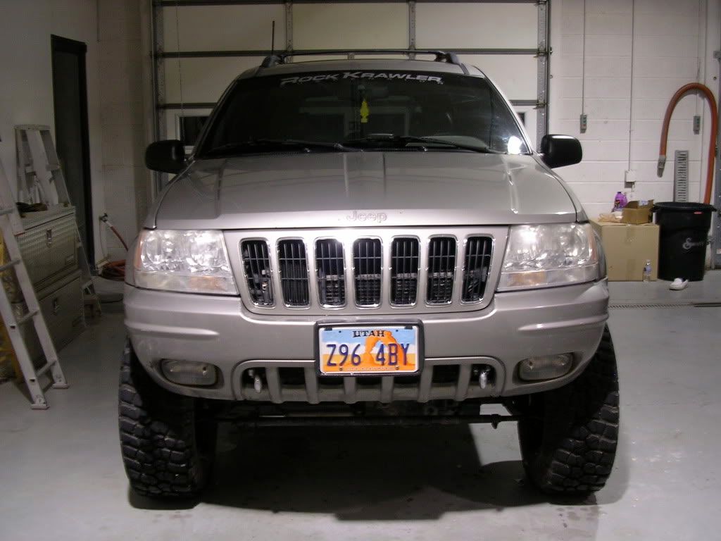

TIME TO UNVEIL THE ICELAND BUMPER ON MY WJ!!!!
I took some pics during the process to show ya'll the install...
Before & After

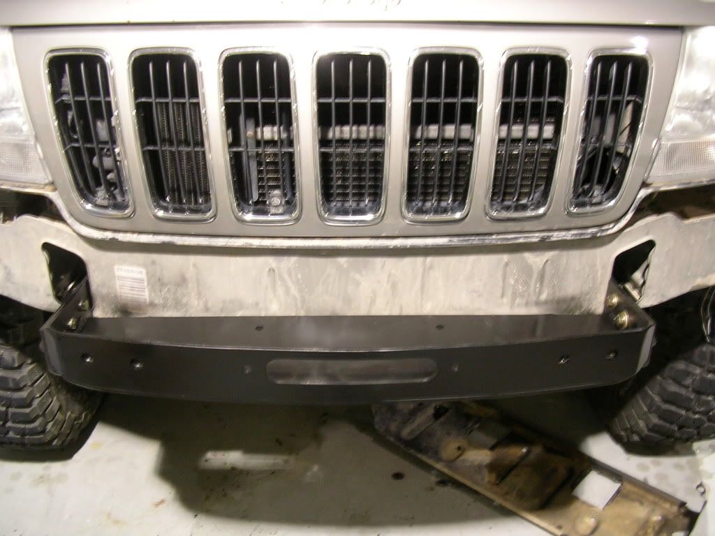

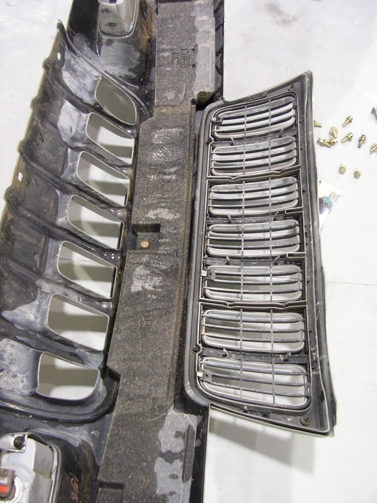

now I started off by taking off the stock bumper... which on the pre-04 models, the grill and bumper are the same piece...
you just need to grind down the lip between the bumper and grill and they come apart nicely..
grill back on

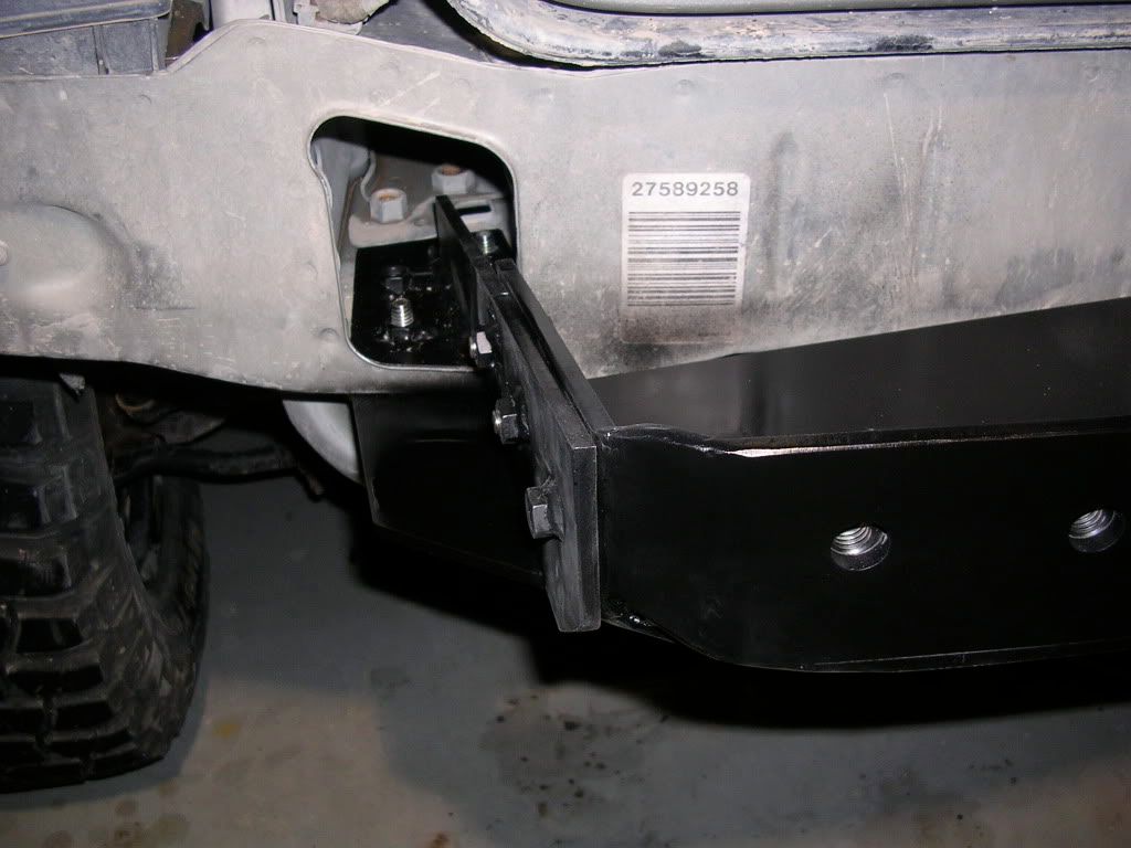

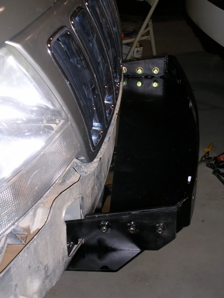

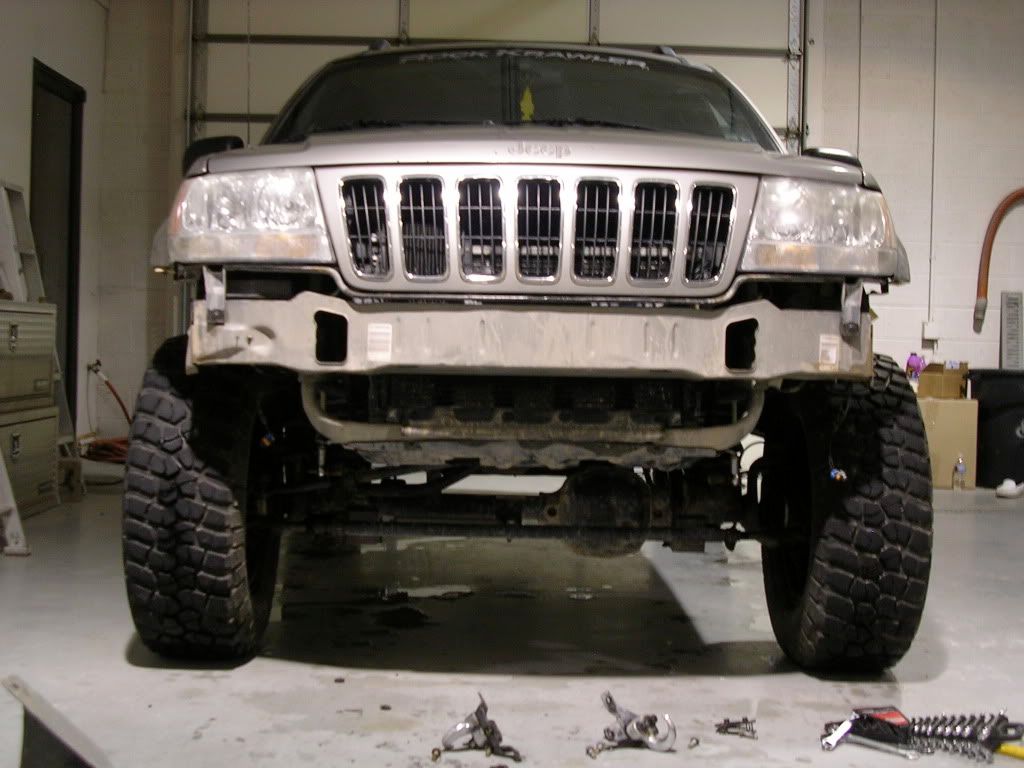

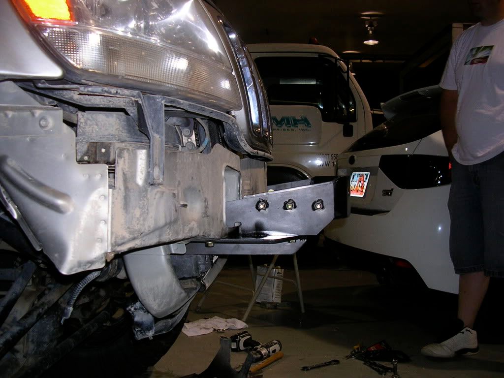

then i started bolting in the bracket. Here it is installed..
It is about 11 bolts on both sides... very tough bracket... It bolts all the way back and between the sway bar and "frame." It then sandwiches the frame with the two brackets and then the Cradle for the winch bolts to them...
then you actually have to grind down the corners of the metal behind the bumper so it will fit on.. it barely fits over the front of the vehicle

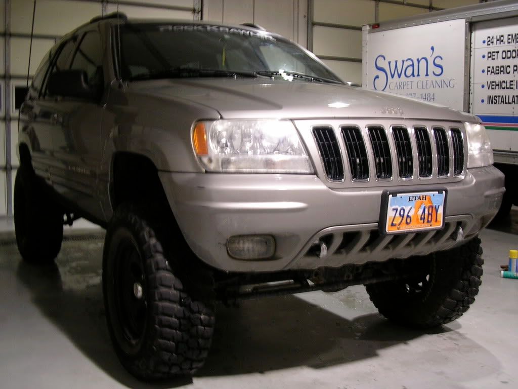

and here are the rest of the before and afters!
hopefully some better daytime pics will be taken tomorrow!!!!

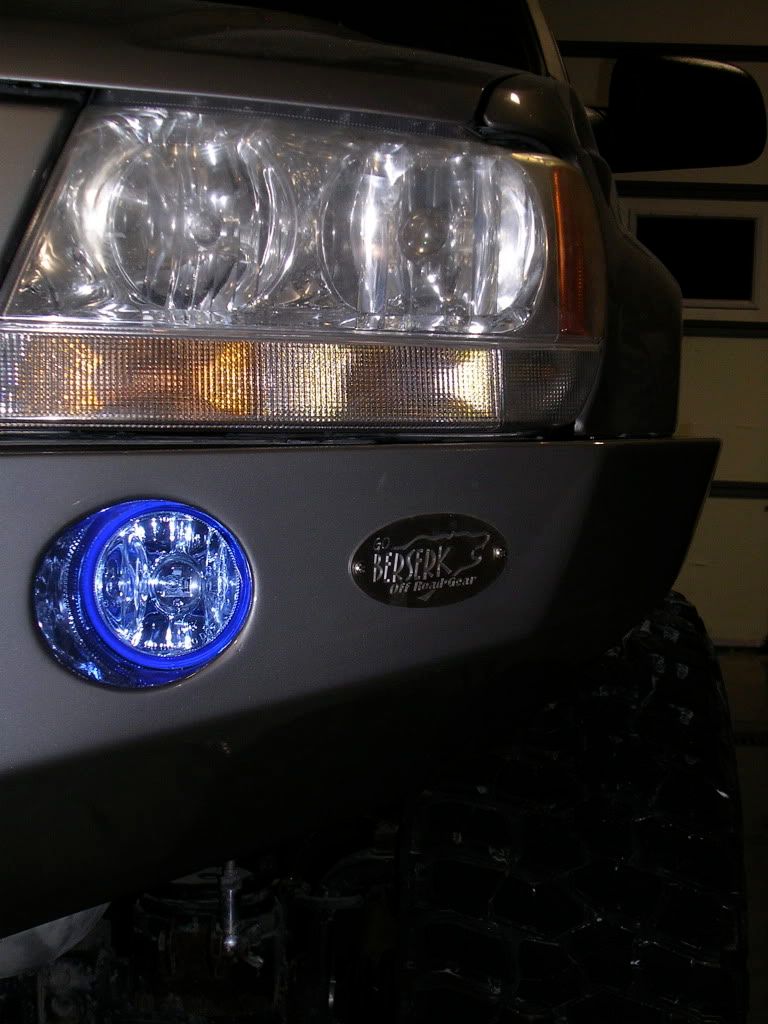

dude... that thing looks sweet as hell! how thick is the fiberglass tho? id be worried about punching a hole in it depending on how thick it is
Duff.
(broken)98 ZJ 5.9
UT Jeepcrew #13
NIGHTCREW
corndogduff is offline
post #194 of 624 Old 06-02-2009, 03:55 AM
Shinobi
Location: Reno, Nv
Posts: 1,170
question tho how does the fiber glass mount to the mount ?? through the dring mounts ?
Shinobi is offline
post #195 of 624 Old 06-02-2009, 03:58 AM Thread Starter
311LJ
311Popo
311LJ's Avatar
Location: Springville
Posts: 7,476
well you see the black brackets on the front? they have two bolts each that bolt to the front of the bracket.. then you screw the sides into the fenders..
the fiberglass is AT LEAST 1/4" thick.. its solid!
