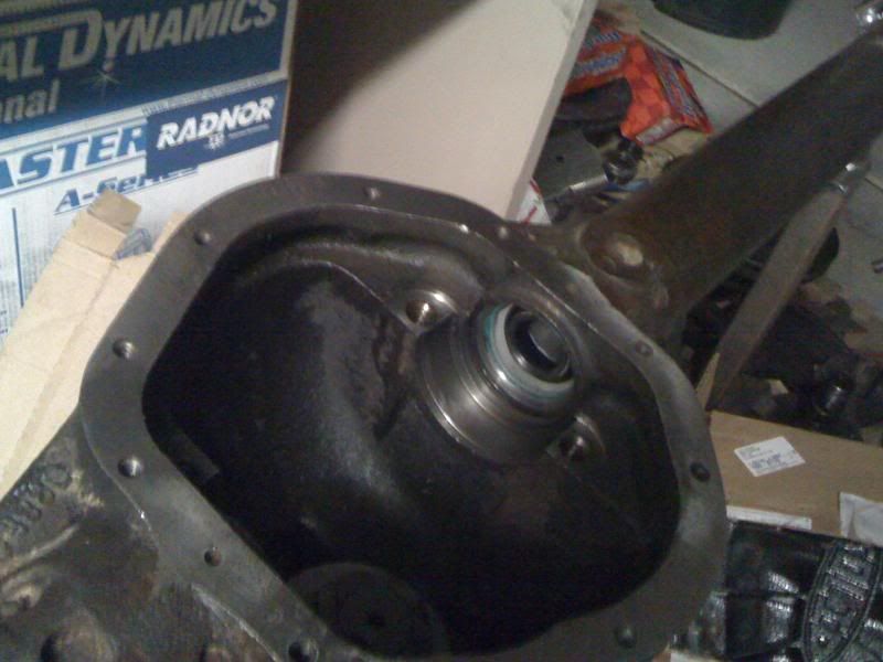

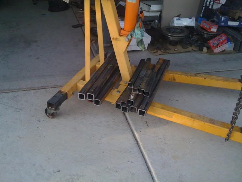

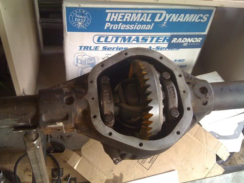

got everything ripped out from under blue and sold. Both axles are gone as well as all of the suspension. I traded someone my 4.5 RE springs for some 7" claytons and im building my own long arms. They are going to be basically like claytons arms just home-made. well to make this less boring, here are some pics....
axles are a hp d44 front and full floating d60 rear. both have 3" OD tubes
