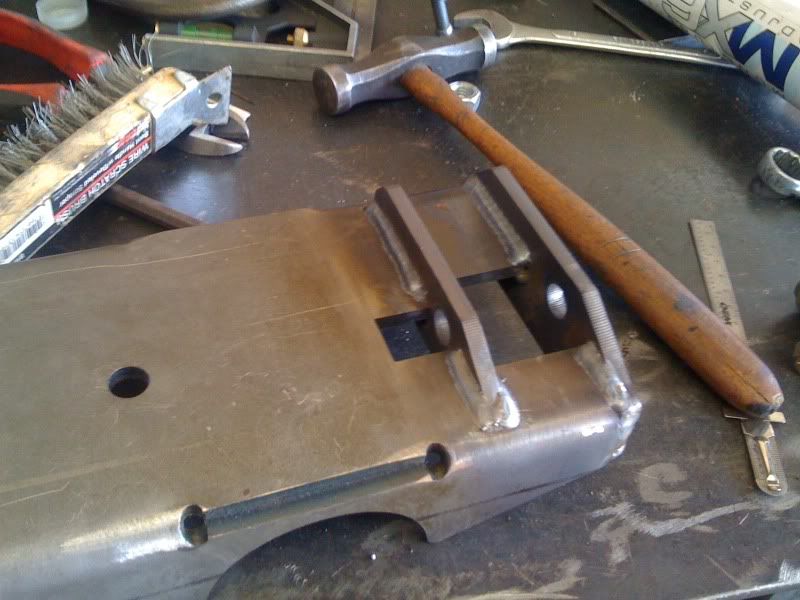

today we welded up everything on the axle and started to paint it. We need to get some cast rod to weld a few more spots so i couldnt paint it all up. also added another small gusset to the truss and pressed in the upper CA bushings.

we used cast rod. Just left it out in the sun for a bit and peened the snot out of it during cooling to relieve stress. havent seen a crack yet and now its painted so if it does happen, it should be noticeable. I think it will b fine though especially considering it is welded to the tube on the other side and there is another good bead to the coil bracket.
