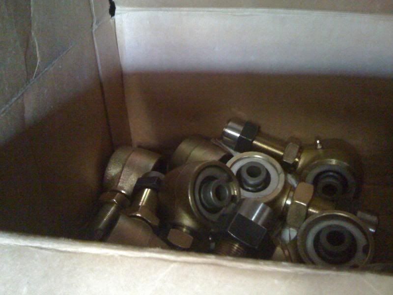

They are basically going to be claytons. Me and a buddy Went in halfs on the bracketry for the claytons so one of us will get the claytons brackets and we are going to make another set based off of them. The are will b the same material of claytons (2" OD .250 wall sq tube for lowers and the uppers are a tad smaller, can't remember right now) and I'm still using Johnny joints at one end and bushings at the other. It should start coming together shortly now that iv got mostly all the parts. I spent close to 4k

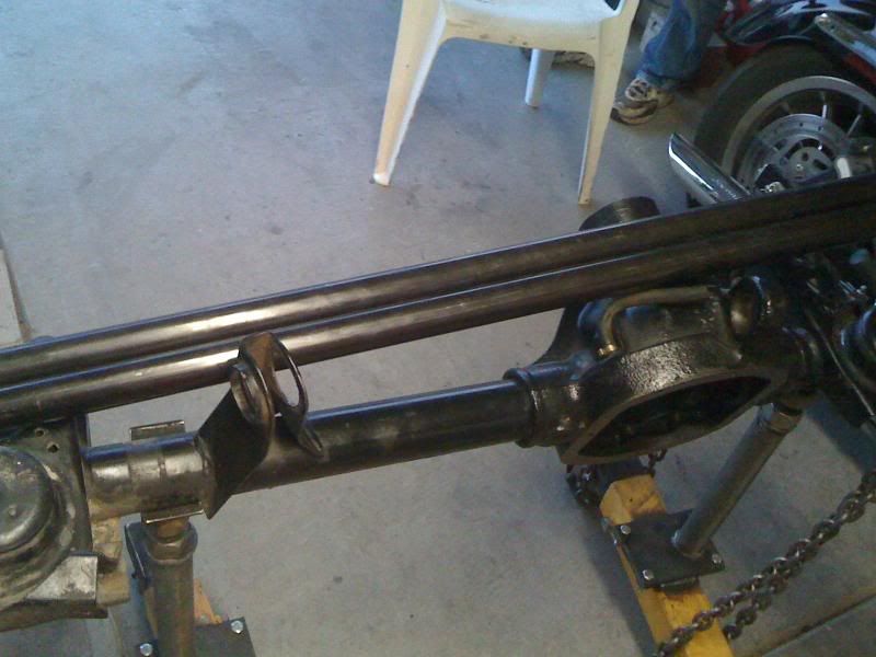

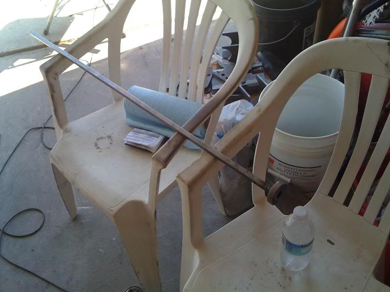

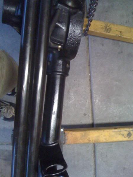

This is the steel being used for my steering. Its 1.5" OD .250 wall DOM tubing. This is just a pic to show the beef. Thats a HP d30. lol Ill be using 1ton TREs instead of heim joints.

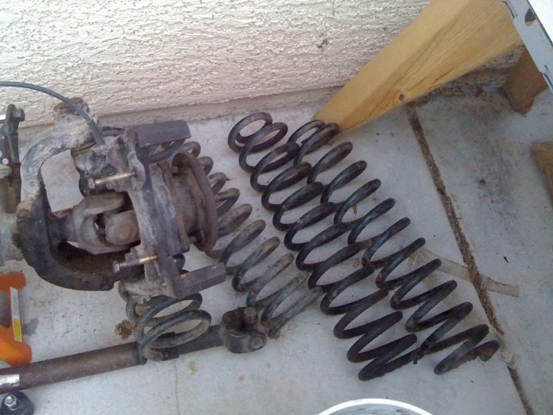

7" clayton springs

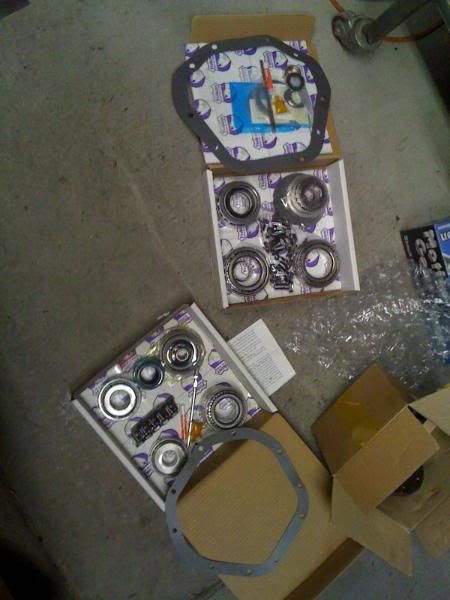

and master install kits. going to attempt the re-gear myself. I cant bring myself to spend the money to pay someone. lol

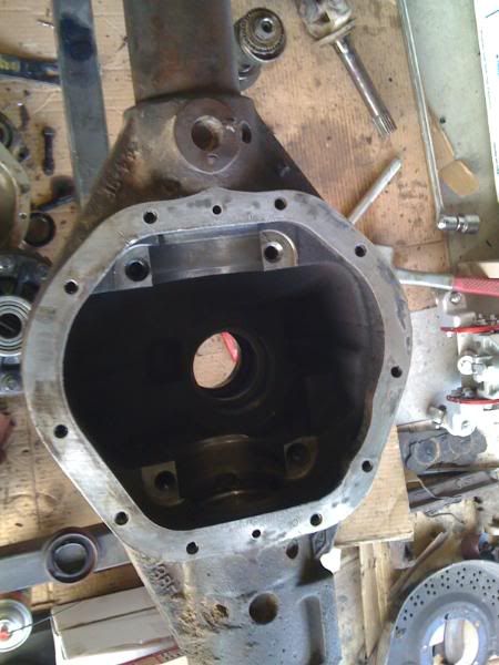

axle gutted and cleaned ready for new gears

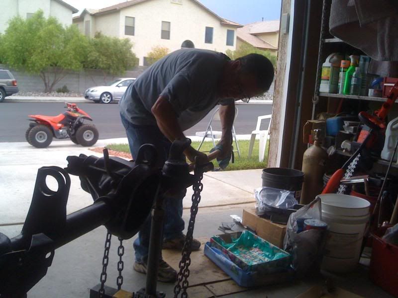

i used a shovel to get the axle tube seals out. this is my buddy using it to get his out. it works realy well then we just welded a washer that was sanded to fit snug in my axle tube to clean out the gunk in there

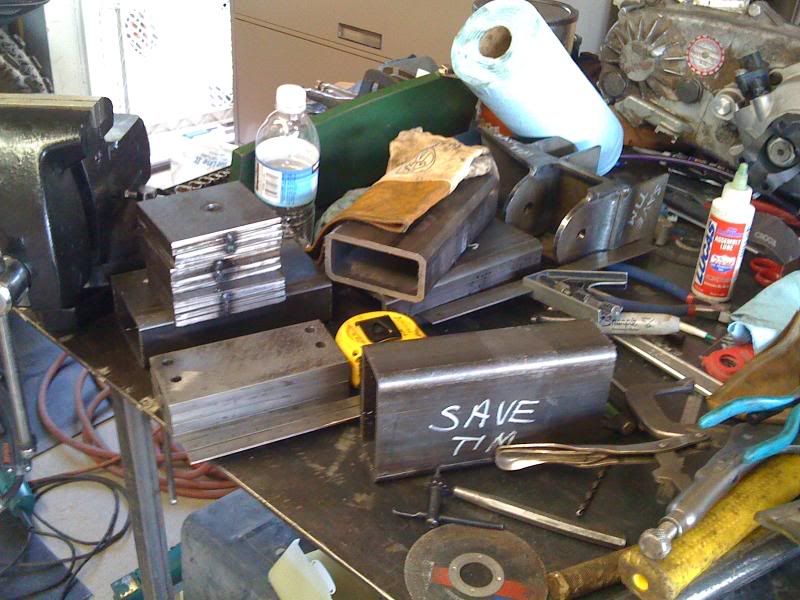

the beginning of the crossmember and the rest of it that needs to come together. they should be done this week. not bad for torching that oval out. haha

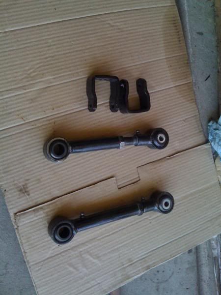

i also got my quick discos off for the first time in FOREVER. these things were like ancient. the hardware would not budge especially since they were hex heads. i just cut them off and will get new hardware. We ended up having to weld a nut to it to get it off. with new bushings and a paint job...
long arms anyone???

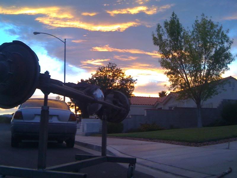

trying to be like moony. hahaha and it shows my axle stand
