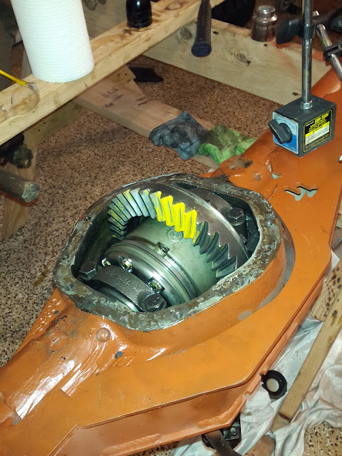

Stopped for the night.
Heres where I'm at. Still have some work, the coast is a little to the heel still and the edge is still too sharp. Backlash is 5 thousandths. Going to pull the pinion out a little more in the morning and see what that gives me. I think its too deep.
