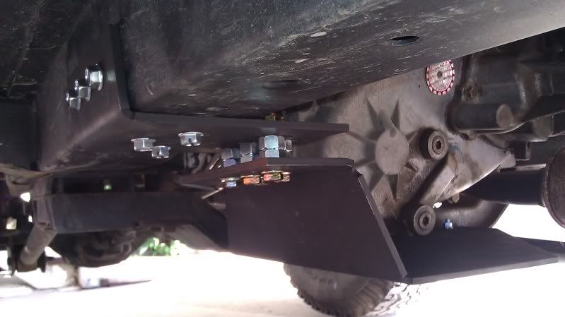

Mine took me about an hour to install, but that is because I also did some welding. I did paint it the day before as well.
There are two bolts that tie it to the factory crossmember, then I ran to the store to buy some large nuts to use as spacers (My lift kit lowered the crossmember like a T-case drop). Then I used a drill to screw the self tapping bolts into the unibody, then I also tack welded the unibody side mount in place as well.
This is right before I tack welded it.

Will, your skid is the none claytons one. He also makes one for the claytons suspension.

Makes sense. I am glad the standard one worked with my RK kit.
