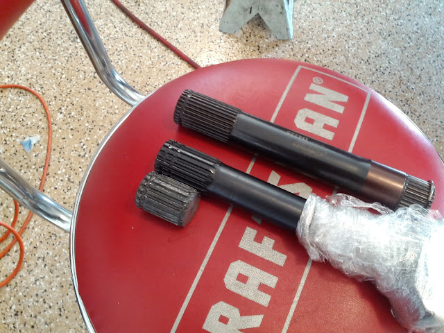

My RCVs came in as did my spare 19 spline 4340 stubs to run as backups.
Ive delayed install of the RCVs as the spindles I'm using need to be machined to open up the ID a little so the larger shafts can be used. I decided to order new spindles and have those machined instead of putting money into the old spindles.
In the mean time, I put the spares (4340 stubs/factory 44 inners/spicer joints)in to run until I get around to getting all that done.
Here are some pics of the shafts:
You can see the stock stub broke where they neck down after the splines. From left to right: stock stub, chromo stub, RCV.
You can see how the RCVs don't neck down at all, plus they are a little larger diameter shaft.
