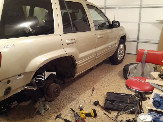

More work on the rear:
Not much for body work, lines aren't perfect and I still have to patch some inner fender in the back, I cut past the joint to open it up more:
Suppose it lost its show car potential when I started cutting

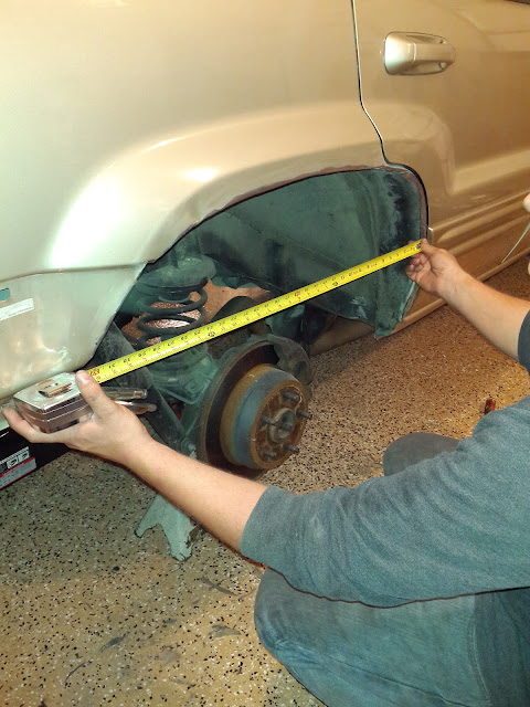

I'm pleased with the trim, opened up 5" where you need it. Untrimmed is 27" @ the top of the side molding:
Trimmed is 32":
Should help.. Rough hack math but that measuring point is 8" from the top of the fender. 8" down on my MTRs measures just over 30" should be enough to let me set the bumpstops to stuff the tires most of the way.
All rough estimates of course.
