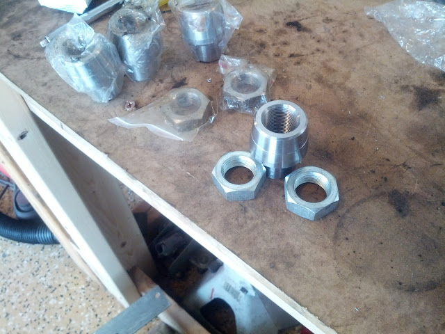

Starting the steering:

Tie rod in:

I don't feel its necessary and the couple inches doesn't justify the asspain. There are things hanging lower than the tie rod.
Its more than just flipping it, the clearance with the high steer arm is an issue. I think your fab guy ran into that too didn't he? You can space it but i dont feel like building spacers and its more work than its worth IMHO.
I would have run the tie rod up and the high steer arms instead but I don't think its going to clear the suspension.
