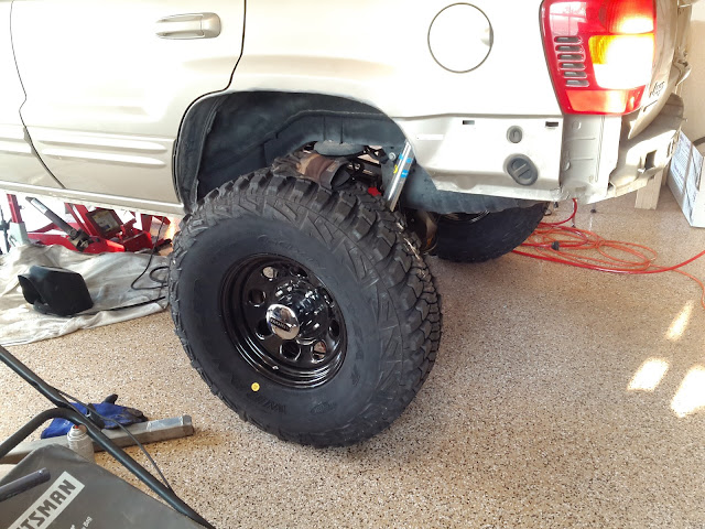

Got the other hub/etc done on the rear axle, tire is on until my new pads/tcase get here. All thats left on the rear is brakes and pinion angle.

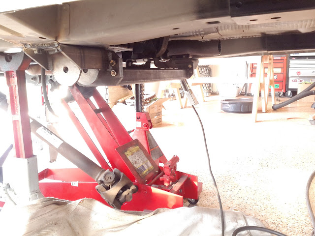

Finished burning the mounts on, cleaned up the welds, sprayed on some primer/paint, and dropped the transmission back onto the crossmember.

Modding the Clayton brackets are going to be more work than I initially thought. The differential is going to be in the way so I've gotta do some cutting on it and clearance the driver side bracket quite a bit. Took a break tonight to think about how I'm going to do it.
Hoping to successfully re-attack in the morning

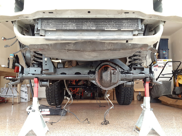

Haha, didn't last long.. Still have work, removing old brackets from the frame, get the axle completely centered, etc, but its on the suspension..
Long day, this fought a lot more than the rear. Lessons learned:
I don't think I'd mix and match brackets were I to do it over. I'd probably ditch the truss, it was a lot of work for what probably is very little gain, considering the beef of the 3" tubes already.
If you're doing Claytons brackets on a Ford HP 44 be ready for the driver side LCA mount to need reworked, to put it where it needs to go it has to be modified as the diff is in the way a little. No biggie, but something to think about.
If you're using Clayton brackets and a JKS track bar, you'll have to cut it down almost 3-4 inches or rework the frame bracket, your choice.
I'll think of more.

Originally Posted by adavis39 View Post
just curious as to the decision to mount the front lower control arms brackets so low on the axle rather than up out of the way......clearance issue? looks friggin great though man!!
Clearance issues with the differential. The brackets have multiple holes for mounting options, I'm still playing with which I want to use.
