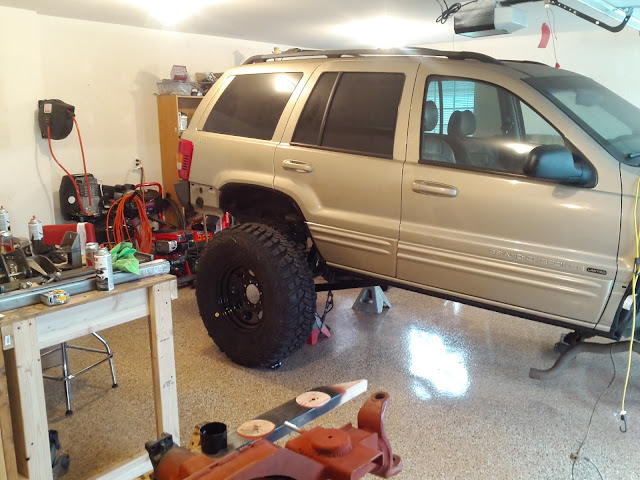

Someone got the 60 under the rear???
Maybe..
This is at actual ride height. Here is clearance with the tires.
I think I may shift the tank back a couple more inches and bump the axle back another inch. Here is current clearance, it actually looks like it'd tuck up now, just would like a little more breathing room, easy enough.
Obviously still have to locate the lower shock brackets and sway bar brackets on the axle, adjust pinion and measure for a driveshaft when I get the t-case. Then mount the brakes and hubs, plumb the brake lines, etc.

post #192 of 845 Old 05-10-2013, 07:45 AM
doorjamm
Location: Roseville
Posts: 728
Hmmm your pretty darn close to the garage door motor. This is where you have to check to see if you'll be able to get out with this thing lifted. The embarrassment you'll feel if its stuck in the garage lol. I'm just playing, but this thing looks incredible. Keep up the solid work, making me jealous.
he can always just let all the air out of the tires for a few extra inches of room

post #194 of 845 Old 05-10-2013, 08:36 AM Thread Starter
dillonjm
2013 WK
Join Date: Jun 2003
Location: Wichita Falls, TX
Posts: 4,215
Hah. Somewhat of an illusion. I had almost 15" over stock height to the garage door. And that was to the roof rack cross bars which are coming off.

post #195 of 845 Old 05-10-2013, 08:45 AM
ChrisHager
Administrator
ChrisHager's Avatar
Location: Springfield
Posts: 9,288
15" to spare from stock and you're going to 6.5" of lift and 37's (6" gain from tires). You'll be only about 5"-6" from rubbing after removing the roof rails. You might need some pull down winches if you ever throw on a roof rack!
