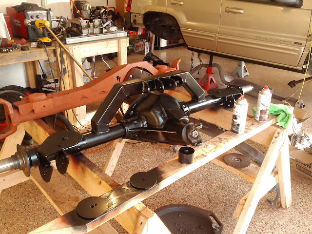

Lower coil mounts, LCA mounts centered and clocked to ~15 degrees pinion angle and tacked.

Are you just measuring mount locationa based off of the old axles? Any adjustments to control arm locations?

I measured the width of the coils on the frame rails (40.5") transferred that to the axle and centered it. Then I rough wagged the pinion angle to 15 degrees and set the lower coil mounts at zero there. Going to make sure that is close with the axle under the jeep then burn that in.
The lower coil mounts and the LCA mounts are slotted from Claytons so you don't have to do the math on the control arm mounts. Just figure out coil mount placement, slide the three pieces together and weld it. Pretty simple design.
As far as adjustability, the LCA brackets have multiple holes for different arm placements.

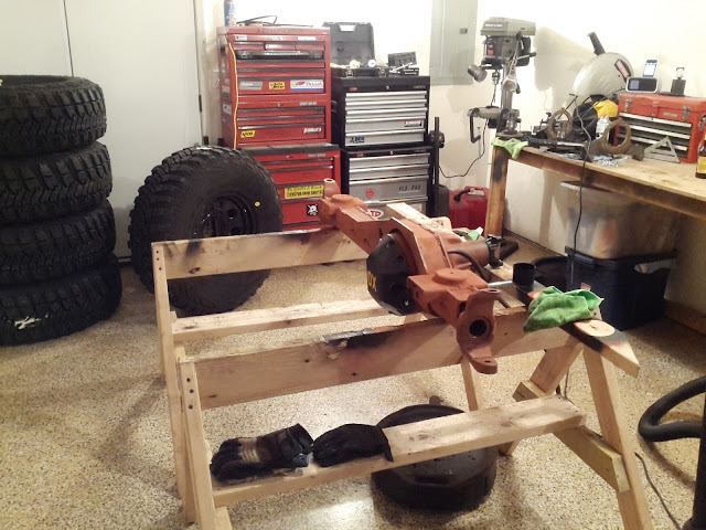

Something is mysteriously absent from the sawhorses tonight..
