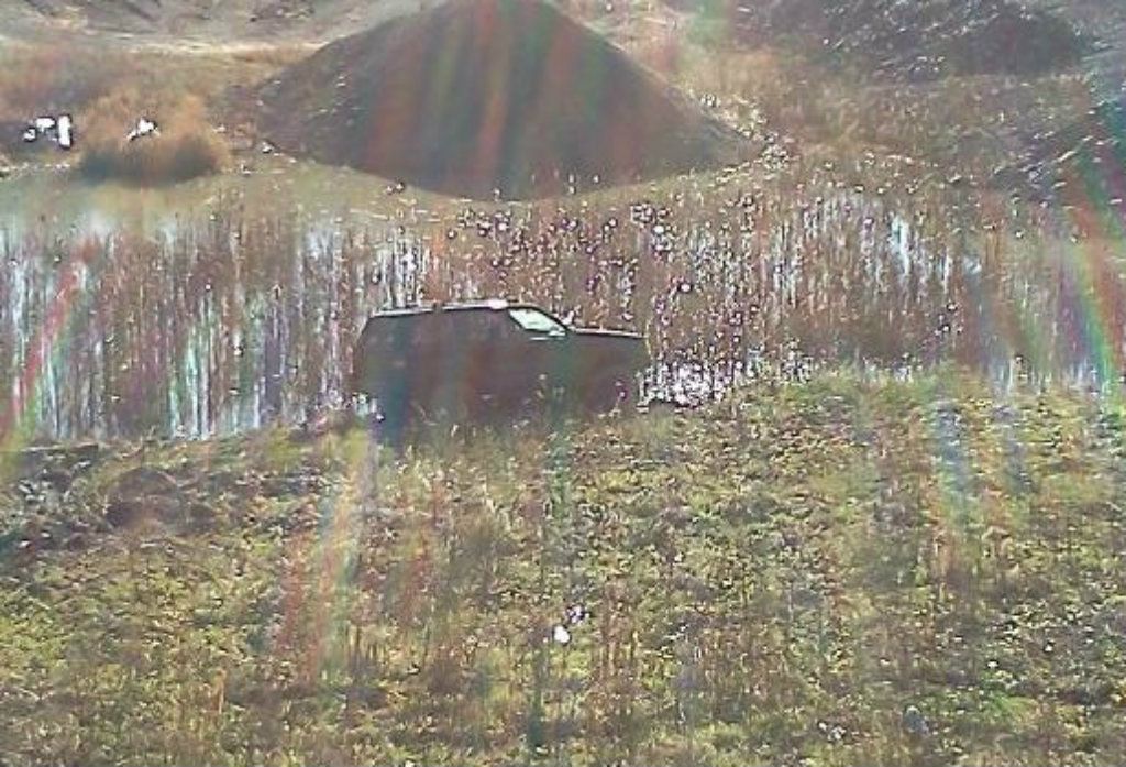

Alright guys, I have finally decided to start a build thread for my Black 97 Jeep Grand Cherokee Laredo. Due to lack of funds, it will be verrrrryyyy slow, lol. But I shall update it whenever I do something to it.
***CURRENT PIC***
I'll start off with the name: I call it "frankenjeep" because I bought it supposedly stock, but it turns out I have grand cherokee TSI rims, and a, 93 4.0 I6 engine, which is different than the 94+ 4.0 liter engines. So I'll start off with some pics of it:
It has a D30 in the front, and a D35 out back, stock muffler, new tailpipe, no cat, Selec trac, 42RE trans, etc...

Looks clean as hell. Specially for black.

Thanks man, looks a little worse in person, lol. But it only has two small dents, haha. And the clear coat is coming off on the roof, but otherwise its in great shape, and the interior is great.
