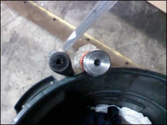

so im building a dana 60 rear end that came out of a 75 f250, i talked with a rep from seven springs custom where i was trying to order a spool that i could run my stock 4.10s and 30 spline axle, which was discontinued. so instead i figured i would upgrade my axles to 35 spline. come to find out after i already installed the spool and everything that my yukon axle shafts are 1/8" to big, now im not sure but i have seen on a few websites that people lath out a section so their upgraded axles fit. i didnt realize i would have these issues until now where im at a stand still any help would be greatly appreciated!! thanks
stock on left and the yukon on the right

You need to boar the spindle's open to accept the larger axle's. But becarful some spindle's cant be board. this is whay alot of peaple skip any 60 rears. But dont dispair you can cut the small boar spindle's off ( if there small boar's ) and weld on 14 bolt spindle's. Or junk the axle and find a HD 60 rear or a 60U, bolth of those will have large boar spindles, so the 35 spline shafts will slide threw.

And yes you have to chop the spindle off the axle, get a line up bar, remove the full spool, slide the line up bar threw, weld on new spindle's and get larger hub's to mate to the larger spindle's.
balitic sell a FF spindle Full Float Spindles Billet 4130 CrMo that will work but you need the SRW hubs from a 14 bolt ( or DRW's whatever sute's your needs ).
Its not an easy task, but one thing i would check before cutting the spindle's off is to messure the OD and the ID to see if you can boar them, keep them welded on and just open the stock one up.
Or sell it all and buy a 14 bolt or dana 70 with all the beef factory. Agian this is some of the probelms with a 60 rear or at least the wrong 60 rear. hope you get it sorted out.
