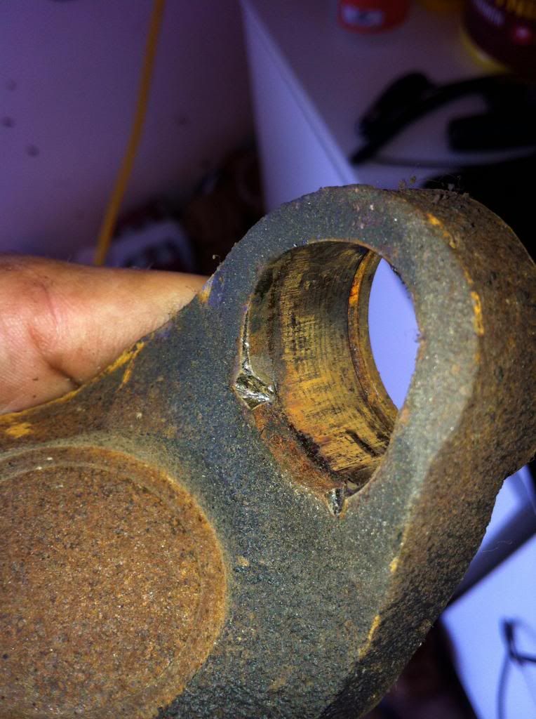

Need some quick help. I'm replacing my U joints and when I was pressing out the joint I seem to have damaged the yoke from where the joint was pressed too far and made a slight grove in the yoke. Is this something I can just file down or no? Thanks
dougiefresh131 is offline
post #30 of 57 Old 08-02-2013, 11:52 AM
caiha
Posts: 94
I have filed before but depends on how feel groove is
