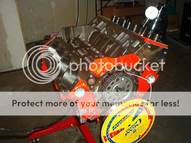

That's why I was saying to install it before the crank so you can use your other hand to gently work it back. For some reason, I'm assuming that you didn't do it that way. Is that correct? If the cam still needs to go in, you can bolt the sprocket on it and hold it like a steering wheel and carefully finagle it through the journals.
So what brand is the degree kit and does it use a piston stop or bridge and dial indicator to locate TDC. Is it set up to read off of the pushrod or valve?

I did slide the cam in after I plastigauged the mains just before I assembly lubed the mains back in before doing the rods. The wheel has Mr Gasket on it, and I'll be using a dial indicator and I was planning to read off the edge of the lifter after I use it to find TDC. Sound ok? Am I on track?

Is it a full degree kit or just the wheel? I'm just trying to get a better idea of what you're going to have to do.
My old Crane kit uses a piston stop through the head to find TDC and then has an adjustable arm assembly that threads into a valve cover bolt hole that you attach the dial indicator to which reads off of a pushrod.

The degree wheel is this one:
I'm thinking I like the wheel you used better with the three holes to attach it to the damper. I don't have the heads on yet, so I think it will be easier to find TDC with the piston, was thinking about some type of positive stop though, seen someone use just a plate before with a whole to bolt it down over the piston and a threaded hole to stop the piston.
