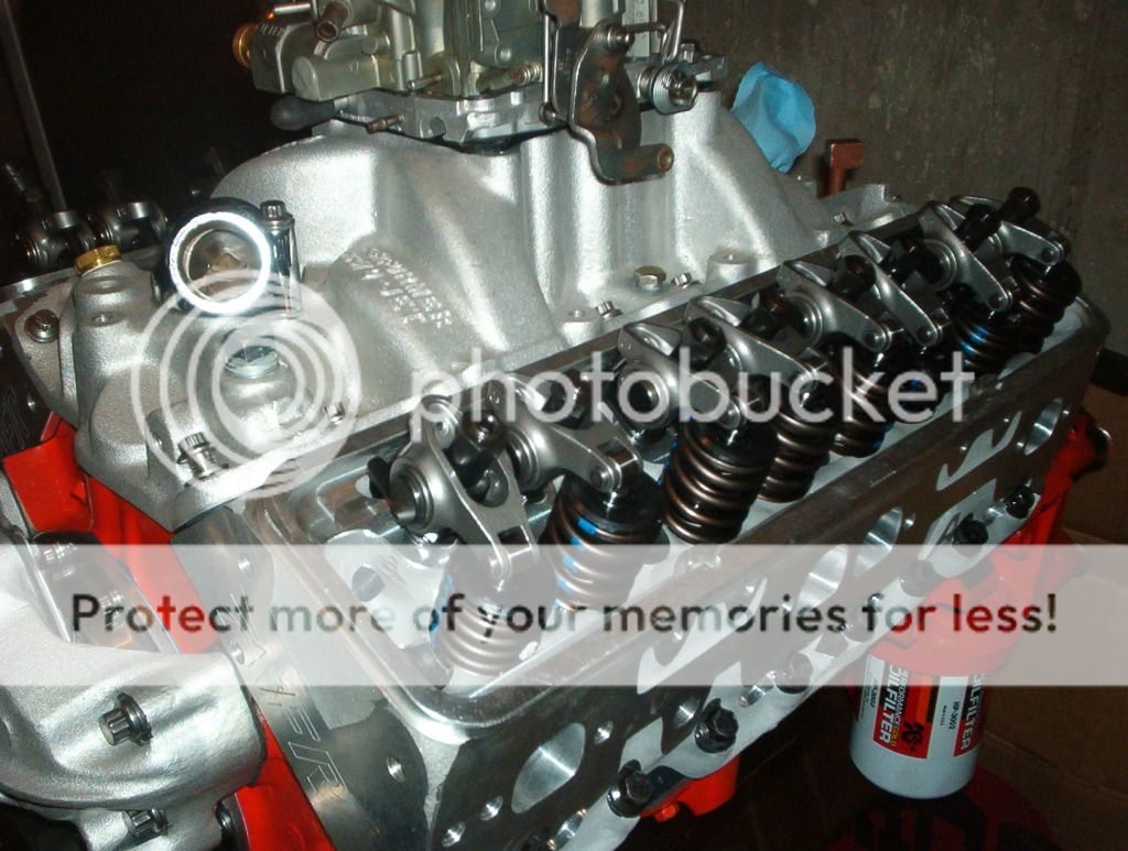

I just read your first again and saw where you want to run roller-tipped rockers. If you're talking about something like the Magnum rockers http://www.summitracing.com/parts/CCA-1418-16/ I've run them before and I like them. I haven't run them on a roller though. There's no way I'd stick them on that 3190 lobe!
Those rockers in a 1.6 ratio on the 3301 lobe is a good question for Chris. Unless you're planning on running Pro-Magnum rockers, Comp lifters and Pro-Magnum pushrods, disregard everything I said about that other lobe and we'll stick with the original 3301 game plan, assuming Chris is ok with Magnum rockers on it.
If he has reservations, we'll just have to move to a less-aggressive lobe. Not a problem, just let me know what he says and we'll go from there.

FWIW I have never had good luck with roller tip rockers and never known anyone personally who did. If you need the roller tip the fulcrum pressures are so high you need a roller body.
I used to be a manufacturing engineer at a foundry that made the rocker bodies (and some complete rockers) for several aftermarket manufacturers, a couple of OEMs, some american, some german, including a few OEM in house racing programs. Got very familiar with their materials and quality requirements.
When I need anything beyond a stock rocker, my money gets spent on comp cams pro magnum full rollers. Nuff said.

I definitely hear what you're saying, foundrydude, and I agree.
Pro-Magnums are awesome and work extremely well in all but balls-out kind of deals.
I respect your reservations about roller-tipped rockers but I really think he'll be good to go with the Magnums on the 3301 lobe. The only beef I have with them is the damn adjustment nuts. They tend to back out every few months (at least mine did) and I finally got sick of it and ponied up for some nice lock nuts http://www.summitracing.com/parts/CRO-86051S-16/
Comp has them too but the picture didn't look right.
