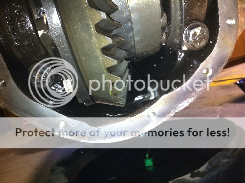

Not trying to hijack this tread but honestly it's been dead for a year so what the hell.. I guess I am.
Removing the junk from the differential and noticed some rust was removed and it doesn't look too good. I got that lube locker but is this going to be a problem?
