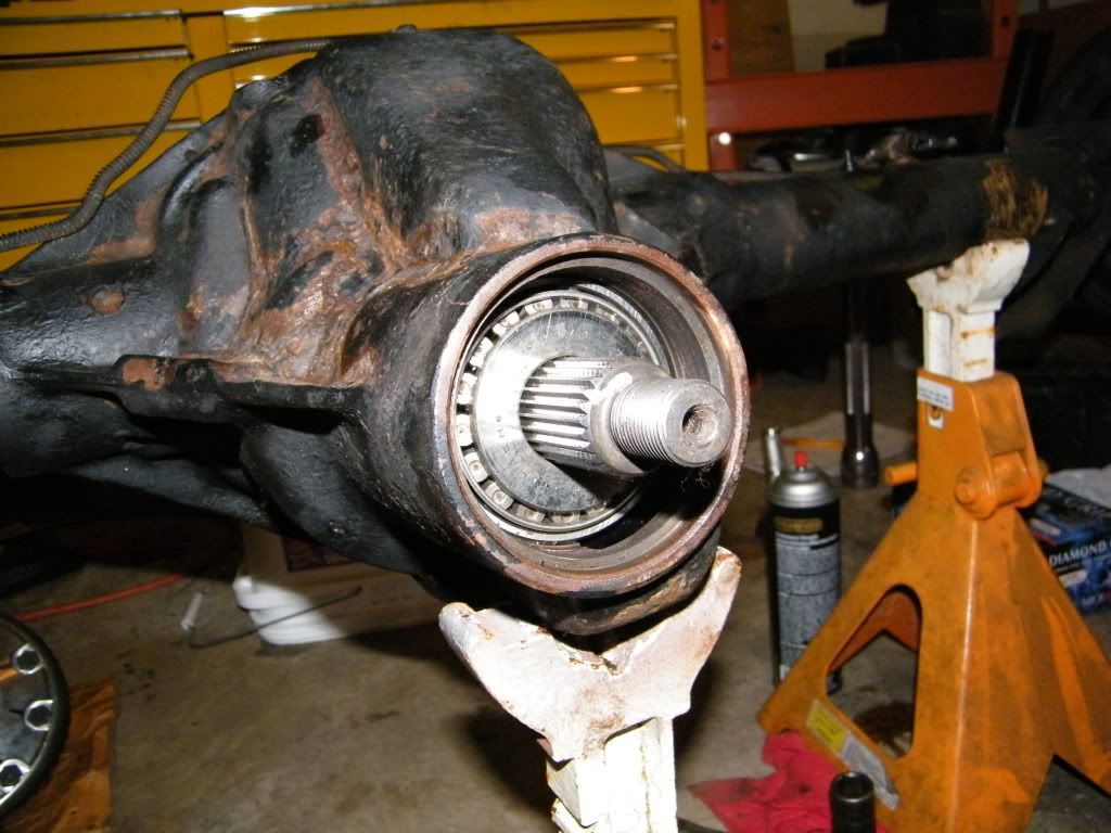

Slide the axle out like so to get it out of the carrier
Then pull the diff cover and drain the fluid... you should see something like this

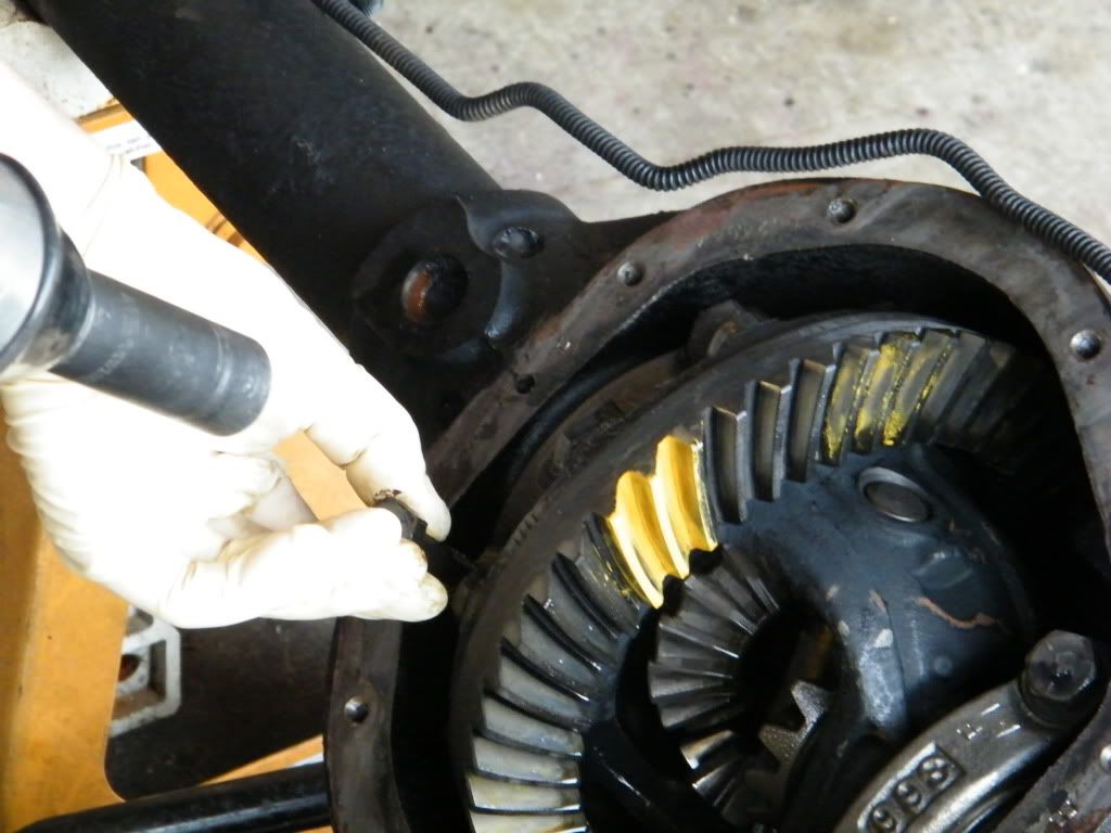

Mark the bearing caps... they can only go on in one orientation... flip them or swap them and you are asking for trouble. They are precisely machined from the factory so that the carrier races are properly preloaded evenly all the way around. I use a chisel and mark a "|" on the top of the left cap and "||" on the top of the right cap. No way for it to wipe off or mix them up.

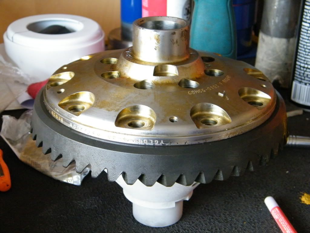

I decided to make it easy on myself this time and I put the new carrier in the freezer overnight. Metal shrinks when cold and expands when it gets hot... so by doing this the new ring gear should just about drop right onto the carrier. You don't want to pull it down w/ the bolts... If you must then do it EXTREMELY slowly in a criss cross pattern. I'm talking no more than 1/4 turn each time. You don't want to warp the ring gear. If you like you can put the ring gear in an oven at 250-300 degrees to help this even more. I chose not to do so... at my parents' house my mom was busy making cookies. Didn't want them tasting like metal
I just had to give it a slight OOMPH to get the ring gear all the way down...

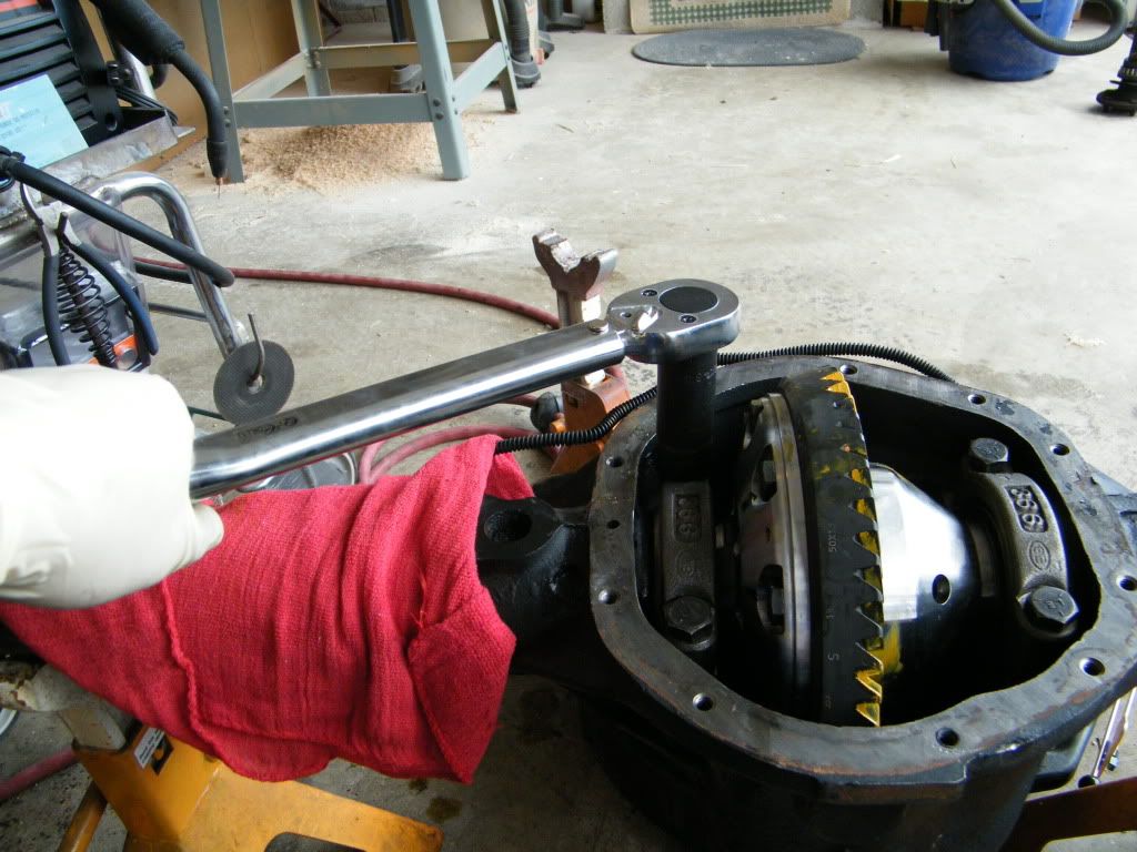

I started all the bolts by hand and finger-tightened them, then sat the carrier/ring gear out in the sun so that everything could get back to ambient temperature.
While that's going on, go back to the diff assembly...

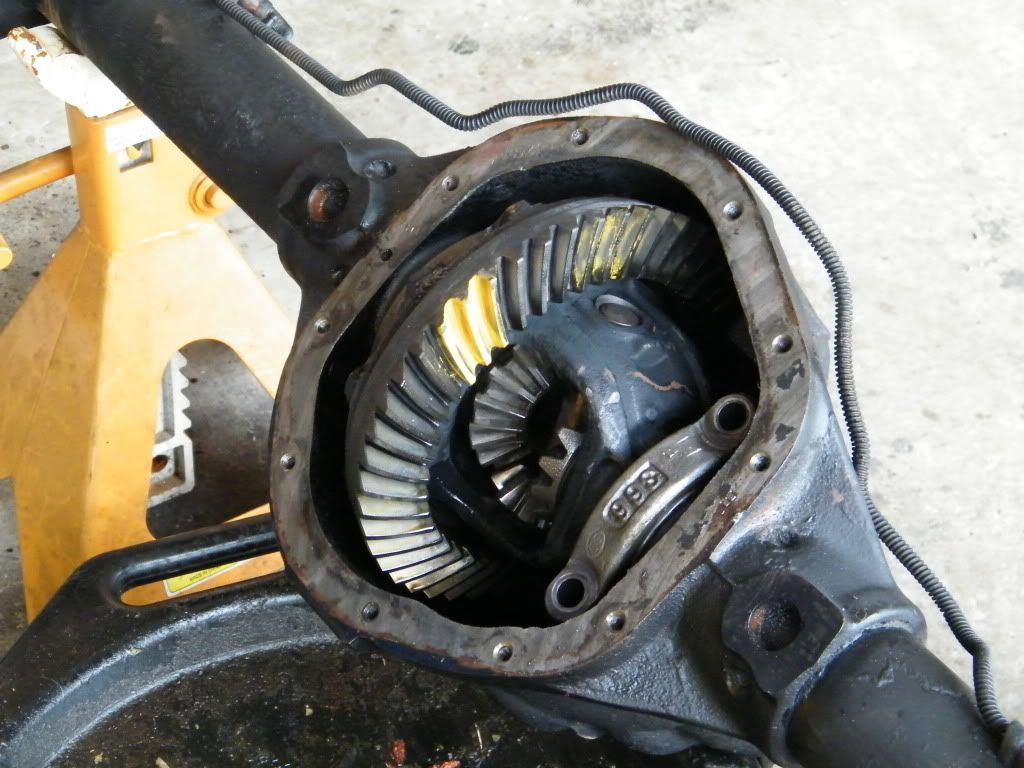

Should be looking at this in the diff:

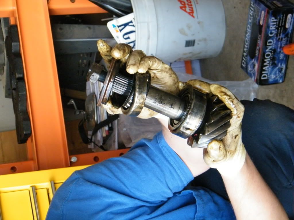

And the pinion will look like this
At this point you'll probably find that the outter pinion bearing is a slight to very firm interference fit to the pinion, keeping you from just plain pulling the pinion out of the diff. I put the old pinion nut back on the pinion(flush w/ the end) and smack it with a hammer. Don't go too crazy, don't want to distort anything... you still need to get the nut off to remove everything.
The pinion seal will need to be removed before you can take out the outter pinion bearing(it will be stuck between the housing and seal). My seal puller just kept tearing up the seal... so I used my brass punch to just hit the bearing through from the inside out(forcing the seal out with it)... I forgot to take pics of this.

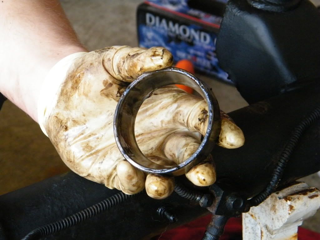

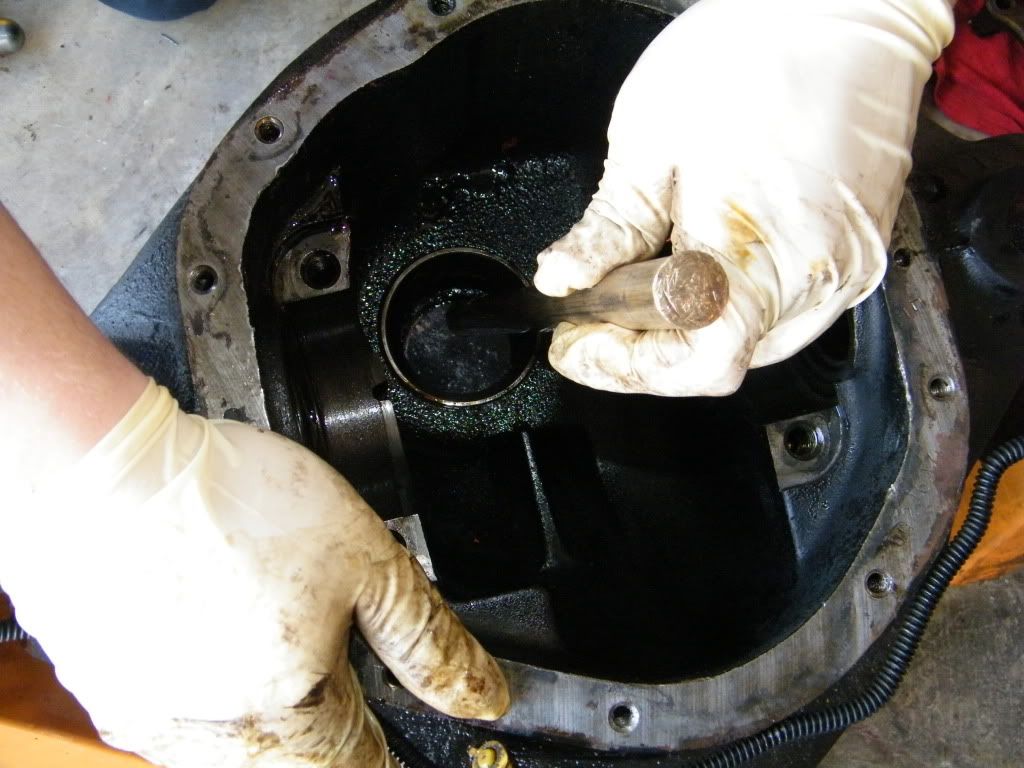

Now take that punch and knock out the outter pinion race(from inside out) like this:
And knock the inner race from outside in:
I took this pic for you guys to see how it all goes together when assembled(minus pinion yoke):

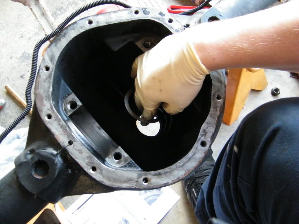

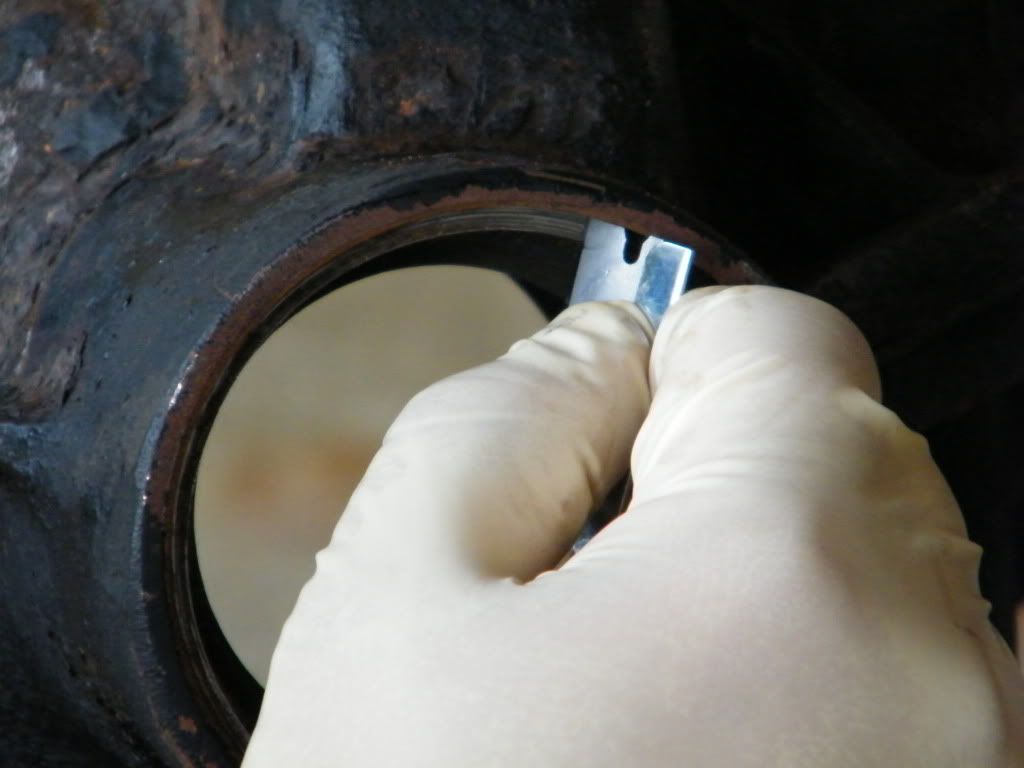

I cleaned up the pinion seal surface with a razor blade, get all the old seal RTV stuff off.

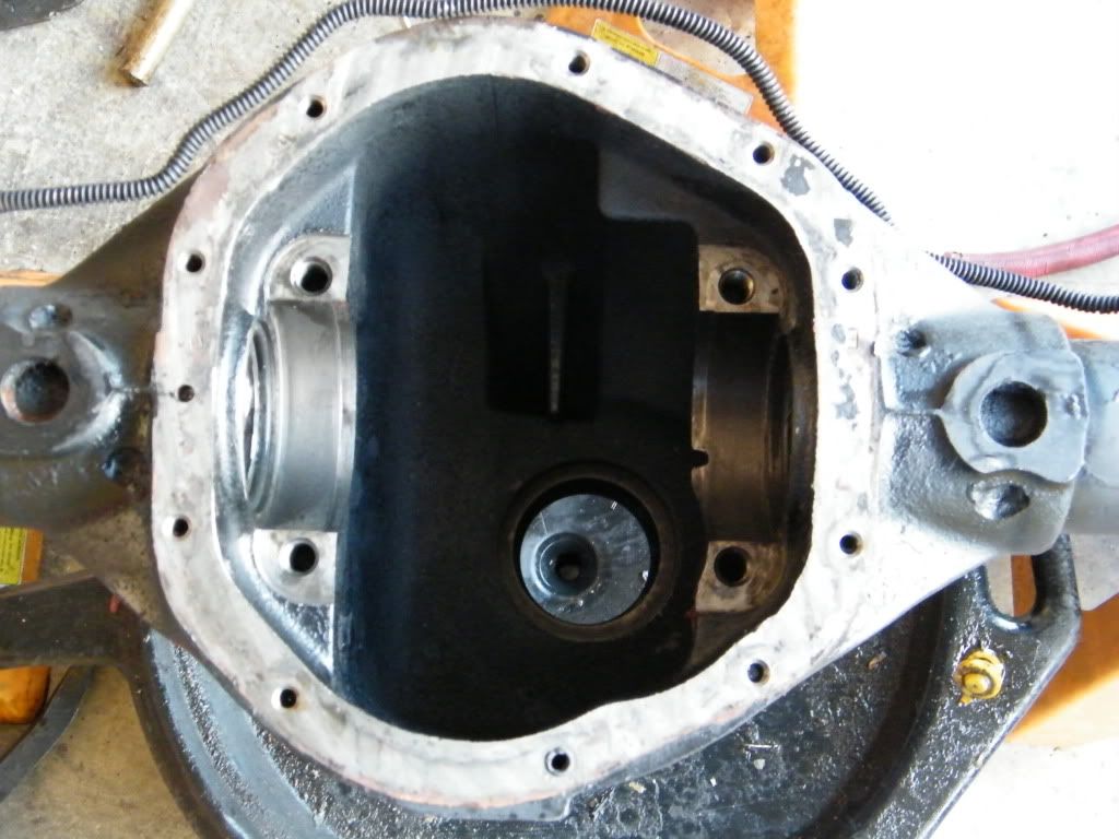

Now that you have a bare housing, use a TON of brake clean(or something equivalent) to get it all clean and dry and free of crap and gear oil.
At this point I measured the shims that were under the OLD pinion race... I got 0.044" thickness.
I then took the NEW -outter- pinion race and knocked it in w/ my race driver kit and a hammer:

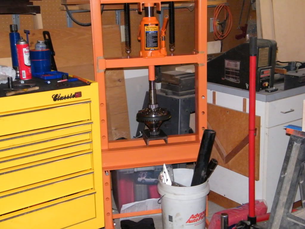

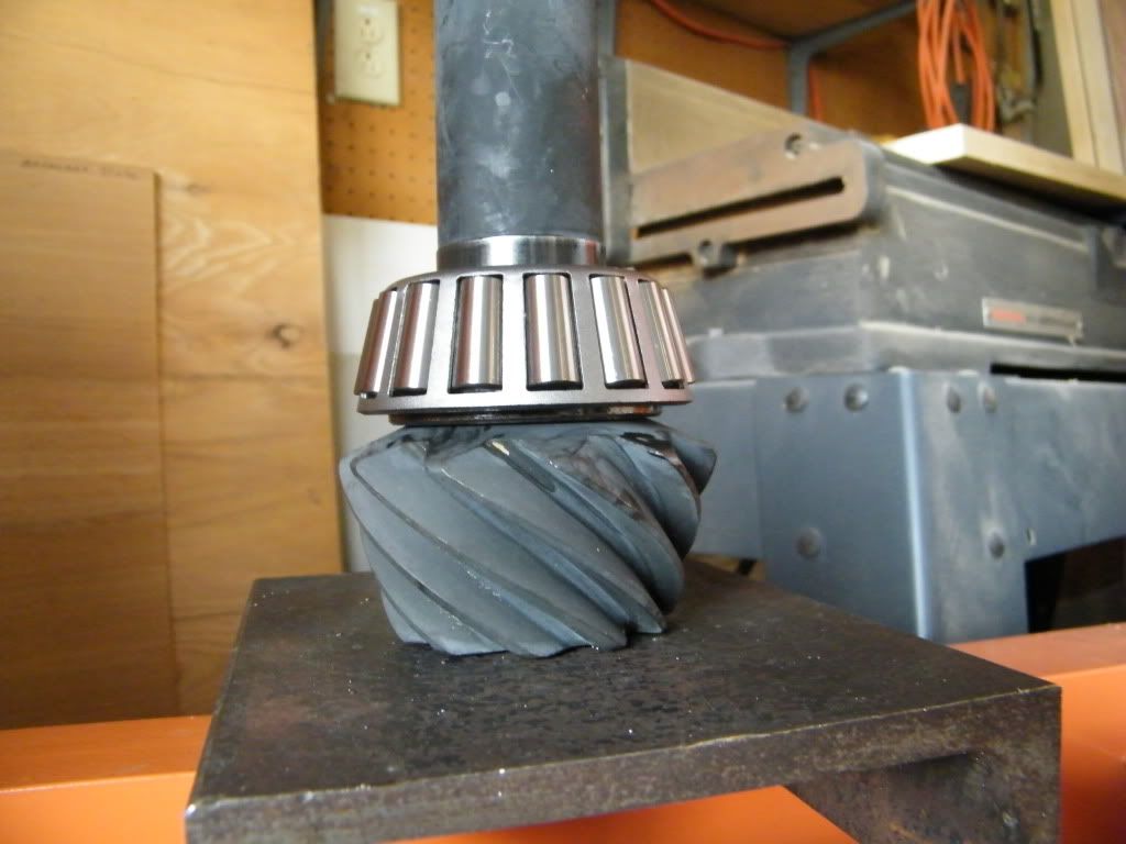

I also chose to press the new inner pinion bearing onto the pinion at this time... having a 20t press is nice
aaaand it's full seated:
NOTE: There were no baffles or oil slingers under the old inner pinion bearing so the same thing goes on the new one... nothing.

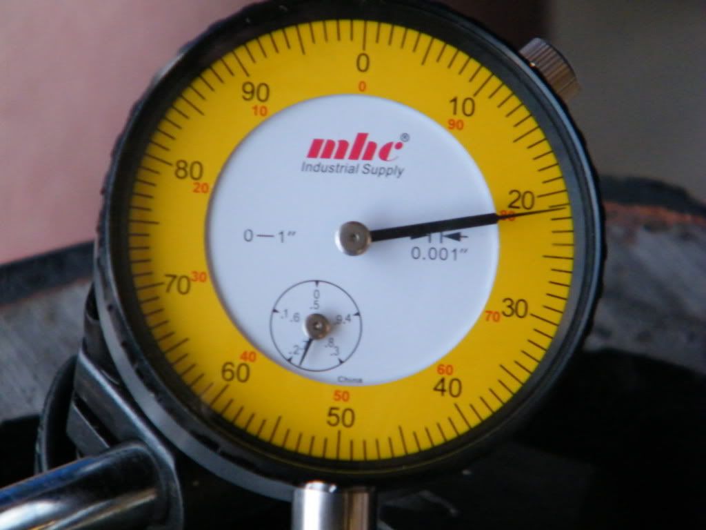

I zeroed my gauge and it doesn't move side to side at all with the bearing caps snugged down.
I then set up the dial indicator to read backlash with the current shims in there(0.019" left and 0.058" right):
I got 0.020" B/L.

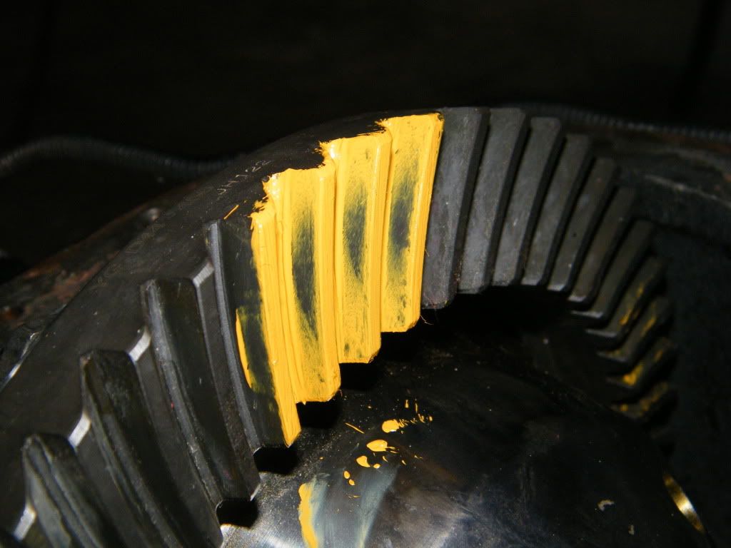

So now we get to take a gear pattern...
paint the gears all pretty and evenly
And here's what we got:
It seems the pinion was just a LITTLE too far away from the ring gear... so we need to ADD pinion depth shims.

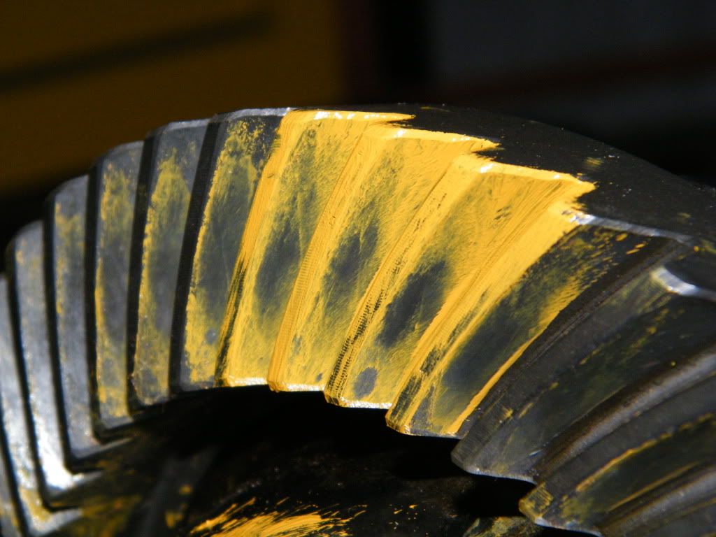

Time for another gear pattern:
Forgot to take a pic of the coast side(doh). But this time it's too close to the ring gear... so since the last pattern(0.041") was closer, I had to choose 0.042 or 0.043... I went w/ 0.042" for the next pinion depth attempt...
Again knock out the setup race and change the pinion depth shims...

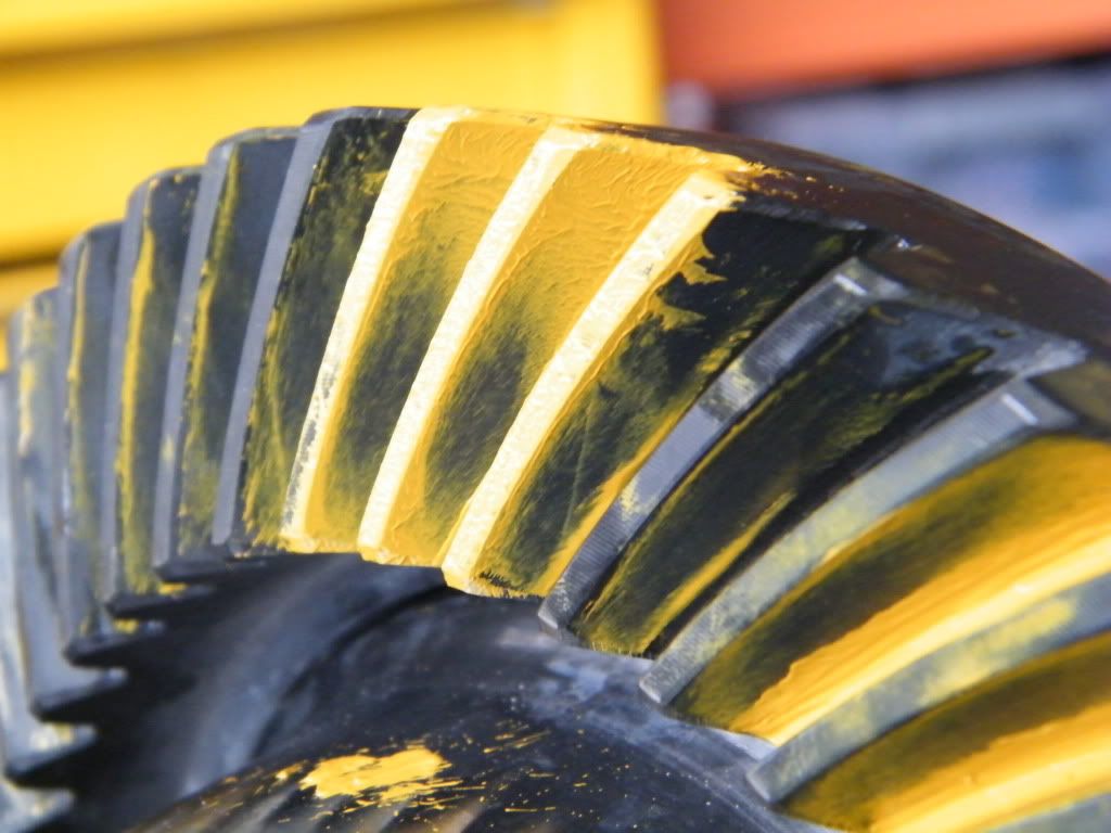

First trial w/ 0.042" pinion depth:
-L carrier: 0.037" shims
-R carrier: 0.042" shims
= 0.008" B/L
First try! Awesomeness!
And IMO that pattern looks great.

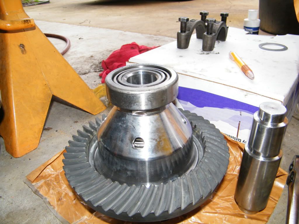

I now pulled the setup carrier bearings off and laid the shim stacks aside(don't get them mixed up!)...
I pressed on the final carrier bearings(no preload added yet... you'll see why in a minute):
And as I expected(much like what happened w/ Jakes axle)... the backlash moved...
With the final bearings and races all in(minus preload) I was looking at 0.002" B/L.

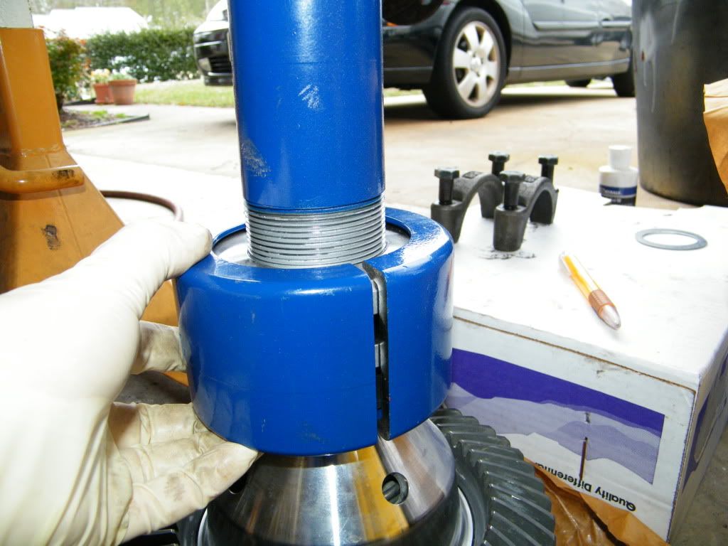

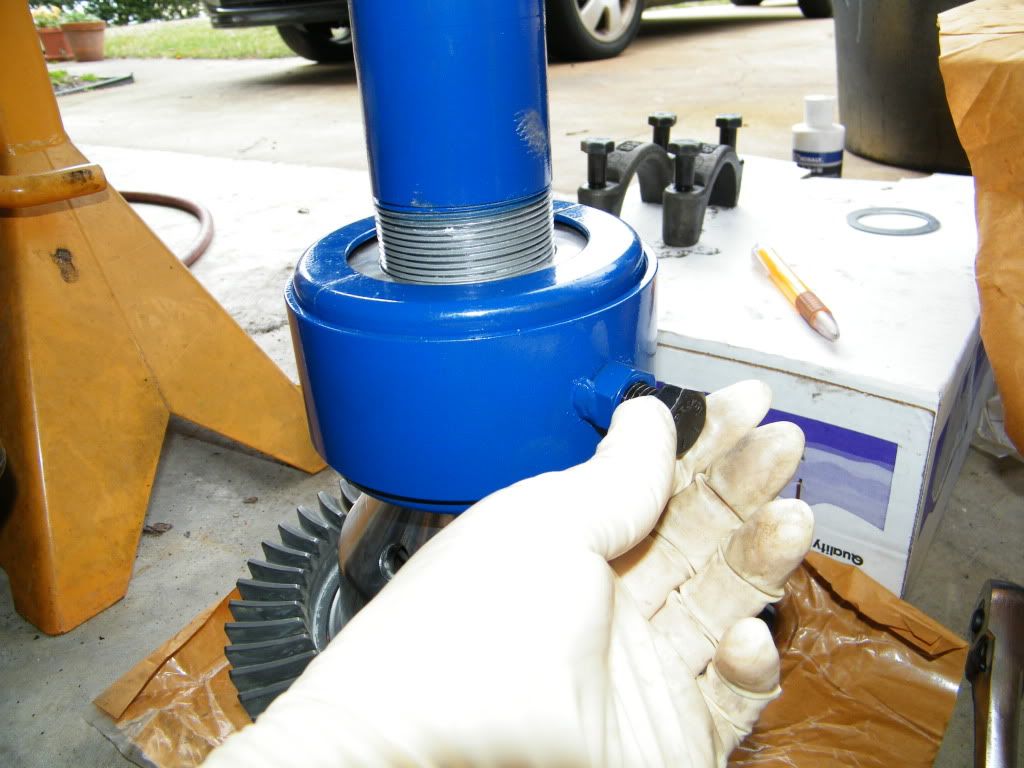

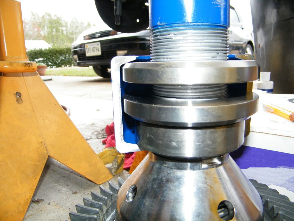

Now is when the Yukon puller comes in handy...
Put the race on the bearing:
Put the plug in the carrier(make sure it's not pressing on the splines! Should be on the shoulder of the carrier):
Put the puller body over the plug and put the lower disc all the way against the race:
Put one of the clamshell halves on:
Then thread the upper disc up... take all the play out of the bearing/clamshell half/puller assembly:
And the other half on:
Slide the retainer ring down and cinch down the bolt to keep it from coming off:
And use a 36mm socket on a 1/2" impact to tighten the puller... you need to coat the threads of the puller in anti-sieze every time you use it because they're under a LOT of force.
And here's a little video of it in action:
It's awesome to have
So that made final shim changes awesome between the puller and my press. Here is what I went through to dial in everything:
For the final bearings all pressed on and 0.042" pinion depth shims
First trial:
-L carrier: 0.035" shims
-R carrier: 0.044" shims
= 0.005" B/L... Yukon spec is 6-10 thousandths, OEM is 5-8. I figured I'd try to get a little more from it.
Second trial:
-L carrier: 0.034" shims
-R carrier: 0.045" shims
= still 0.005" B/L. Doh!
Third trial:
-L carrier: 0.032" shims
-R carrier: 0.047" shims
= 0.008" B/L. That's where we want it
So then I had to add the preload to the carrier. I added one 0.005" shim to EACH side(0.010" total)...
-R carrier: 0.052" shims
= Backlash went up to 0.009" which is just barely out of OEM spec and still in Yukon spec.
Note that with the final preload added, it should require quite a bit of persuasion w/ a BFH(soft face dead blow hammer... a big F-n one ) to fully seat the carrier. If it drops right in easily then you risk the bearings destroying themselves due to lack of preload.
So now I fully torqued down the carrier bearing caps to 80 ft lbs...
And my awesome luck made the backlash jump to 0.011" arg!
So I pried the carrier back out of the housing, and switched a few shims around...
R carrier: 0.054" shims
= This gave me 0.008" B/L... then I rechecked the gear pattern:
The pattern is centered from face to flank so that is what is important. It's pretty hard to aim for centered from heel to toe as well... this pattern is accaptable accord to Yukon's install manual as well.
Everything is now torqued to spec and all the setup bearings are gone so the gears are good to go.
