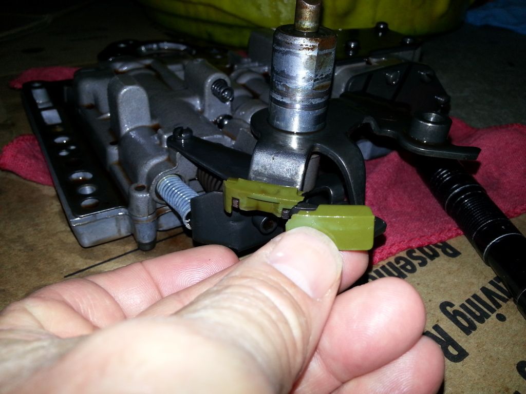

SO I've have tf999 auto transmission that I replaced the leaking shifter input seal on. The problem I've incounter is the plastic ramp attached to the shift mechanism on the valve body is broken off. I've searched but can't seem to find a part number for it. Anyone know where I could get this from?

Here is a picture.

Dealer part take it in and let the parts guy figure it out and order a new one.

Take one off of a used valve body. Be sure they are the same as all actuators are not the same.

Thanks for the replies, Dealer was zero help. After searching and calling around most of the day finaly found a transmission shop that had some and knew what the heck I was talking about. Here is the what I purchased and was a perfect fit.
Insulator-neutal switch from sonnax part number 22229-03. Part is marked for Chry RWD 1970-2002.
