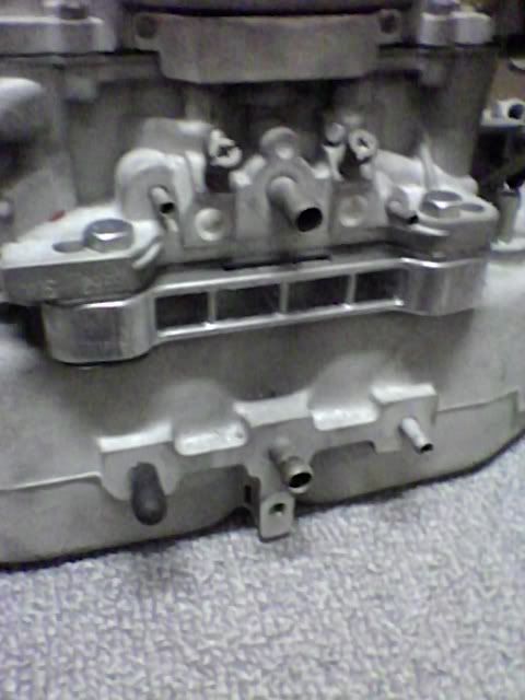

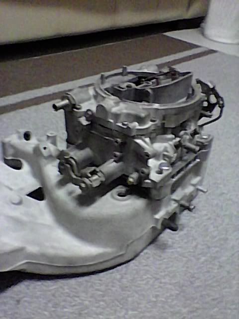

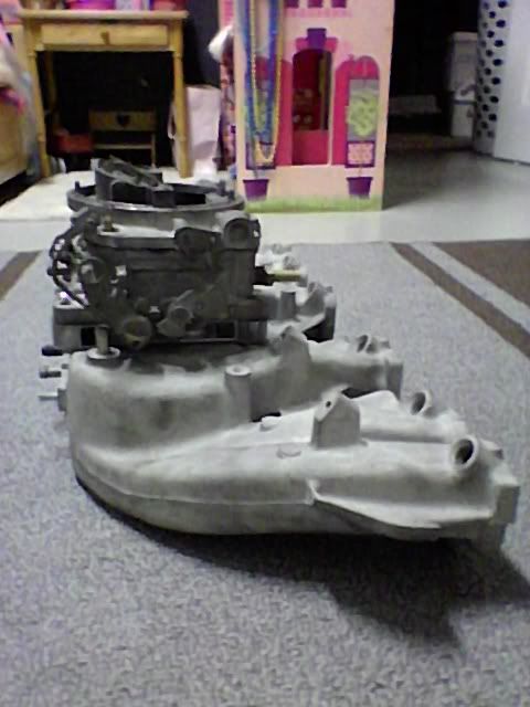

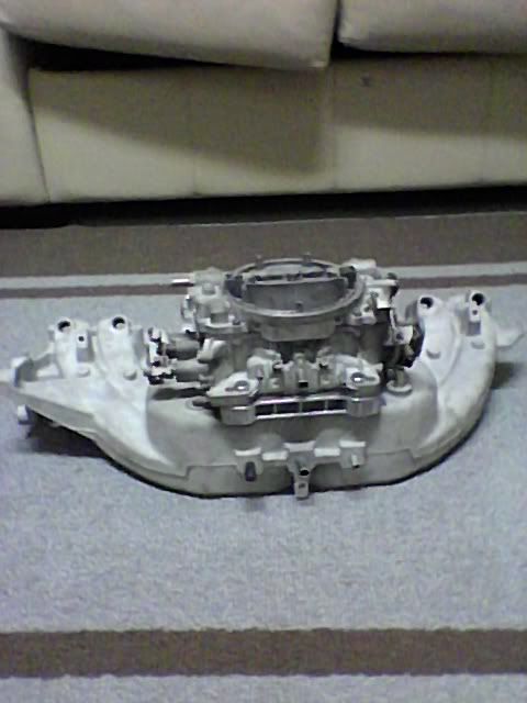

ok! ive been hard at work today. After finding the only jeep grand cherokee with the "horse shoe" style intake, which was pulled with ease, the intake was sandblasted and machined to my liking. I also picked up a 20 dollar Edelbrock 1405 model from a friend who did not want to rebuild it. Bought a rebuild kit and patched her up. Bought a cheapo Mr Gasket carburetor adapter plate, drilled it out and countersunk my mounting bolts to the intake. Mounted the carb and stared at its awesome beauty....although the carb is old.....and used....i will eventually buy a new one due to the cosmetic downfall of this current carb
