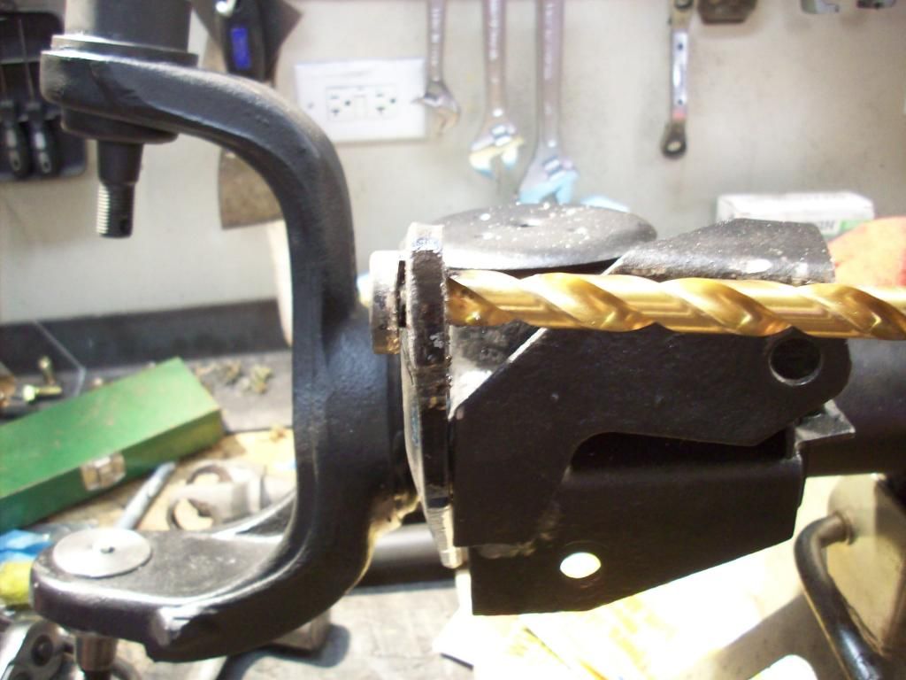

How the hell do you get the sway bar bolts out I tried an impact gun a breaker bar I tried just beating them out I can't get them out.
goldeagle06 is offline
post #28 of 50 Old 10-22-2012, 06:30 AM
Jason
Location: North Port
Posts: 6,566
The have splines on them so they don't spin. I had the same problem, so I ended up cutting them off and drilling them out:
Jason is offline
post #29 of 50 Old 10-22-2012, 07:19 AM Thread Starter
goldeagle06
Location: Lewistown
Posts: 192
Alright do you know what size bit you used?
post #30 of 50 Old 10-22-2012, 07:27 AM
Jason
Posts: 6,566
Cut off the threaded part, then use a punch to mark as close to center as you can. Start with a smaller drill bit and drill as straight as possible, and work your way up in bit sizes. IIRC, that's a 1/2" bit in the pic above.
