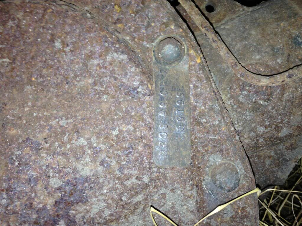

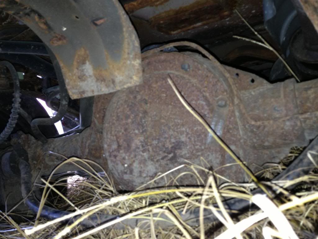

Hi all, looking to pick up a ford 8.8" from a salvage yard 1998 ford explorer. I believe it is 4:10 ratio open carrier. He was asking $250 for it, I told him I'd give $200 since it's not a LS diff. Went to take a look at it today and it was hard to see the whole assembly but I was able to stick my phone underneath for a couple pics.
What all do I need to inspect before purchasing this 8.8?
Is it too rusty, or will it clean up fine?

Since he's got a salvage yard and in the business of selling parts then make him guarantee the thing. Other than that I bet you will need to replace all or most of the brake hardware. Who knows if the gears and bearings are ok. Its hard to tell about the rust in the pic but I'd bet the brakes are about the only thing needing attention.
As far as it being an open diff could be a benefit. If you are ok with the loose OEM LSD then that's fine. If you want a locker of any sort then you want an open diff or replace the whole carrier. It would need an open diff to install a lunch box style locker, all the other lockers would replace the carrier anyway.

It will clean up just fine. Appears to be just surface rust. I recently sold one that looked about the same way for $200. I did drive the Explorer home before I pulled it and the brakes where good.
For $250 I would expect it to be a little cleaner and have the carrier you want.
