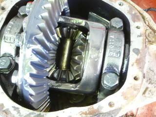

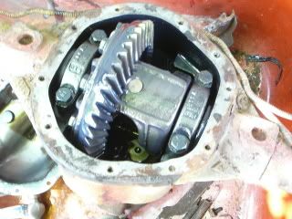

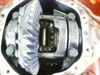

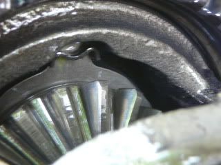

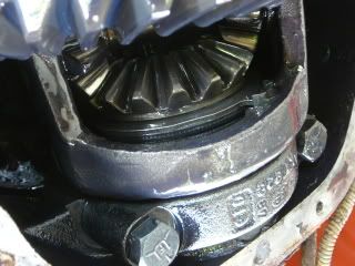

can anyone tell me what diff this is?
i pulled the rear out of a 1987 cherokee pioneer didnt seem to have the tow package unless it was removed...
anyways i turned the one axle and was excited to see the other spin with it...

No tag I assume? Check the gears, otherwise it looks like a D44. But many Cherokees had a Chrysler 8.25, not sure what that would look like though.

sorry maybe i should have cleared things up some...
it is a dana 44 as per the thread title im trying to find out what limited slip diff it is tho...
its 3.07 gears i pulled from a 5 speed 1987 cherokee pioneer

Almost certainly a Trac-Lok. Don't get too excited; these things are about useless for wheeling. Arguably, having a limited slip is a bad thing because now you can't even install a lunchbox locker with getting a new carrier and setting up the gears.
