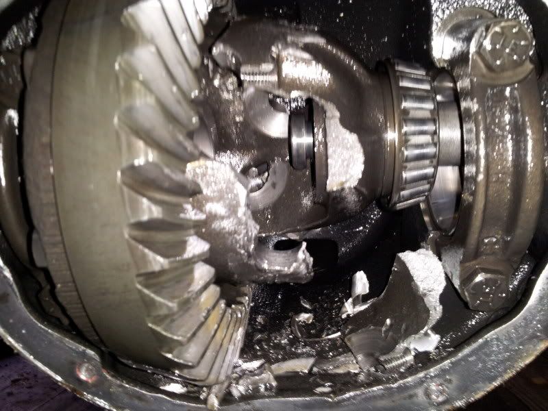

So I have a 2005 TJ. I drove home from work the other day and was backing into a parking spot and I heard this loud bang with a jerk. . The Jeep was still in gear but nothing was happening. My worry was it was either the axle or drive shaft. I inspected it the next day and looked as if the shafts were intact and functioning. But the the axle was not responding to any power input.
I had it towed to the Jeep dealership nearby (warranty). They called me yesterday and told me that theyve never seen a D35 do this before. The inside apparently looked as if a grenade went off inside the axle. And the only fix is a complete replacement (thank god its only $200). Anyone ever hear of this happening? Not really looking for advice, Just thought I would post this experience for y'all!
- G

A Turdy Five esploding!!!??? Blasphamy! Why they should do quite well with 700rwhp.
JK, they have a rep of blowing up.
So was it your carrier going out or the shaft let loose and took out the ring & pinion or what?
I will let you all know what happened when I go to pick up the Jeep. But I thought that the Dana 35 was an Ok rear axle. Crap...

Yeah but bouncing them and any rear will break, he didn't break them backing into a spot.
You had a cross pin failure and most likely why it did that, as for the pics above i have seen D-80's do that, 14b's 70's, 60's i have seen almost EVERY diff made break a open carrier, and most were done plowing snow.
Nothing is invincible when used wrong, however you weren't hearing a knocking noise hear and there prior to breaking it GammaRei. The 35 is fine when used correctly and all 4 tires are on the ground.
