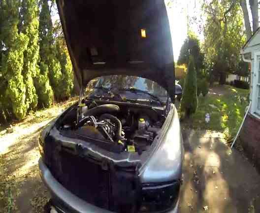

Hi, I have a '99 Durango with the 318ci Magnum engine and 44RE trans that has a really bad clank/rattle somewhere around the oil pan/bellhousing area? The noise seems to go mostly away when any throttle is applied, and it is mostly when idling (usually anytime it is below 1000rpm it will). The Durango has about 141k miles, but the trans was replaced at 110k with a reman'd trans. I have been on the XJ Tech Forum for a long time and trust JF a lot more than other forums, and since the 318ci is the the same engine as the ZJ 318ci I figured someone would know what this is...
A few people have told me that it sounded like the timing chain was loose, so I replaced the timing set this last weekend. And that did not correct the clanking/rattling noise.

Alright, well I figured it out! Lol its a cracked, or loose, flexplate. So today I am going to try to access the inspection plate and get the final answer

So I got into the insp plate and noticed that ALL of the flexplate bolts were loose..........and one was missing! I guess I am going to have to wait until I can drop the trans now. I didn't see where the other bolt went, let alone the fact that I can't see if anything else got damaged from it probably rolling around the bell housing. None of the bolts seem to have any thread lock on them even.
So I figure I am going to just save the money and get a new torque converter, flexplate and bolts. Sound right? Any recommendations on brands of torque converters? I have was thinking about getting a higher stall converter while I was at it, something around 2000?
The thing that really sucks is that I purchased this truck about 10k miles after a reman'd trans got put in, and I think that they must not have used any locktite. I guess I'll have to look to see if its under warranty still!? Probably not......but worth a look.
