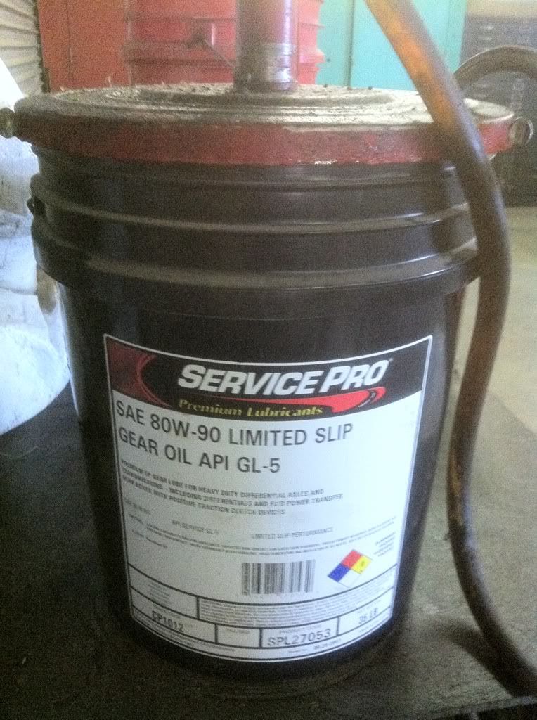

Most auto parts stores have 90 at gear oil with a friction modifier already added. Its called a limited slip mix or something.

I buy mine 5 gallons at a time
