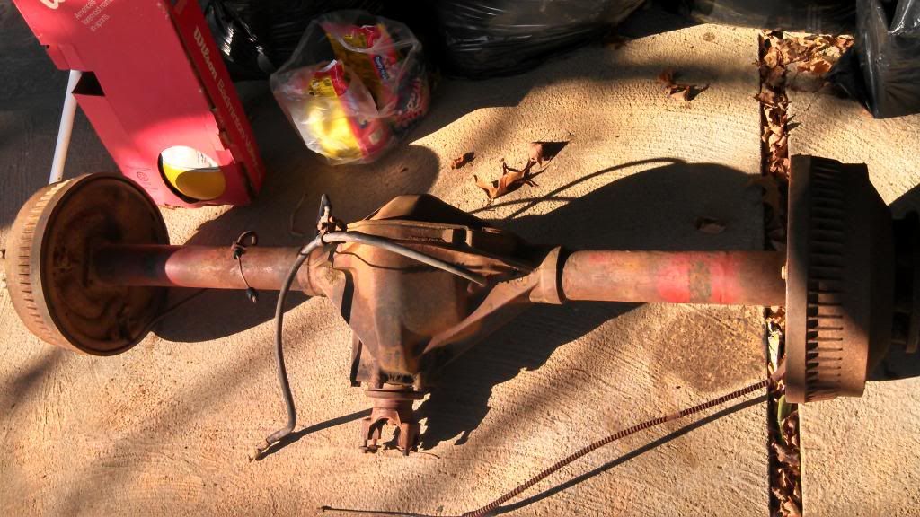

post #11 of 24 Old 11-18-2012, 10:22 AM Thread Starter
Mogar94
Join Date: Nov 2012
Location: Newark
Posts: 41
Here is the picture of the axle I picked up. The drivers side is seized up right now.
Mogar94 is offline
post #12 of 24 Old 11-18-2012, 04:52 PM
jason m
Nothing but the facts
jason m's Avatar
Join Date: Aug 2004
Location: Holland mass USA
Posts: 3,597
Nice looking rear you got there, what are the plans for the front?

post #13 of 24 Old 11-18-2012, 04:57 PM
herklord
Location: Amherst
Posts: 415
That thing is a beast, hope you go 40s to get clearance for that beast

post #14 of 24 Old 11-18-2012, 11:17 PM Thread Starter
Mogar94
Join Date: Nov 2012
Location: Newark
Posts: 41
Once I get the money I'm going to a Junkyard or CL and I'm going to start looking for a 78-79 ford dana 60.
My friend gave me 2 37" Iroks for free so I ordered 2 more boggers in the same size. Later on Once I get a better flow of income and a more built rig I'll run the 40's If I can fit them on the lift I'm going to order hopefully soon.
Mogar94 is offline
post #15 of 24 Old 11-19-2012, 03:00 PM
ltrail
1984 XJ Cherokee
Location: mesa
Posts: 1,458
Truly jealous, around here Dana 30's fetch twice what you paid for a real axle.
I just traded a disco 30 for another ford 9. I can't believe the prices in other places. All out junkyards have gone up also. Runs a couple hundred for a junkyard axle also. Never have good stuff either. I wish I could trip over a 14b at the yard.
Nice find.
