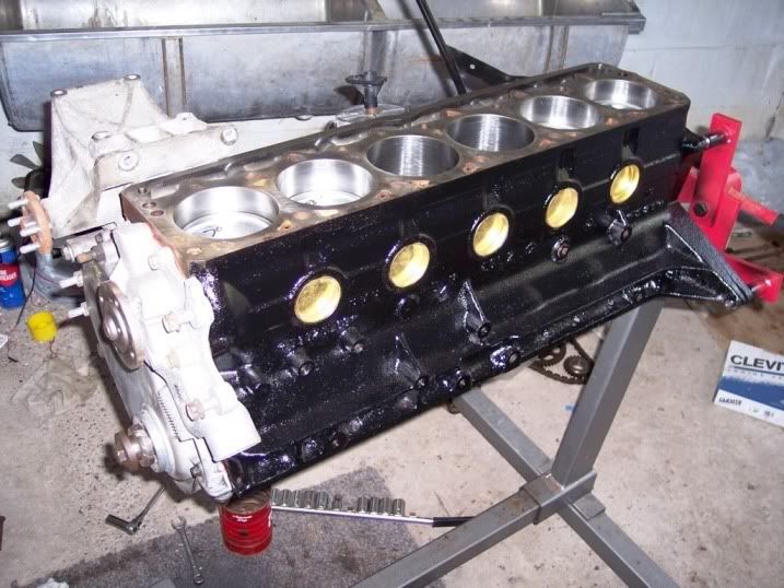

On another note, I'm also building my stroker on a tight budget. I've been building the stroker for almost 2 years, but I'm not cutting any corners. Almost everything has been bought through eBay. Total cost of my stroker has been about $1300 to get me this:
what parts are you using in the shortblock?
looks preety

Location: Eau Claire, WI
Posts: 617
looks preety
Ahhh, lets see...
-4.0 block from 98 XJ
-12 CW crank and rods from an 85 4.2L
-Sealed Power 677P pistons
-Clevite 77 rod and main bearings(standard size)
-ARP rod bolts
-Cloyes timing chain and gears
-Crane Cam 753905 260/272 duration, .456/.484" lift
-Melling high volume oil pump
-New OE water pump
-OE distributor
-FelPro rear main seal
I think that's it for the short block. Did I forget anything?
Brian-
99 XJ Cherokee, 2 door, 4.6L Stroker, 5 speed, 4x4, 8.25" rear, 3.07 gears
JEEPINWI is offline

Originally Posted by JEEPINWI
Ahhh, lets see...
-ARP rod bolts
-New OE water pump
-OE distributor
where did u get ur crank and rods?
also, are u changing your transmission? i have the AX-15, and im thinkin about goin to the NV3550, and a dana 44 rearend, the 8 1/4 will probably hold up to it, i just want to be safe...

I was lucky enough to get a running 4.2L engine off eBay for $5.50(not a misprint). I am going to stick with my AX-15 tranny since others have had no problems running a stroker in front ir it. I know of at least one guy with a stroker and his Dana 35 rear end is holding up to the abuse. I'm not one bit worried about my 8.25 rear end breaking from the stroker. If your stroker is going into a Jeep that rarely sees offroad, you're wasting your money on the Dana 44. I think the D44 is only 10-20% stronger than the 8.25 anyways.
