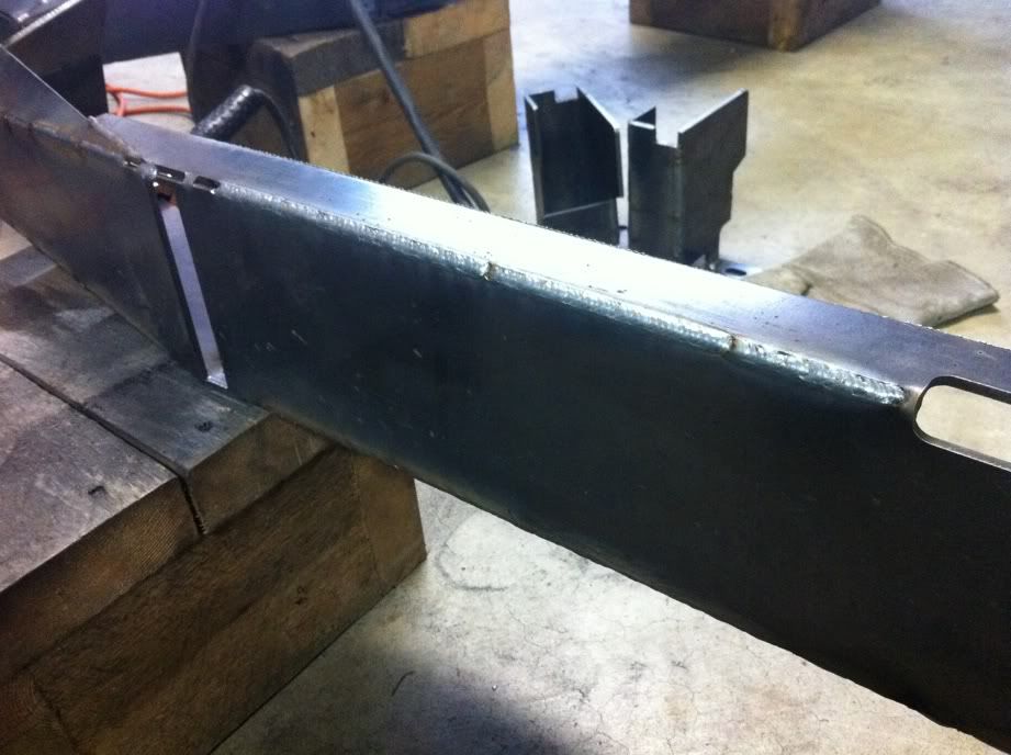

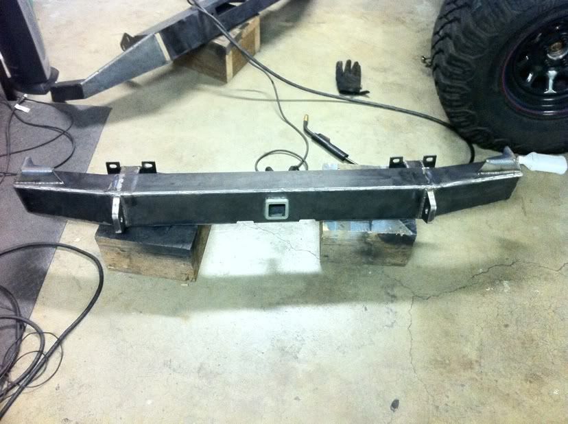

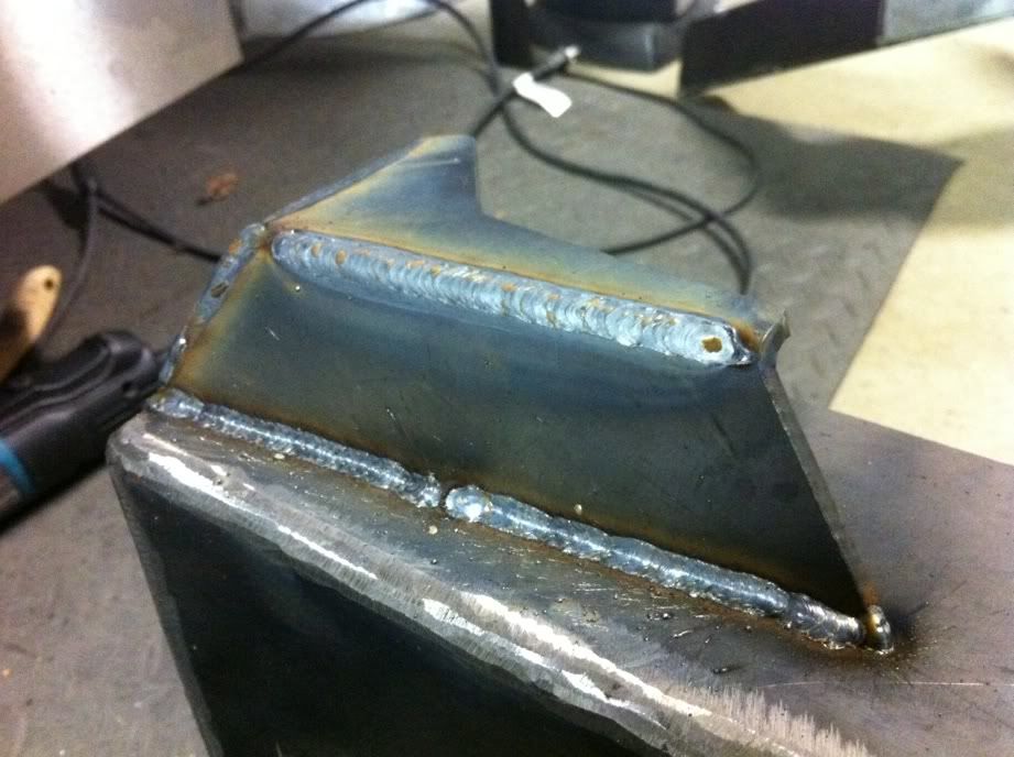

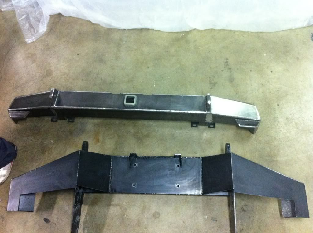

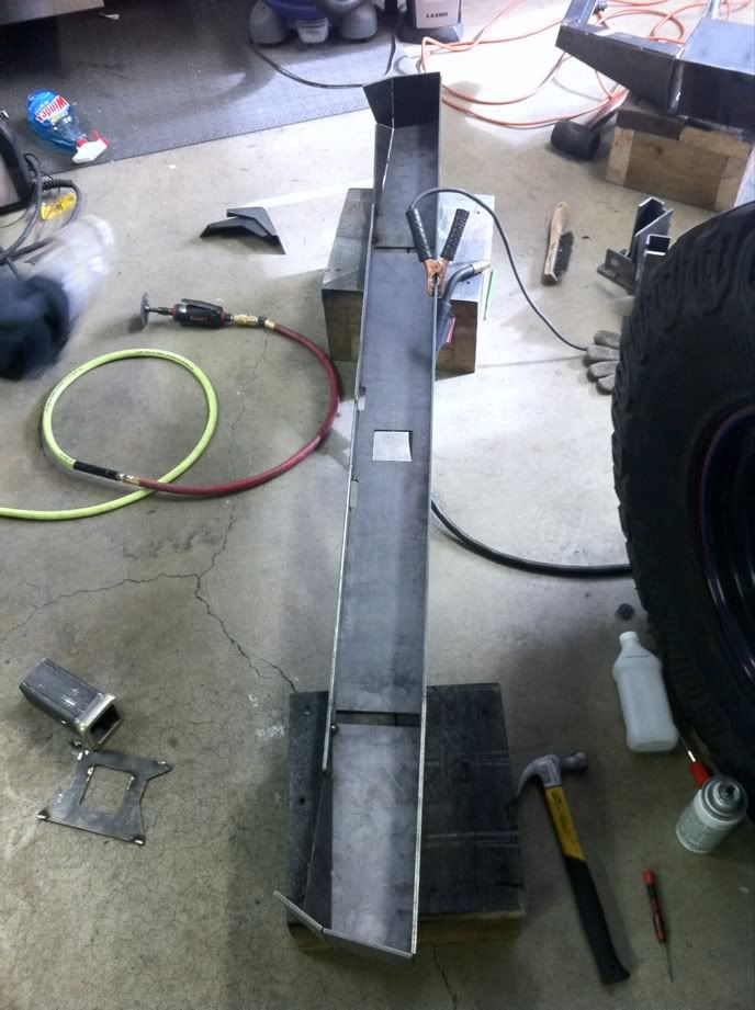

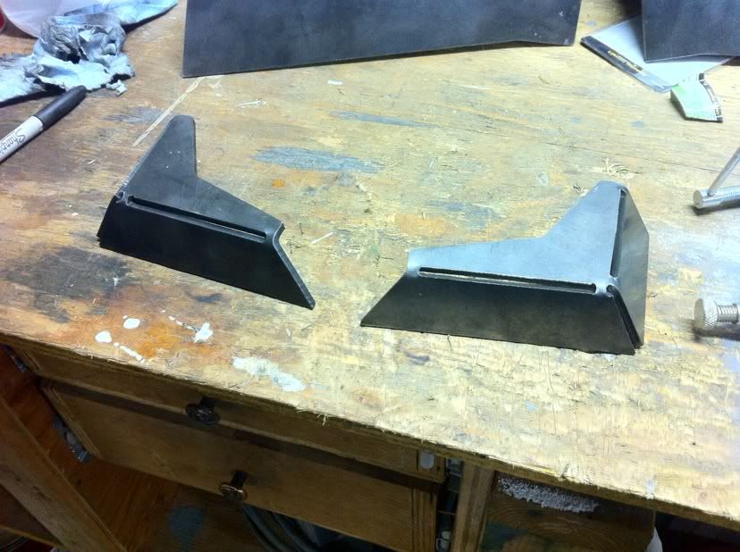

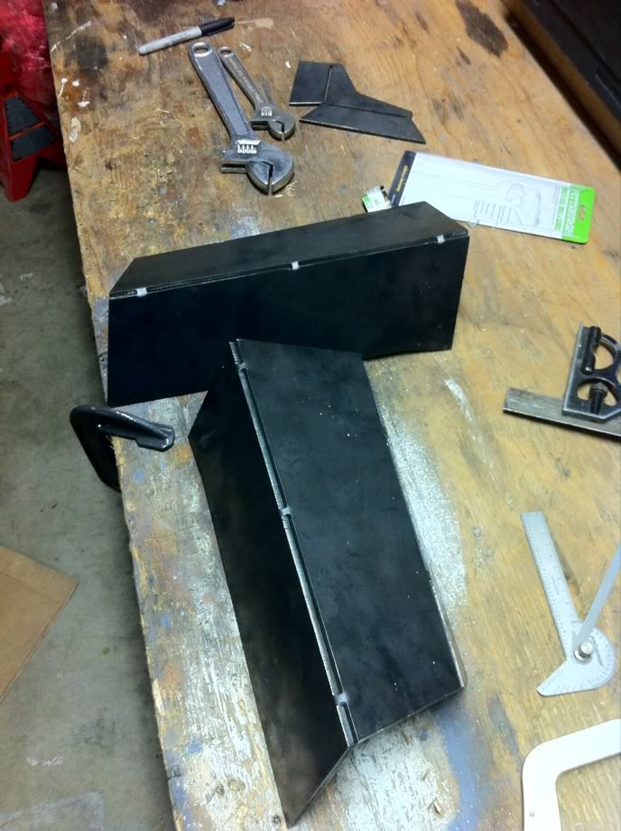

Well i made some really good progress on the JCR DIY rear bumper:
A few of the bent up pieces
Tacking it all together:
Welding it up:
So I'm just about done with the bumper. It needs some final grinding, but it came out really nice. JCR puts together a nice product. My plan is to use Al's Liner on my bumpers for some extra protection. It's cheap, and I've heard good things about it.

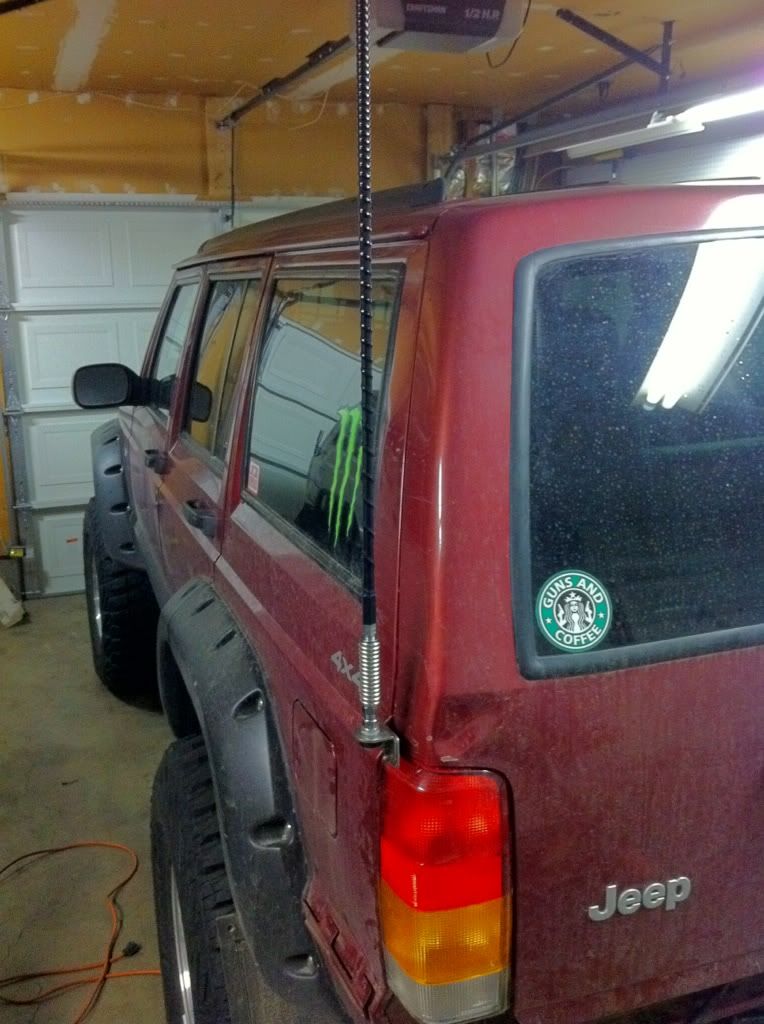

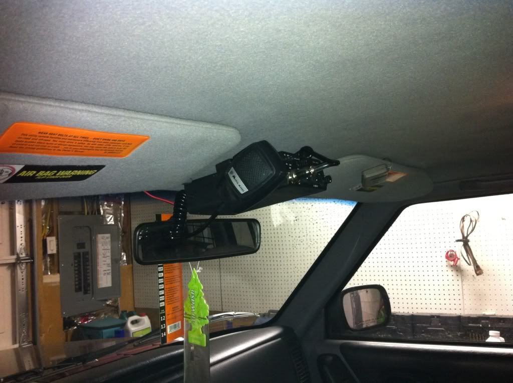

Tonight had a couple more things checked off the list. Mounted up the CB before i head out wheeling this weekend.

What mount did you use

I started making a mount out of metal, and was going to use the visor clip mounts to attach it. I wasn't happy with that since it sat too low and was in the way of the rearview mirror. The solution was to slide a piece of wood nearly the same width as the two visor clips behind the headliner, then to screw the CB mount into this piece. It sandwiches the headliner between the mount and wood, and since there's fasteners holding the headliner right in that area, it's actually pretty rigid.

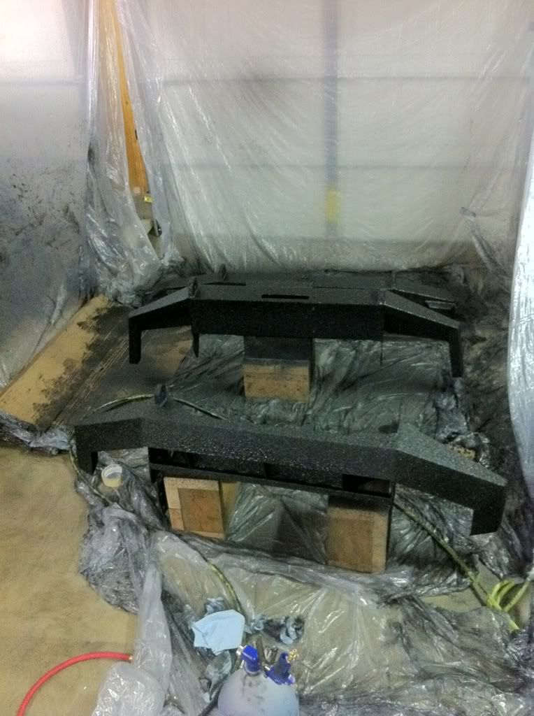

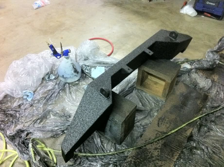

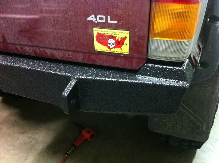

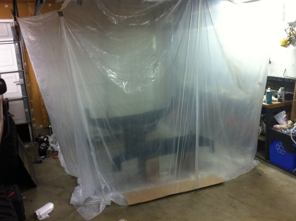

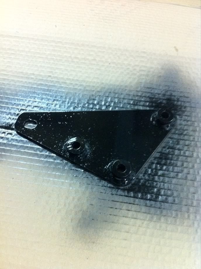

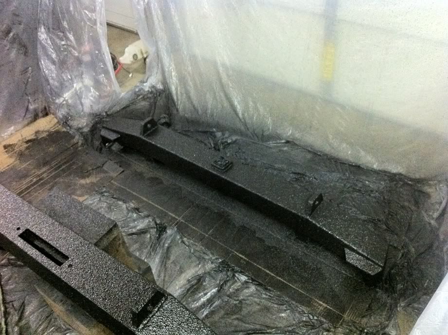

So setting up for Al's liner, read the instructions and felt pretty lost. There was no real callout for pressure, spray settings, setup conditions... Everything i researched and read said people had great success, so i figured it really could not be that complicated...But that was far from true.
Setup a booth for spraying... This whole experience was a total nightmare. The "primer" that comes with it was in a spray bottle, but it didn't mist, it basically shot in jets, so the primer was uneven and heavy. This also left everything unbelievably sticky, so the plastic stuck to our shoes and made the whole situation just crazy. The booth basically came down in no time between it sticking to the air hose, our shoes...everything, and the blasts of air through the gun. Then there was the fumes, the blasting overspray...wow, it was quite an event. Between it being 3am, feeling high as ****, and having what looks like a tornado that came through the garage, i can't decide if im pissed or what...It was a serious let down in overall madness and application, but here's the outcome:
This stuff tracked everywhere in the garage from our shoes, basically made our lives hell while trying to get it to cover the way we wanted it to. You can't tip the gun on it's side because it's not a sealed hopper which is a terrible design IMO. ... But i have to say between the fumes and the ridiculousness of the situation as we tromped around sticking to everying, i can't remember laughing so hard in my life. Some times you just have to laugh at such failure. I really hope that it holds up as well as they say it does...

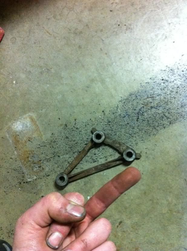

Got the steering brace from JCR installed , and the old POS one out. I was surprised to find it not crushed to bits like some peoples.

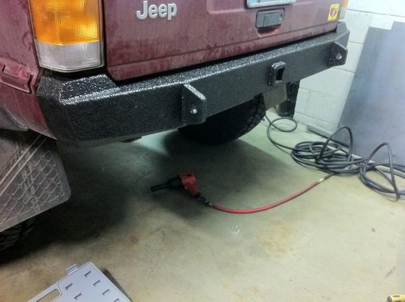

Also got my bumpers mounted. I'll get a few more pictures tomorrow :
