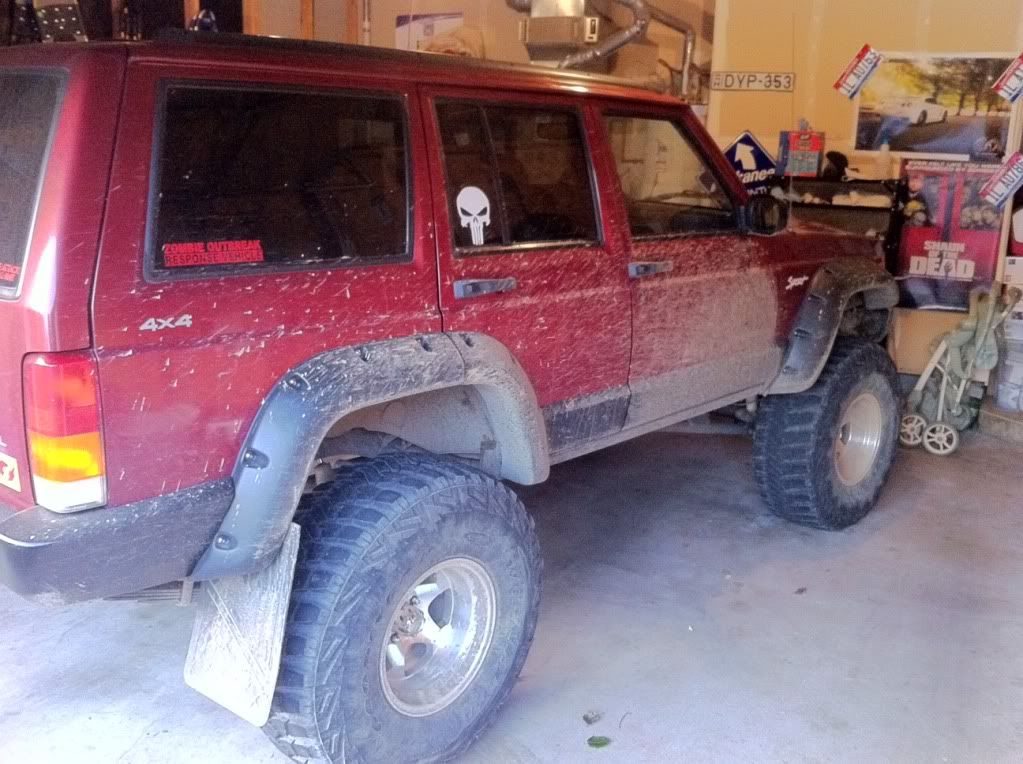

Poser pic:
It poured on friday, so i was really worried, but it was a great day to finally test out what the vehicle was capable of.

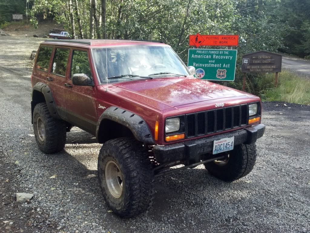

I wanted to start off on some of the easy trails, but we found that the easy trail we had picked out was closed...The trails were rated 1-3...We picked a 3 for the first run. This was the first time i've taken it out, but screw it!
I met up with a guy i met off Pirate4x4, Steve. He had a 71 FJ40 on 33's, a 305/700r4 and a rear locker. He really impressed me where he was able to go.
A decent flex pic
These trails were all restriced to 80" width vehicles. I BARELY made it through the gate (i'm 78" tire-tire), and i found out why they had the restriction

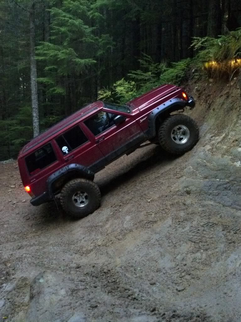

This hill was pretty fun, one could get nearly vertical on it
Hood popped for some extra cooling

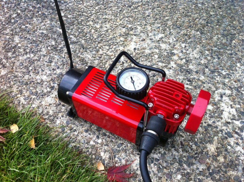

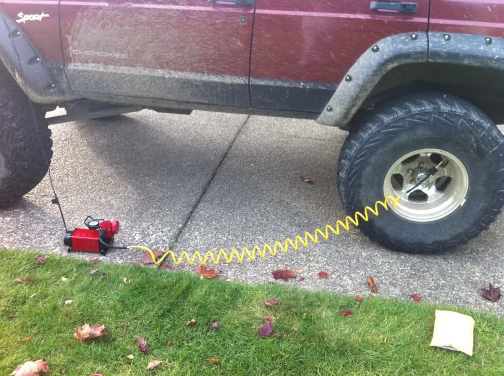

Was a busy week, but got a few things done this weekend...I really had a tough time deciding between going full OBA, or just get a small compressor that can do just my tires. I realized that OBA would be pretty cool, but i wasn't willing to give up my AC, and the other electric pump/tank setups are 4 times the price of doing just a compressor. Secondly, i won't really want to lug all my air tools with me on the trails. Yes it is convenient to have 1/2" impact, but a socket will do the same a little slower. So i bought this:
Q Industries MV50
http://www.amazon.com/gp/product/B000BM8RT8
It's got lots of mixed reviews, but i figured i could buy 4 for the price of one Viair unit in comparable output. It's worth trying out. I figured I could extend the life of it by not running the piss out of it too, which to me would be a huge factor to why people have problems with them. After filling 2 tires from 12-25psi (only about 2-3 minutes per tire), i gave it a break. It was pretty hot to the touch, but heat is the enemy on these pumps, so a few extra minutes doesn't mean a lot to me.

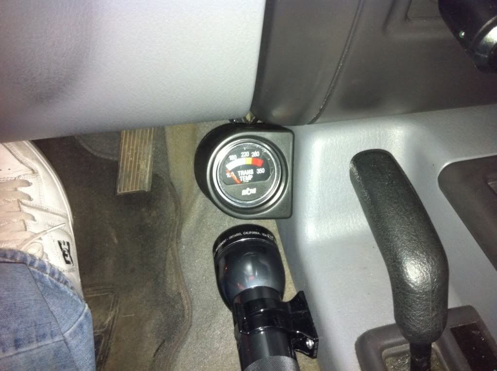

I also finally got a chance to install my B&M trans temp gauge. I installed the sensor on the return line. The reason i did this was so i could verify the effectivity of my transmission cooler.

Love the Shaun of the Dead pic...very fitting! Nice build man. I don't care how much you put into that build, you've given me some great ideas for the start of mine in the spring (dig the tie down brackets on the back box).

Originally Posted by GtiKyle View Post
Is that Casey Anthony holding an infant?
