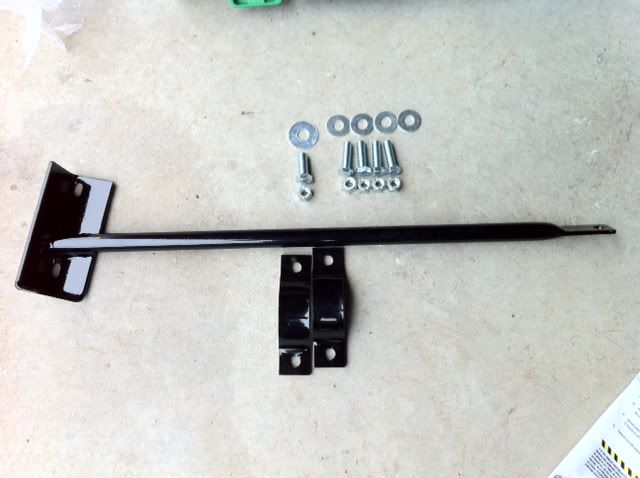

Got the Rusty's steering brace installed:
Does it live up to the cost of buying it?? I've been contemplating buying a brace, due to excessive slop in the steering.

It's late, so i didn't take it for a spin to check for any change in the steering feel. My steering has a weird slop in it. I'm thinking it could be the rubber in the steering coupler, as the rest of my steering is heim joints. While i doubt that this brace will help with that, it should help from the frame cracking in the usually places. My bumper design should plate the outside of the frame where the steering box bolts on, so that should further strengthen the steering weak areas.
