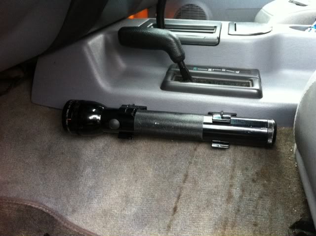

I got a chance to install my maglite mount.

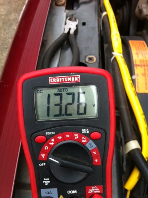

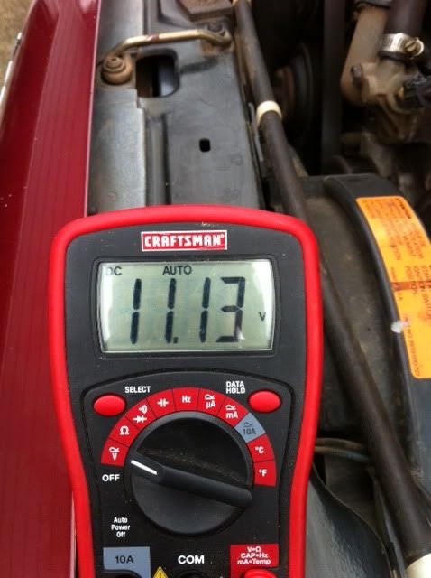

I also checked my voltage on the stock wiring harness to the lights, while the vehicle was running. Dismal.

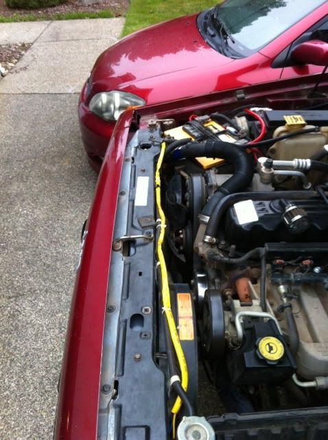

The install of the upgrade harness is super straight forward. I'm not stoked on the yellow, and didn't have a better way of hiding it that wouldn't take pulling half of the front end apart, so...i have yellow accents now.
A quick check after to confirm:
Much better!

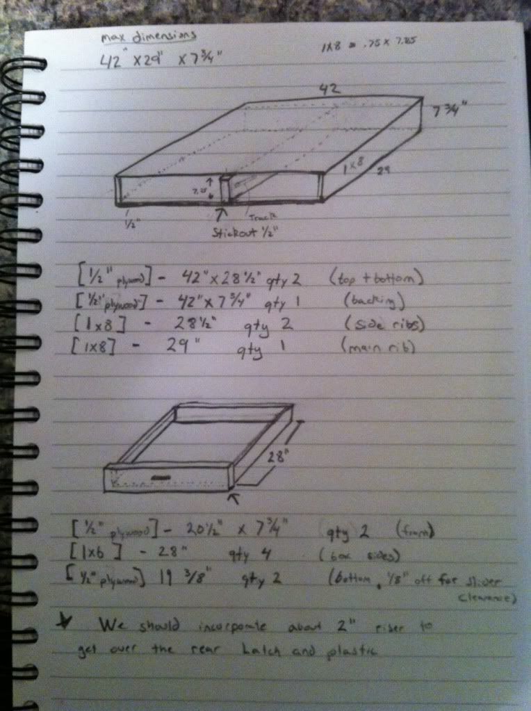

Just a quick preview on what's in store for next weekends project. This isn't the end product, as I'm thinking of a few revisions..but a basic drawer system in the back to hold all my tools/recovery equipment.

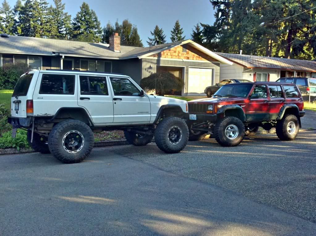

Helped my buddy pick up this cherokee yesterday. It's on 37's. Made mine look a little wimpy.
Ordered a few more parts...And have started thinking about a front bumper build, but after i get this rear cargo box constructed.
The tires were at 15psi when i bought the truck, and the steering felt a little loose on the highway. So i filled them to 24lbs and that didn't improve much. I don't think i have much slop in all my components since they are heim joints, but something feels...off. Perhaps it's the lack of sway bar? Could my box be moving around...there seems like there could be compliance somewhere. My friends jeep has the same sort of response. Maybe that's just how a lifted jeep feels. I've been used to driving fast cars with tight handling for awhile..... It's not terrible, but to get it to turn in you have to give the wheel a good amount of input before it goes. It can be a little dicey in traffic at 60mph.

I like the Maglite mount - I put mine more towards the left (closer to the dash) because I didn't know you could drill in right there next to the transfer case shifter! Did you just drill right into it? Wish I had done that, maybe I'll move mine and just ignore the old holes, haha

Yes, i just drilled right in. You can pull the plastic back on the bottom and stick your fingers up in there to see if there are things behind it. There was no interference so i just drilled in using the supplied hardware. It feels fairly solid, but I'll be aware of not to yank too hard on that when removing my maglite. :P

Believe me I know! Haha. Next time you're in your Cherokee, check the spot I mounted mine on...
It's very flimsy

Yah, i chose to mount closer to the drivers seat since the section area is not as wide as it is forward, as your is, giving it a bit more strength. We'll see how it holds up ...
