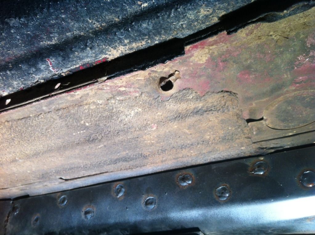

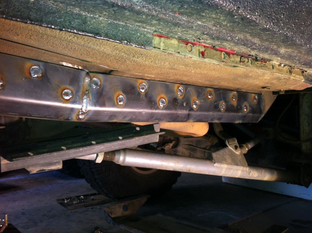

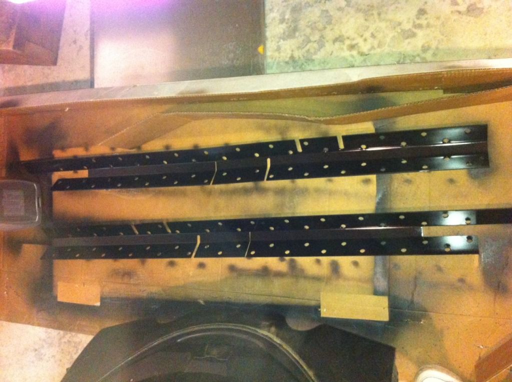

Alright so I finally got a couple of things done. I'm decided on doing slider/rocker guards out of 2x6. They will have stringer that tie into the frame. Also a tire carrier is in the works since it sucks always worrying about that. Both require a trip down to the metal supplier when we get our design all mapped out.

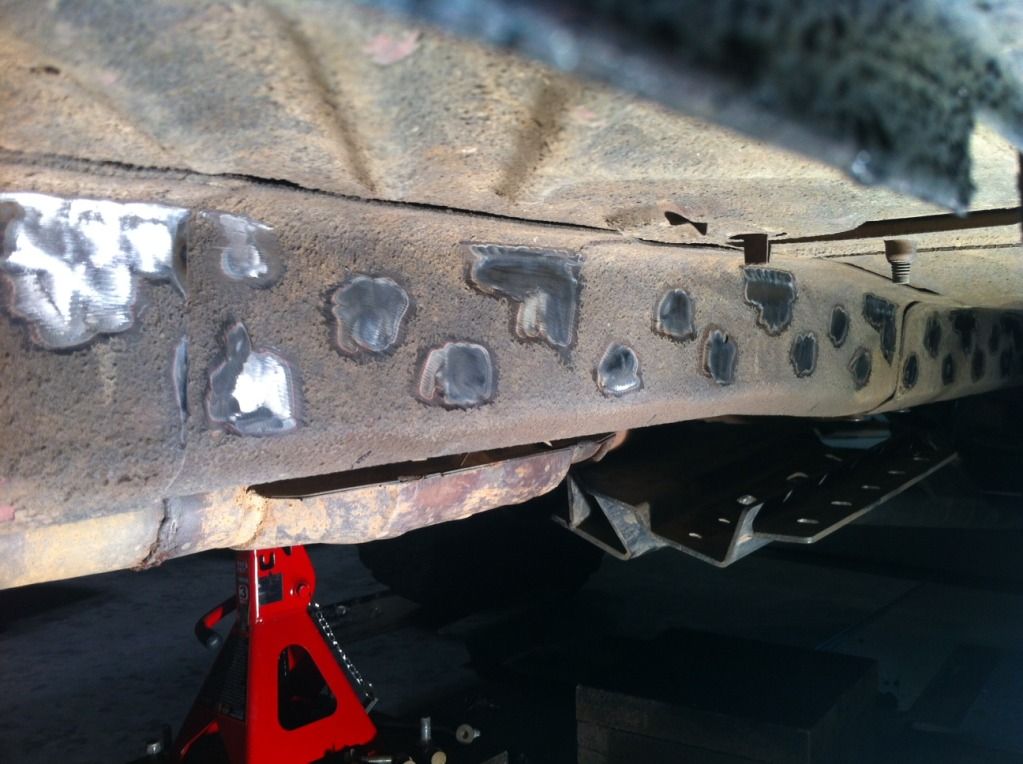

Well enough "will do", and let's show some progress. Ordered some frame stiffeners from HDOffroadengineering. Threw some paint on the backsides to prevent rust.
Cleaned off the areas of the frame that will get welded.
I got one side fully welded. I had to modify my transfer case skid, and will paint them when I get done welding my rocker reinforcements to them. Hoping to finish the other side on Sunday, then move onto tire carrier design.
I also scored some injectors this last weekend, and have rebuild kits on the way.

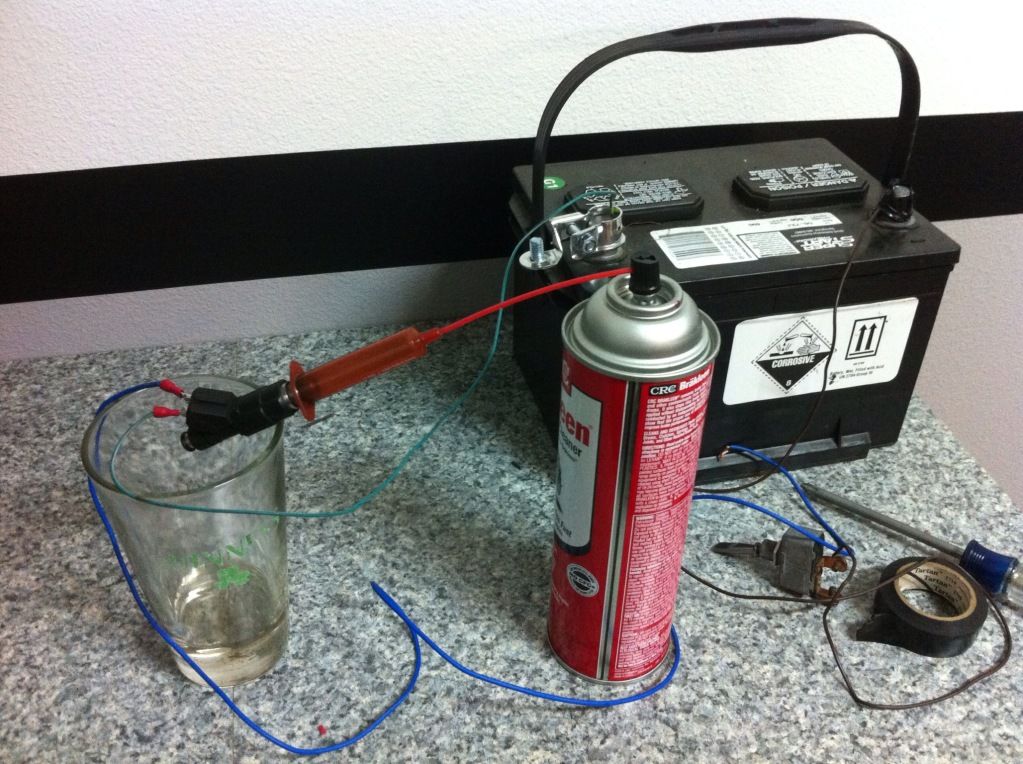

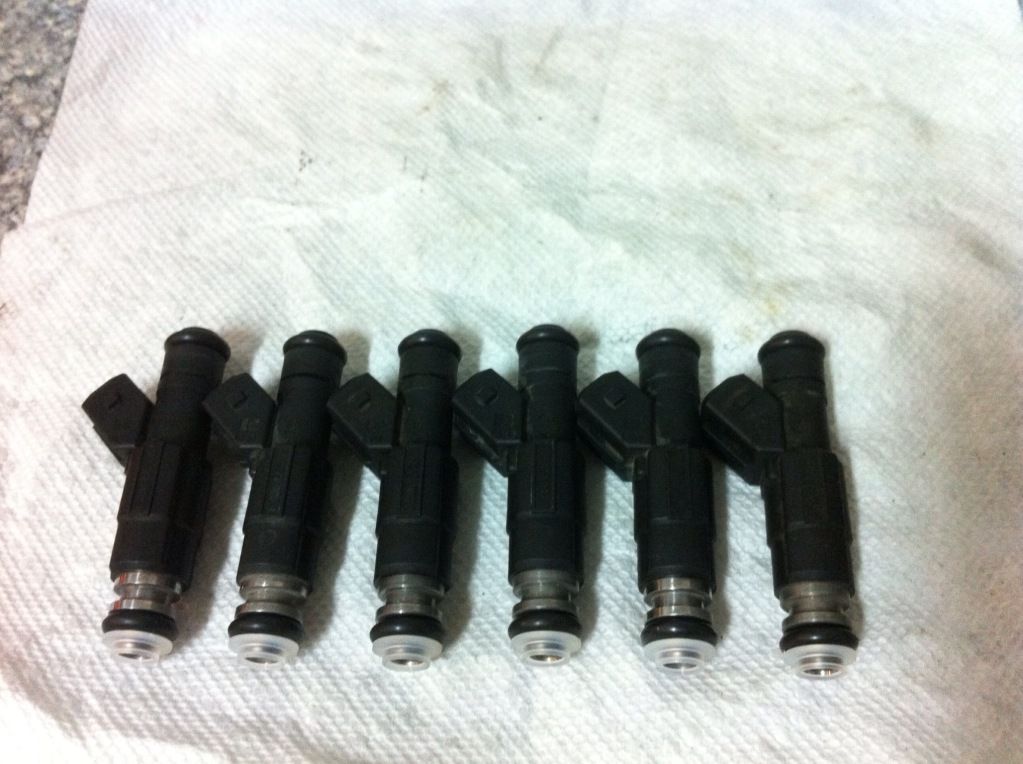

Rebuilt my 703 injectors, including new pintle caps, o-rings, and filter baskets. I also back and forward flushed them with brake cleaner.
My setup:
And fresh clean injectors waiting install:

Originally Posted by Newf0rm View Post
sweet! glad to see you're still at it, just read the whole thread. I was just asking a buddy of mine about a diy injector cleaning the other day.
looked on youtube and its just a bunch of crap videos. this looks feasible for me lol, you have a little write up by chance? i have 222k of crap in
my injectors lol
Thanks!
Yes, i was going to link in the info that i dug up for it, and i don't know why i forgot.
I took my notes from this :
http://www.youtube.com/embed/V2sD5UsOnJs
and this:
http://www.youtube.com/embed/7aT4S1lIBAY
Basically i pulled the injector filter and rings off, and gave it a quick shot with brake cleaner. I cut down an oring that fit perfectly into a syringe i modified, like shown. I always back flushed first, to ensure i wasn't forcing garbage through the tiny 4 holes in the injector. Then i forward flushed them. Reassemble. One thing that ISN'T mentioned in these videos is DO NOT leave the injector in the on position. It heats it up very quickly and is NOT how they are designed to operate. Pulse them at different intervals to avoid damaging them.
Pretty simple really.

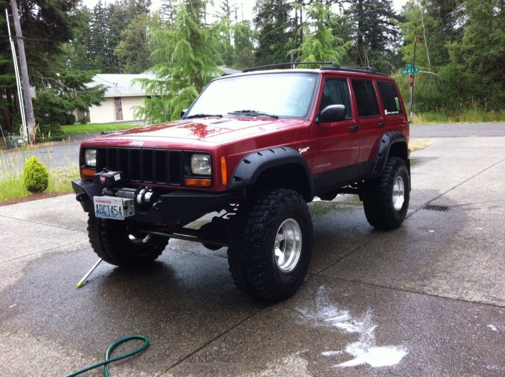

I realized its been a while since I've posted a somewhat recent pic of the jeep as a whole, although not much has changed. But this thread needs more pics.

"OH THANK YOU GOOD SIR!!!!!!"
That last pic is damn near Jeep Porn!

Finished my injectors, fired up and runs, no leaks. Hoping they help a bit in the mpg/drivability. Also finished my frame plating, and buttoned everything back together. So while working under there, I saw some evidence of this jeeps history. I love to think of the kind of "life" that vehicles go through; owners, where it's been, what it was used for... Every vehicle has an interesting life, and if they could talk, I'd love to hear the story behind this;

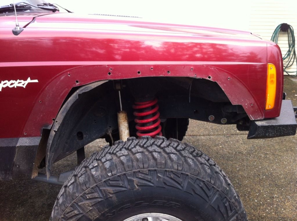

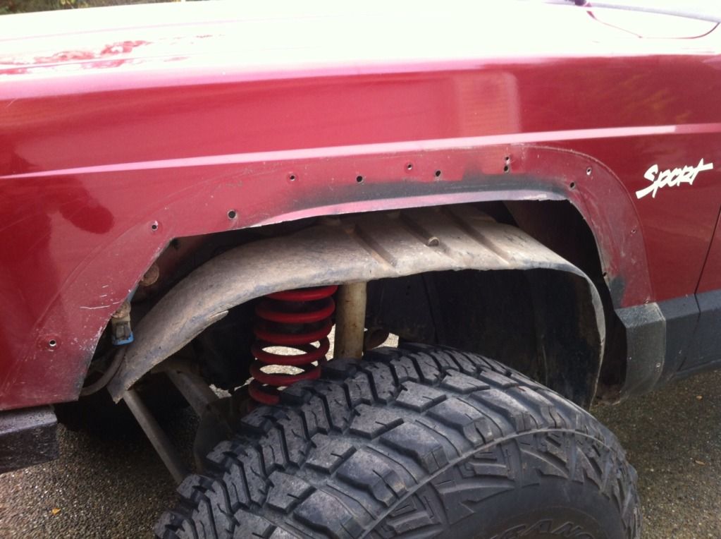

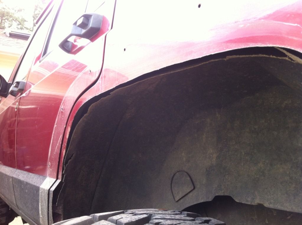

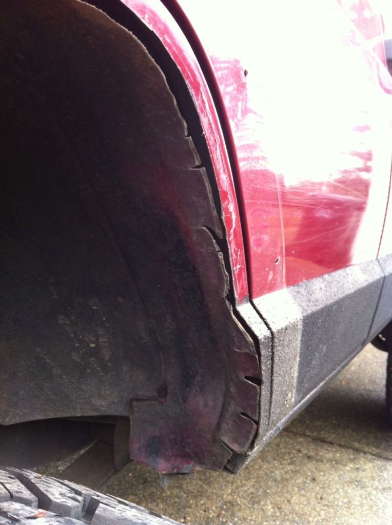

In preparation for my sliders, I decided to pull my flares off. They'll need to be modified to fit, plus I knew that the previous owner didn't do a great job of installing them. And by NOT great, I mean body work with with a chainsaw, after 10 beers
Someone didn't learn in 1st grade how to stay in the lines
Fender liner hanging
So I'm thinking the remedy for these is to recut them with a jigsaw, or die grinder to fix the horrid lines. I know it wont be visible when the flares are back on, but that's just **** work, and i can't stand that.
Where he cut through the inner fender pocket, I'm thinking of taking some 2" wide straps of sheet metal and patching that all up, so water/mud isn't making its was in there.
