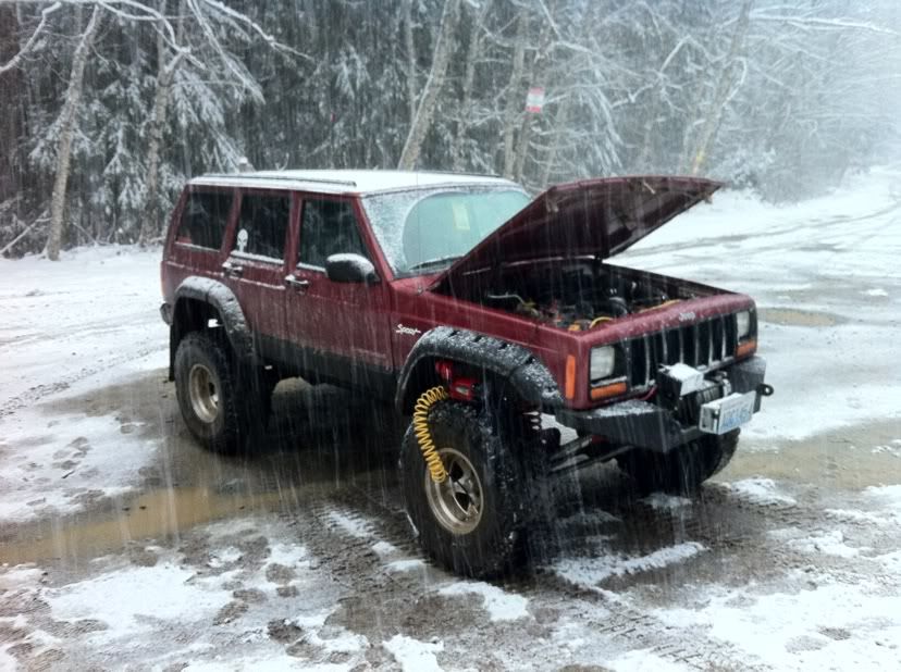

So sunday rolled around and we decided to hit up Elbe Hills. Preflight checks:
There was a good bit of snow up there, and i found out quickly how crappy MTR's at 24psi are in the snow are. I was sliding everywhere, and it was pretty sketch getting up to the top:
It was sort of embarrassing when we reached the snow park and there was a prius with chains on it that had made it up So we had to pull over and air down to avoid the Prius showing us up We had no idea where the trails were, since we left the trail map at home...Doh.

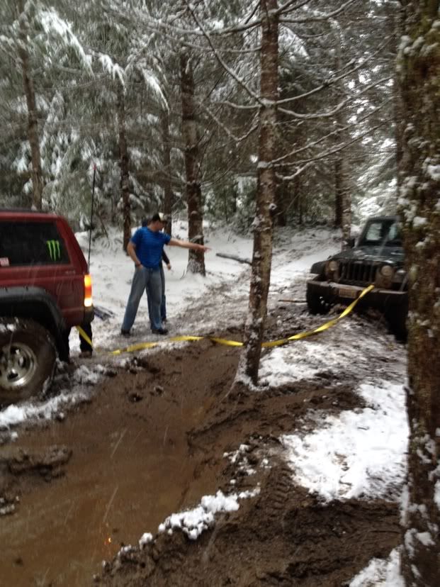

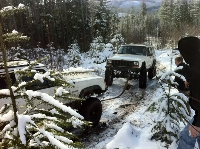

We ran into a small group running open diffs and 31's. They didn't last too long, so we yanked them and continued :

Notice the well prepared "wheeler" in the background with the abercrombie shirt and designer jeans. He asked me for EVERYTHING, tow strap, shovel, shackles.... Finally i ended up winching him out.

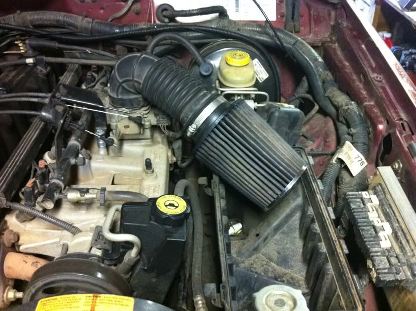

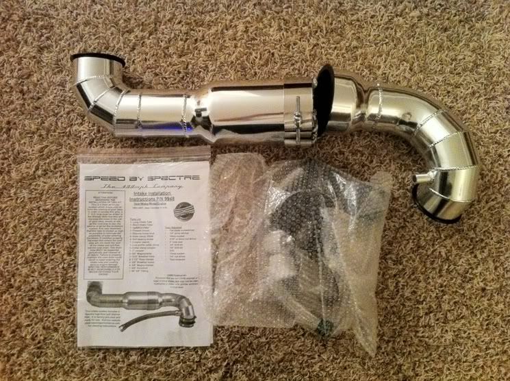

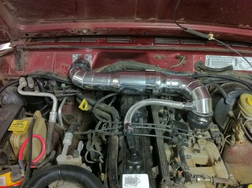

Alright, got the Spectre intake installed. Obviously a very straight forward project.

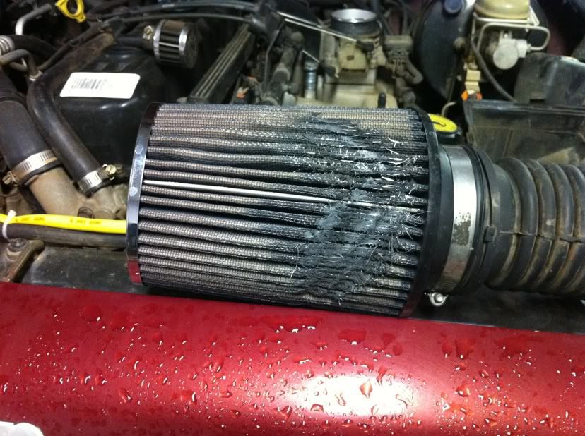

Take a look at what the prior owner did (the main motivation to upgrade this)
It's just a K&N filter strapped onto the floppy dick thing. Pretty lame, they even just left half the lower portion of the stock airbox. But the big fail was how they supported it:
Or rather DIDN'T support it. So the filter was just resting on the box. Pretty awesome.
And now:
The HDR pic makes it a little less shiney looking, but it does have some pop to it. Not normally my thing, but it's under the hood, so i really don't care. It whistles a bit at anything above 15% throttle, but under light load cruise, it makes no noticable difference in noise. 50-100% throttle this thing sounds like a train. It's loud. But just crank the music and you don't hardly notice A pretty straight forward install, a decent product. I recommend it to anyone not afraid to cut up their firewall

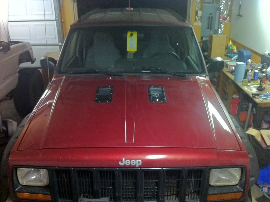

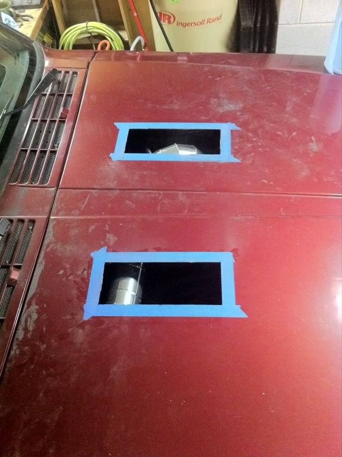

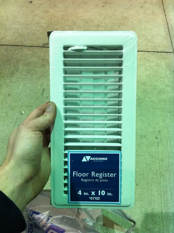

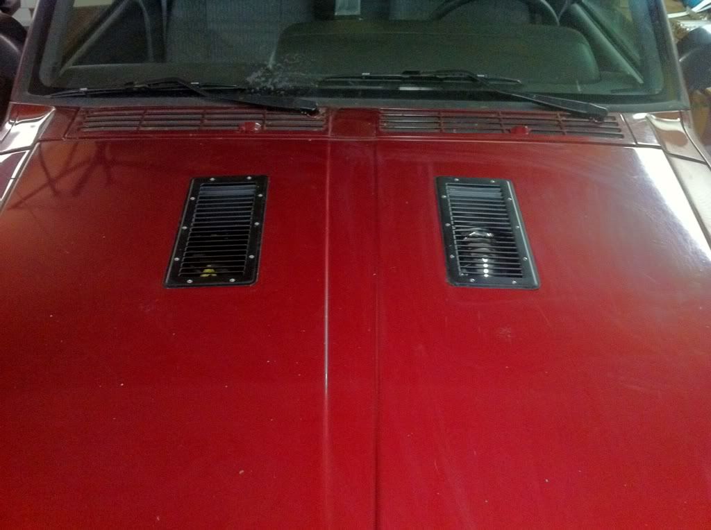

Another simple mod tonight. This beats the hell out of paying for those companies hoodvents, or trying to find a set of the Lebaron ones everyone seems to covet.
I started by cutting the bottom section off the heat registers. (no pics, sorry). I left a 1/8" lip on the underside to help keep it in position for later fixing it down. Then i cut out some cardboard templates of the size, and positioned them on the hood. After a couple measurements to ensure they were even, an outline with the sharpie. Some blue painters tape and a die grinder did the rest.
Peekaboo .. You can see my intake hiding in there.
A touch of black paint, and some 1/8" rivets did the trick.
For about $20 in materials, it was definitely worth doing.

Say, what is the part number on that intake? ME WANT...and not because it is shiny, but because it is awesome! Love the snow trail shots...would love to explore around there one day, LOVE Washington State.
Nice hood vents too!!
