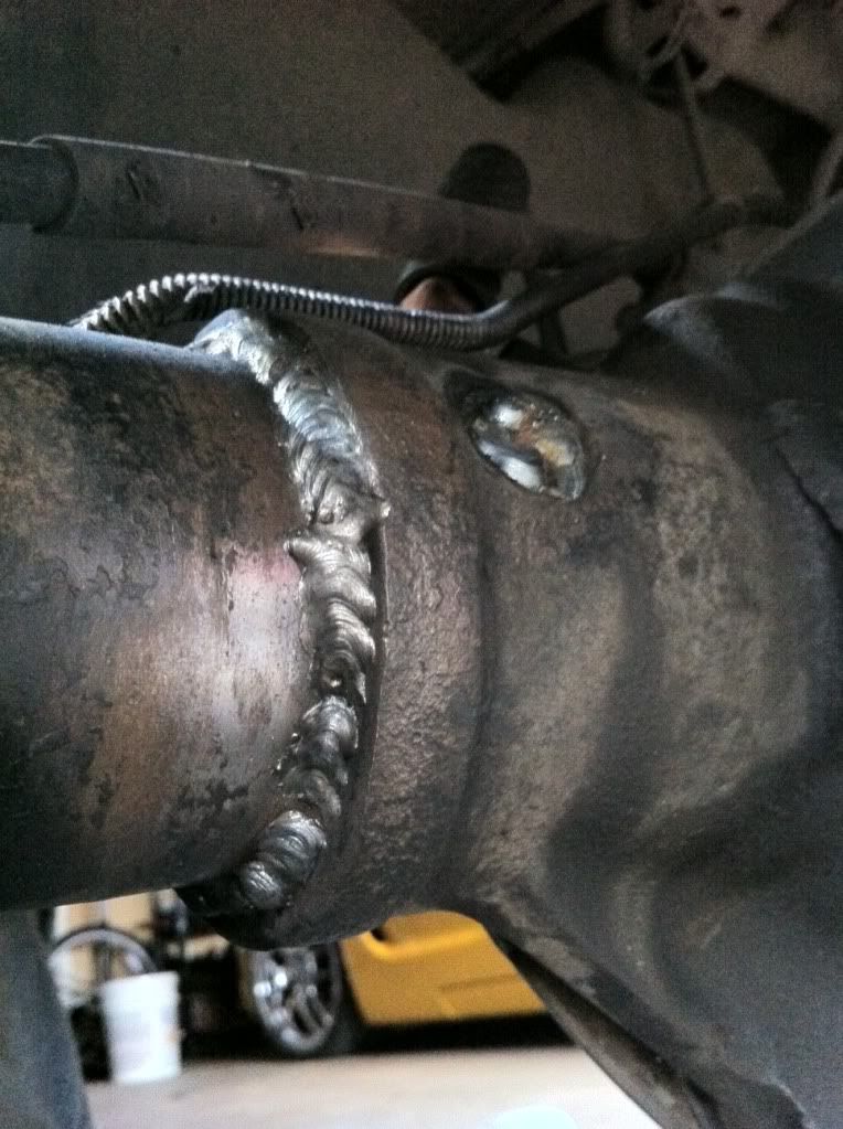

Next issue I'll be battling is the rear end leaking. It's leaking around the axletube - differential housing. The previous owner played dumb on this, but you can tell it was either wheeled really hard, or someone didn't know how to drive a locker on the street.
You'll notice the plug welds are missing:
After some digging, it looks like the tube spun, and busted it's plugs loose. I found someone else had the same issue that I did :
http://www.jeepforum.com/forum/f11/s...-tube-1087701/
I plan on working on it after work today. My plan is to loosen up the Ubolts, attach a pipe wrench to the axle tube, and heat the differential with a torch. When it's nice and warm, ill beat the hell out of the wrench, hopefully getting things back in line. Then clean the area and weld both the plugs and axle tube to housing.

Well i got the rear end all patched up. It didn't look like it had shifted too much, but the main issue was the leak. I think i got it take care of...Please excuse my crap welds, I'm no pro, and it's tight under that jeep.

Nice work, welds look decent. The center section is cast so it works well if you heat it up with a torch to get better heat penetration on your welds.
