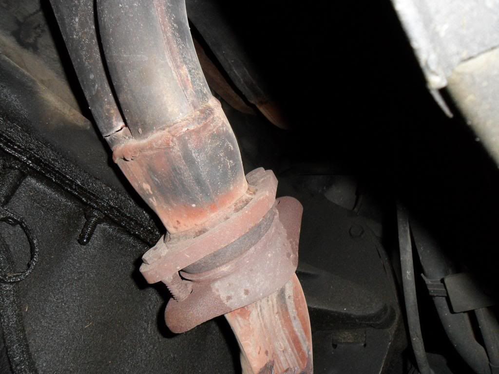

I then decided to try and replace the cracked exhaust manifold that I had seen when I was doing the lift.
Tried to replace it with and APN header but couldn’t get it to seat correctly without modifying the header more then I was comfortable.

The APN manifold seemed really well built just couldn’t get it to install right. So I bought the one with expansion joints in it and installed it and had no problems. To make sure I don’t have another problem with the exhaust manifold I replaced the worn out motor mounts with some heavy duty mounts from Iron Man 4x4. Has a little more vibration then before but there is a noticeable amount of power gain.
