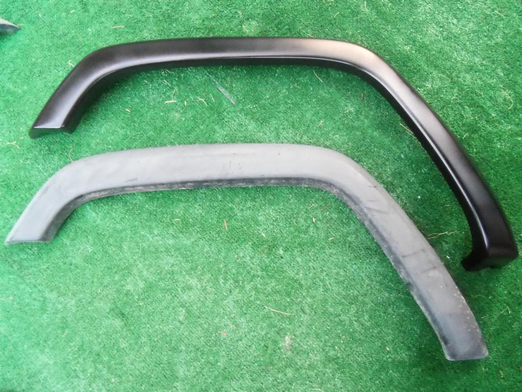

I'll tell you what works but nobody ever believes me. Armor-All, a detail brush, and being willing to put in the effort. It may take you an hour per flare. Spray it on, use the tips of the bristles to work the dirt and everything else loose, then wipe (scrub). Repeat. It works, my flares look like brand new and everyone asks how I did it. But as I said, nobody believes it.
