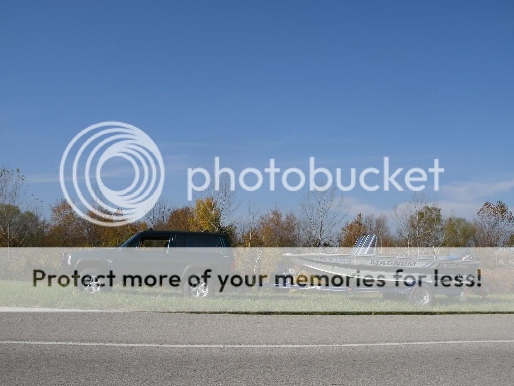

Mine does fine by me with 4" lift and 31s on stock 3.55 gears pulling a 16' aluminum deep-V .
I do use trailer brakes and most of time drive like I've got some sense about me.
