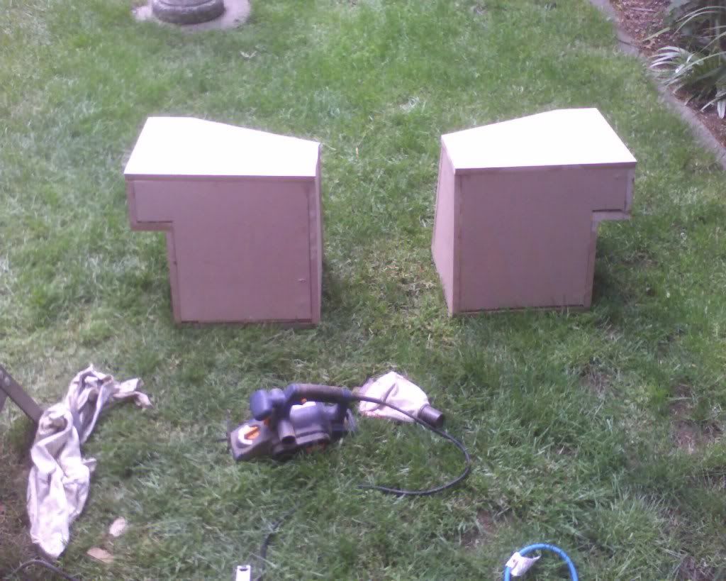

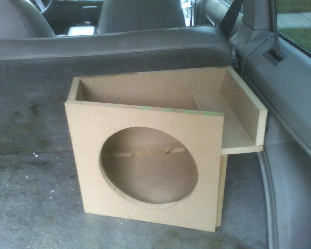

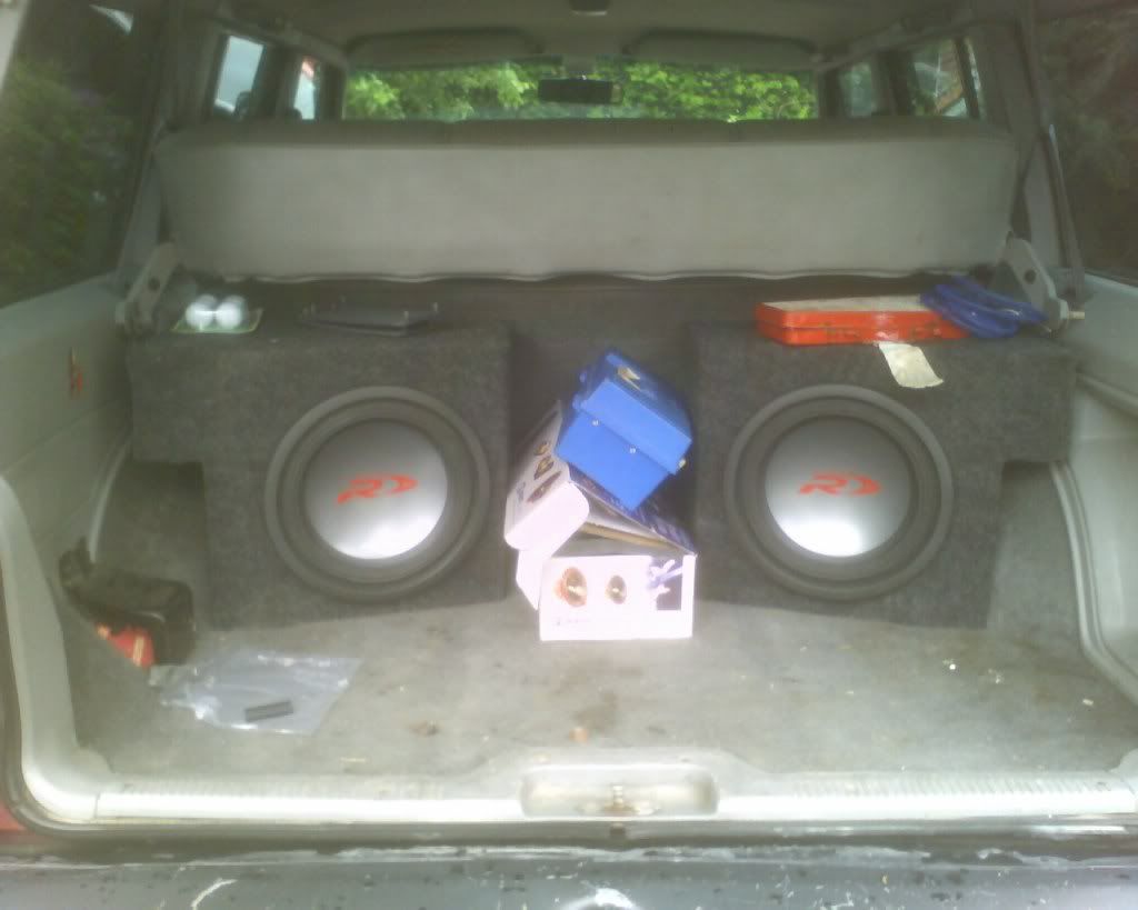

I built some custom sub boxes that contour to the back of the rear seats and extend over the wheel wells for greatest possible volume. They sound sweet, and they dont move around at all because of the design.

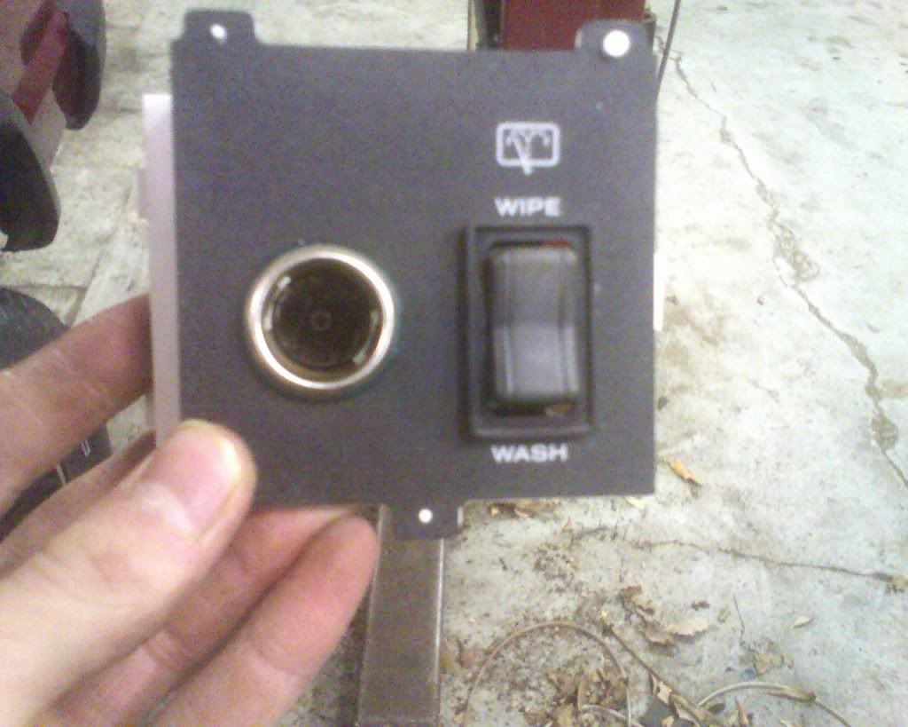

I started by moving the stock cigarette lighter
then the radio and heater control

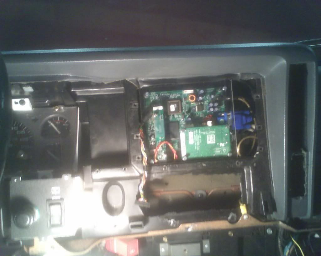

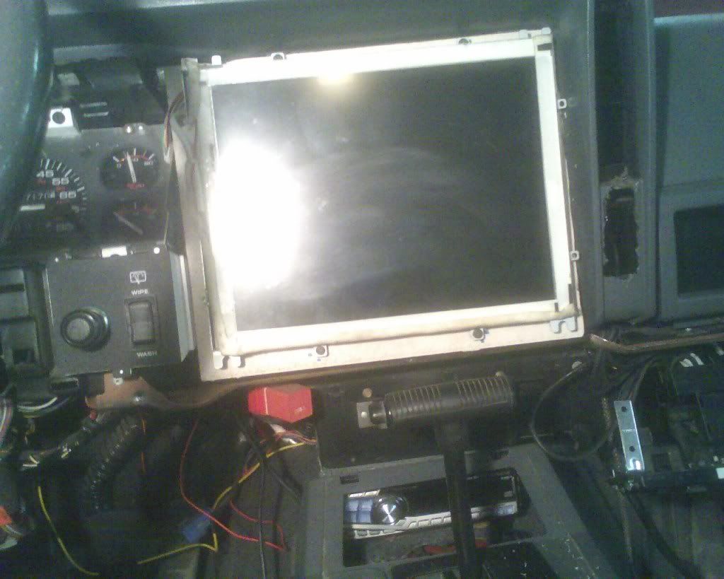

after that in bought a touch screen and separated the circuit boards from it and mounted them on plexi. it was then installed behind where the stock radio would go.
and finally I put a big a$$ 15inch touch screen in
then I cleaned it up dressed the wires and made it look nice with a new bezel. unfortunately I do not have any finished pictures. the touch screen ran off a laptop that was mounted along side the passenger seat and it would control music, video, and GPS.

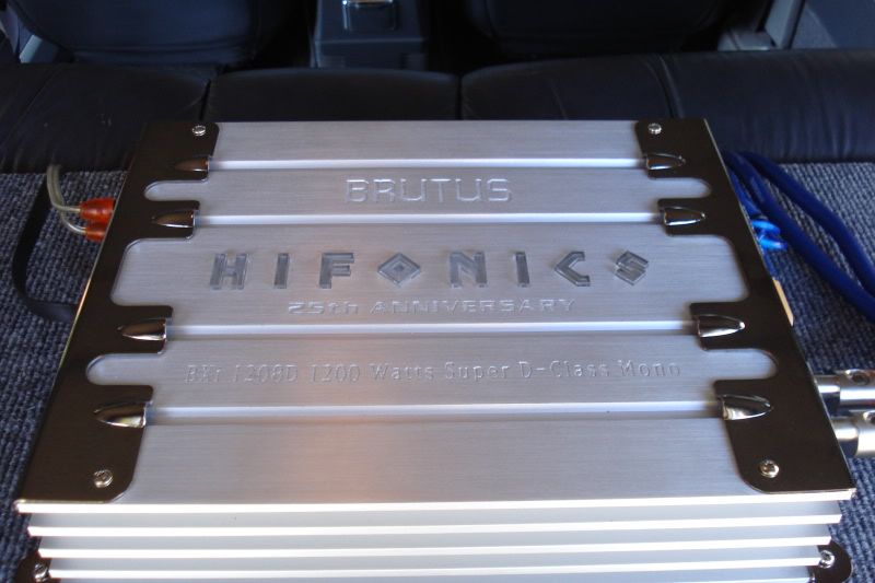

HiFonics amp running the subs:

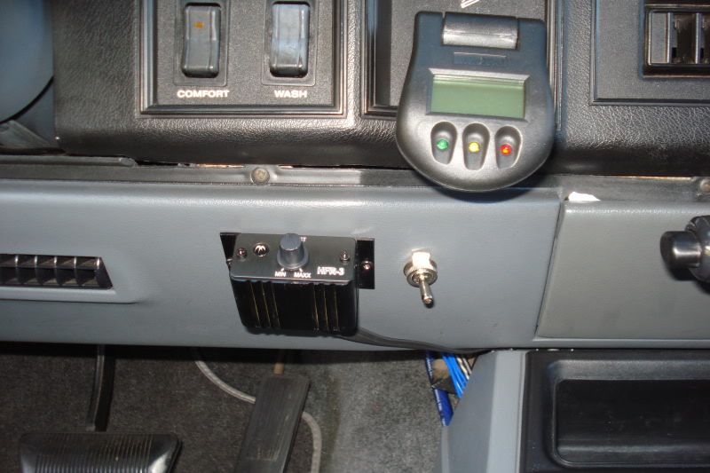

Voltage meter in the cig liter, Gain knob, and amp cut-off switch:

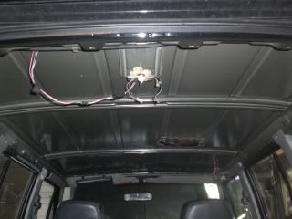

No headliner

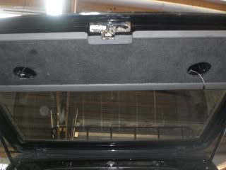

beat to heck hatch panel full of random screws, with no speakers
painted hatch panel with speakers!

i dont the heat controls/ and what can you do with that monitor?

I mounted the heater controls under the glove box...you can just barely see the corner of it in the last picture. I used two L brackets and screwed it into the steal under the dash.
The monitor was a fully functioning computer, it was connected to a laptop mounted on the side of the passenger seat. It played dvds, music (through windows media player), ran a copy of microsofts streets and trips with GPS, and also surfed the internet.

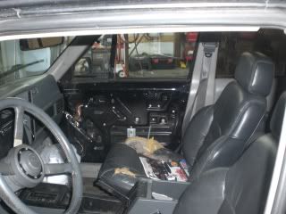

I am currently attempting to swap the full interior (including the dash, center console, headliner, seats and carpet) of a 99 cherokee into my 92. Has anyone tried this before? if so any advice?

no experience there personally, but i've "heard" someone has attempted to do it, and was a royal PITA, due to the fact just about every single thing is different, from the hvac ducting, to all the wirning harnesses, to the wires for the contollers, heat/ac on yours is controlled thorough a cable, where as the newer ones is electronic valve, your speedometer is cable, newer one is speed density( i believe) that and the fact that you can't just swap the dash plastics, cuz none of the stuff bolts up to one another, and on top of all that, the newer dashes stick OUT more, leaving you just a TAD less comfort room. Then you're left with all the wiring to rework for wipers, ecm, pcm, and windows, and mirrors.
I could be wrong, but that's what i've heard.
good work on the screen though. are you gonna make a custom cover to go over everything?? and if that's the case, then you don't really need the radio then, right??

fuel cut off switch I like that.
that is what Ill call it.
the PO couldnt get the fuel pump working without running a hot wire driectly to it. and there is a switch on the dash for it.
