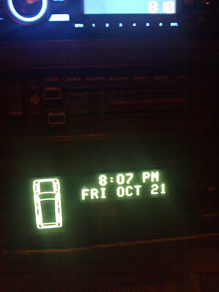

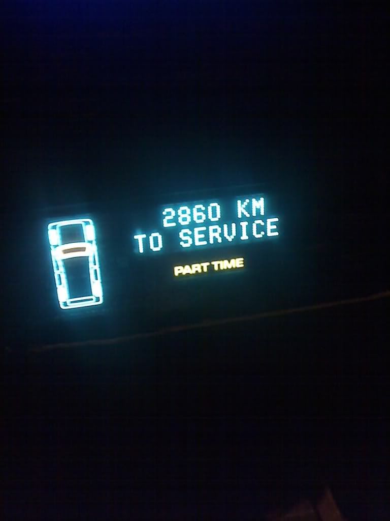

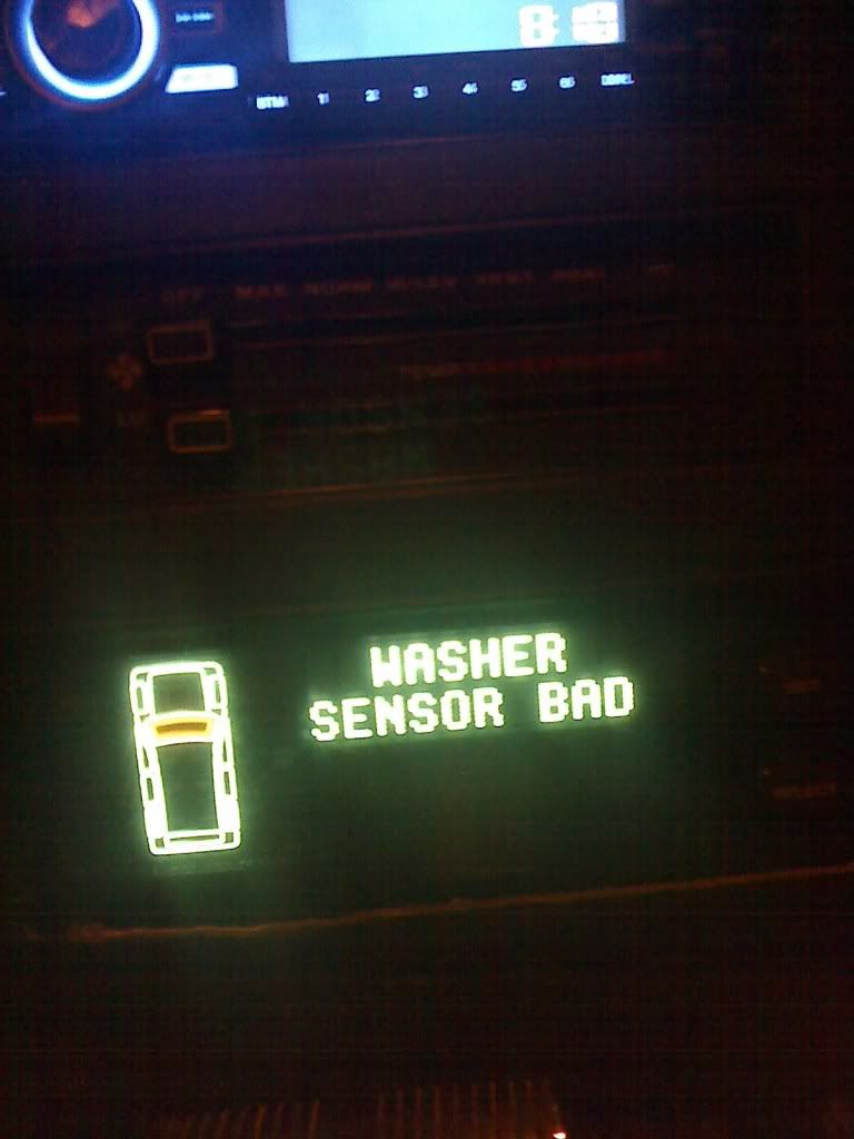

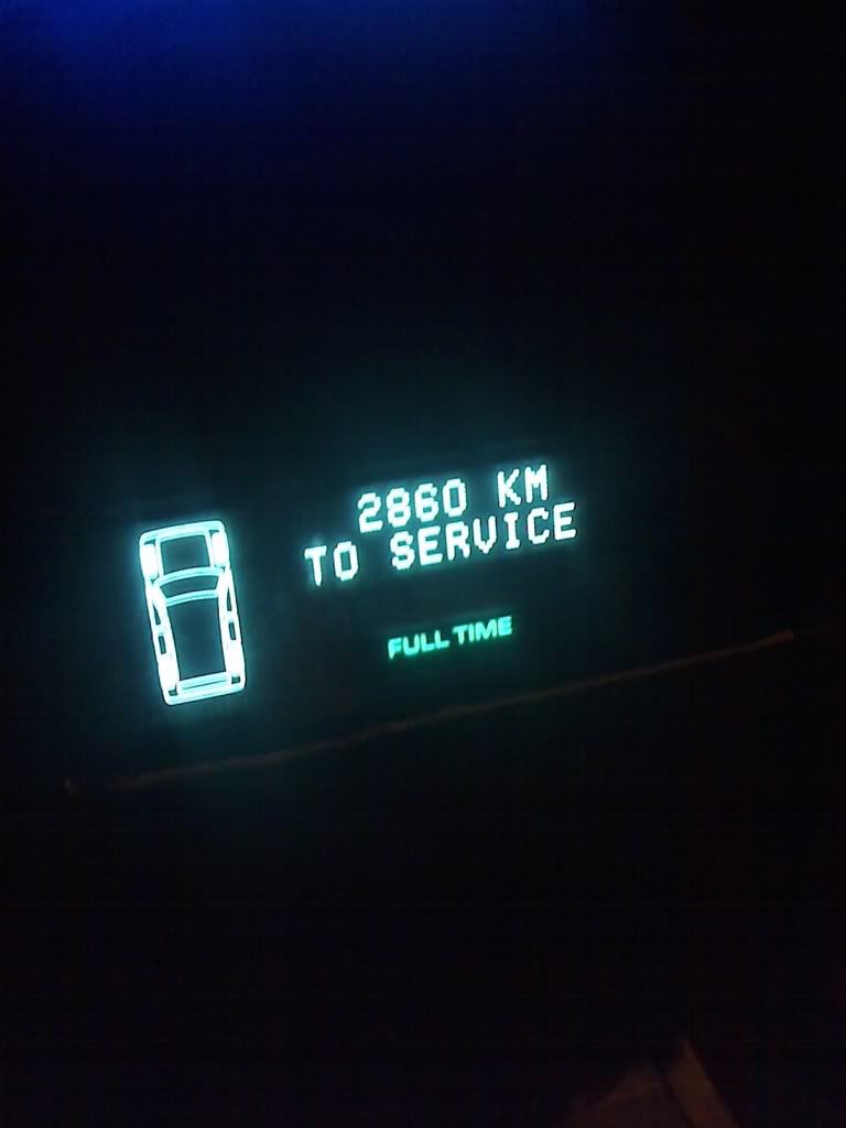

why, of course, I just had to get em off the other computer (these are cell phone pics, but I will take some better ones for ya guys
Here's It When I First Turned It on,
When I Hadn't figured out the washer sensor wiring,
In Part Time 4wd:
In Full Time 4wd:

This is beautiful, how did you get this to work! I have the dash lights for the part time on my 231 but neither of them EVER turn on and I can't find a sensor on the Tcase or anything to determine whether its in 4wd or not. How does the Jeep know?
And for the coolant sensor, how did you go about mounting that?

I have access to wiring diagrams for jeeps from '99 and older (computerized database :P) everything pretty much hooks right up with the exception of some sensors, and such. As for the coolant sensor, getting a ZJ coolant overflow bottle, or attaching the sensor will work. I didn't know about the blinker warning either until i was looking at the pinout and said what the he** i didn't know that! as for fitting in, it actually fits pretty well, it's just more a matter of me & mr. Hacksaw getting rid of extra plastic, and just Pushing it into place! tight fit, don't even need screws. The bezel needs the hole enlarged a bit, but other than that it fits well, and looks good!
I have a much better digicam I will get you some nice pictures of it.
as for those lights, check on your front axle, there is a switch mounted beside the "shift motor" only the 242 has the wires on the TC because the 231 doesn't have full time it does not need it, but check the switch on the front axle disconnect (if you have it), and keep in mind that the wire gets grounded when the jeep is in 4x4 mode so it might even be a bulb!

Here's a decent shot of it, the wire got knocked off for the washer fluid sensor when I was trying to neaten up wires under the dash, now i have to find it lol:
