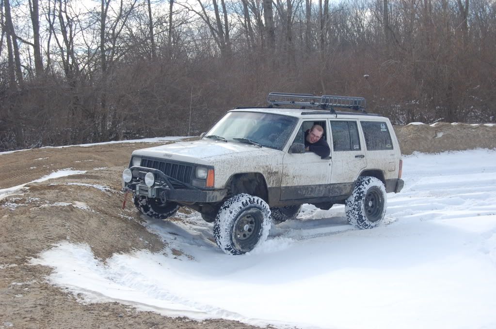

in my opinion i go rough country it is inexpensive and the customer service is great from what i heard and read. they had bad parts in the past but mostly got those parts re designed. I am planning on ordering from rough country and iro when i go up to 4.5" of lift. I am currently lifted 2-3" of lift the front is measured out at 2.5" and the leafsprings in the rear measured out 3". I run 31x10.50 r15 tire size it is perfect combination for weekend wheeling and daily driving it isnt that bad in gas mileage either. check out my build thread for pics. i hope i was able to help you out man.
here is some pictures of my set up
4.5" Rough Country x series lift kit/ lifted xj 31x10.50 15x8 4"backspacing cragar rims/ trimmed front rear fenders/custom swaybar quick disconnects/custom winch bumper w/ warn winch/custom roof rack/ lights mounted.
my build thread http://www.jeepforum.com/forum/f22/my-jeep-build-xj-1156115/index3.html

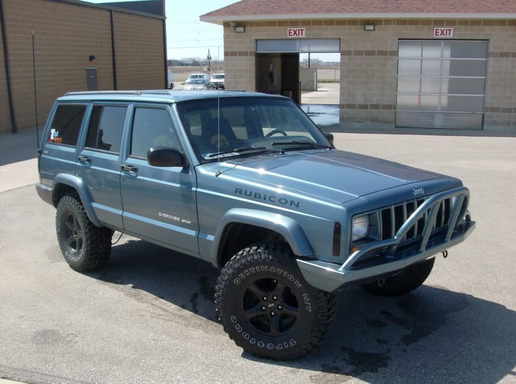

If mall crawling is your wish, my first setup i ran on my 01 may suit you well:
Fat Bobs 3" poly coil spacer, add-a-leaf, and stock shocks. Dirt cheap, and minimal parts to purchase. Rode like stock, and made for a nice look. When I started to wheel it wasnt enough for my wheel/tire combo, and my leafs began to fatigue. But for about 100 bucks plus cost of wheels and tires, excellent setup for mall creeping. 15x8 D-Windows with 4.5" backspacing, 31" Trxus MT's.
Funny looking back on this now, cause this was a tough looking setup to me when I first did it, but that 01 is tiny compared to my current build. One day I will probably look back on my 99 in its current state and say the same haha.

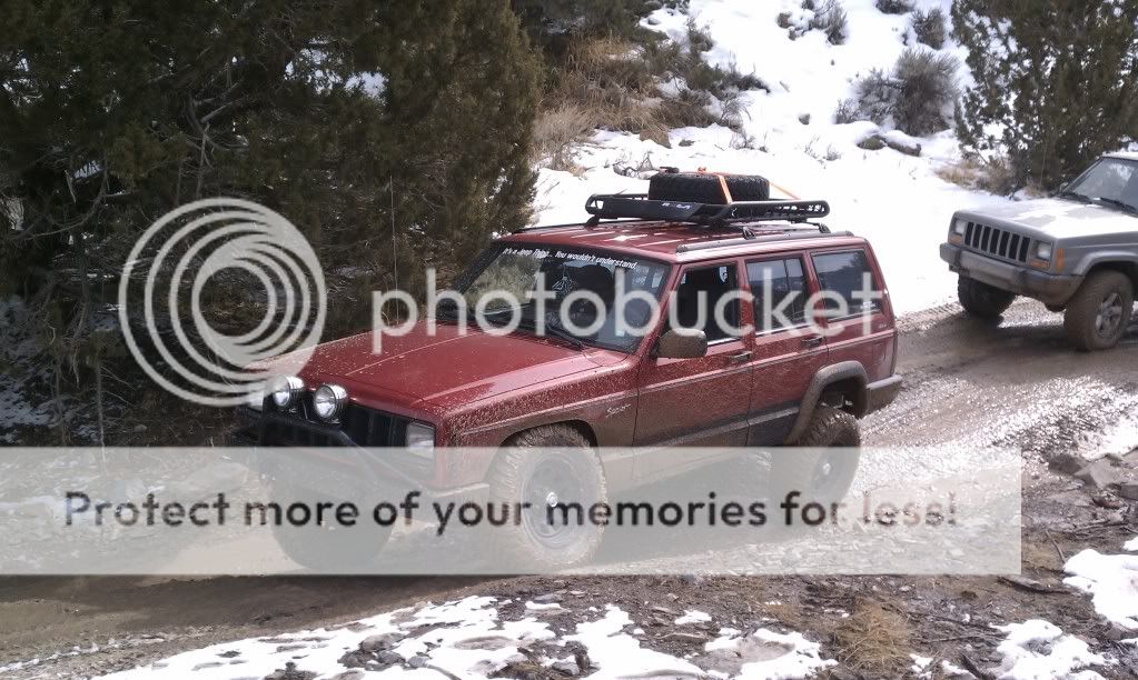

fabobsgarage.com is where i got my lift 2" front spacers w/ 2 "rear shackles. hd rear leaf springs, mastercraft curousrs a/t 2 30/9.5/15. its my DD and i love it still going to do some trimming and a few other mod but nothing crazy. it goes through the trails good. the lift was $79 tires i got for $120 each, and the rear springs were little over $100 each

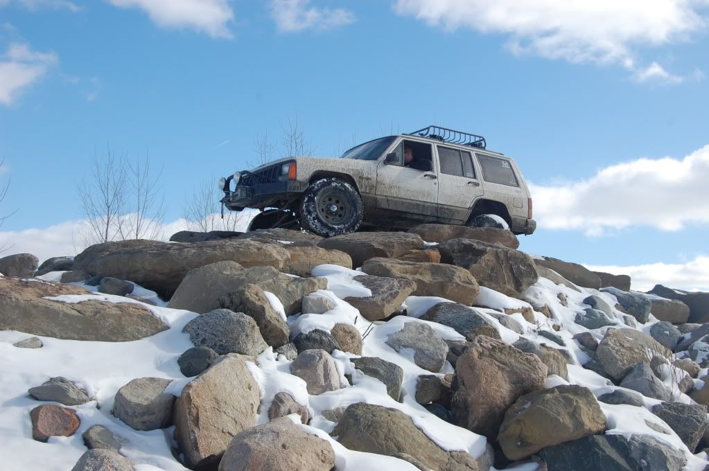

for hd springs go to oconee offroad. it was alot cheaper than quadratech for me. here's my bb on 30" tires.
